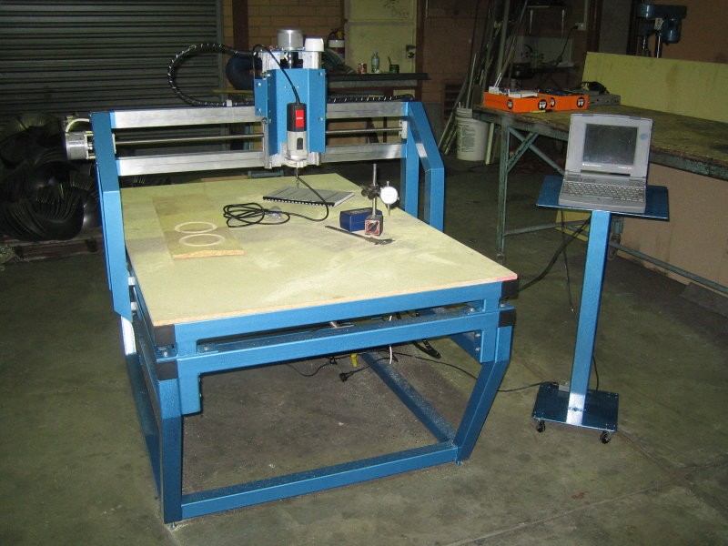

Here is a Joe’s CNC Router, which is largely made from wood…

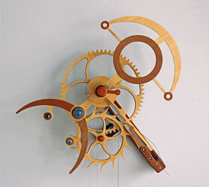

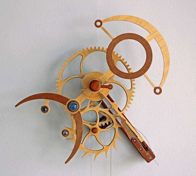

Wood geared clocks make beautiful CNC projects

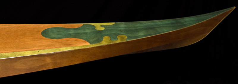

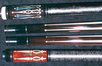

Pool cues can be inlaid with a CNC Router 4th Axis capability...

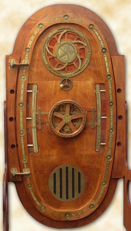

Nautilus door's iris mechanism is brass…
I’ve shown some fairly elaborate projects here to give a sense of the tremendous potential having your own CNC Machine can bring. Much simpler projects are also easy to do. Here’s a racing sign made of inlaid Corian on a Joe’s CNC Router:
To me that’s amazing work done on a relatively modest machine.

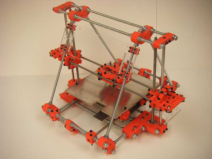

In all likelihood, the simplest and most inexpensive machine to get started with is a 3D Printer. They may look like tinker toy creations, but they’re capable of surprisingly sophisticated work. We did a multi-part series that gives a great introduction to 3D printing that will tell you a lot about them. We also did a complete series on building a Rostock Max v2.
3D Printers do what’s called Additive Machining, because they add material rather than cutting it away. There are some distinct advantages to additive machining in that you can make parts that would be extremely difficult to make with subtractive or conventional machining. For example, you could create a whistle like the one shown below and extrude the little ball inside the whistle as part of the process. Hollow parts are easy, and it is important to take advantage of that to reduce your use of the plastic resins when making parts.

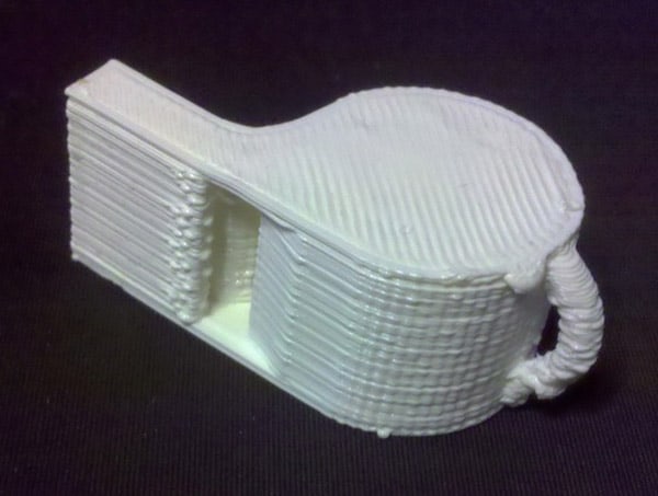

Most 3D printers use plastic filament extrusion technology. They build the parts up layer by layer. This approach is cheap and cheerful, but has the disadvantage that parts can be relatively low resolution. Here is a typical extruded part:
The whistle works, but there are extrusion lines you’ll have to either accept or sand off after finishing the part…

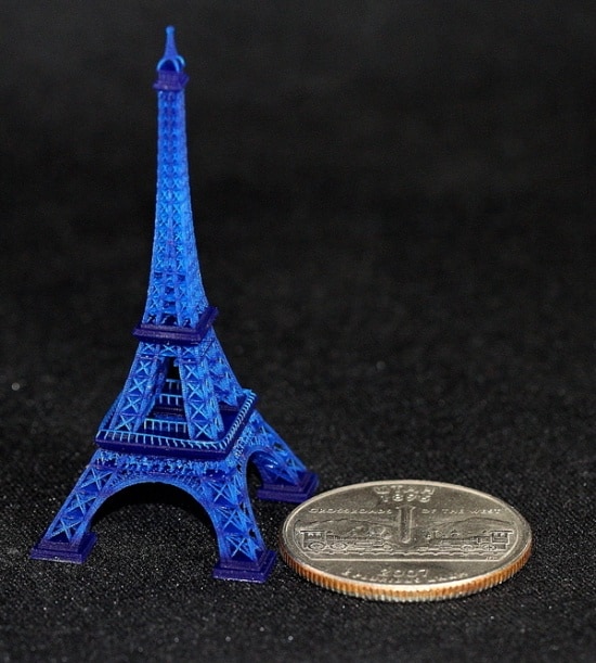

Eiffel tower printed with a high resolution 3D printer...

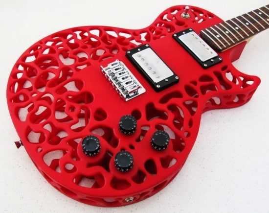

3D Printed Electric Guitar Body…

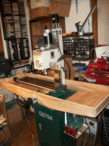

Here are some typical machines:

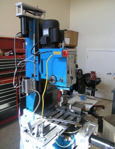

Hoss’s G0704 CNC Conversion at a fairly early stage: he added a lot more!
With a CNC Milling Machine in your shop, the sky really is the limit. Best of all is that the machine can be used to make even more tooling. Once you get the basic 3 axis working you can create powered drawbars, automatic tool changers, and all sorts of other accessories.

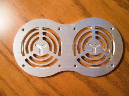

Fancy custom fan cover for a PC case…

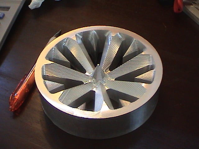

Custom mag wheels for kid's wagon to match dad's car…

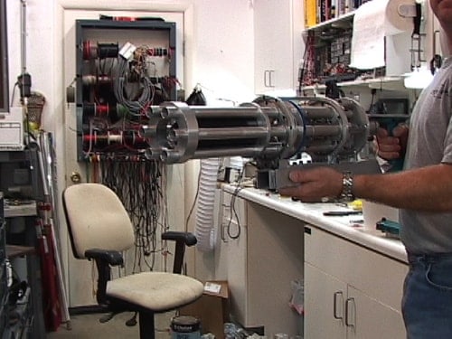

Paintball minigun…

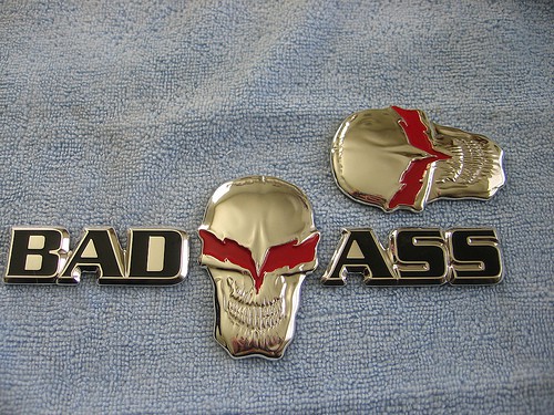

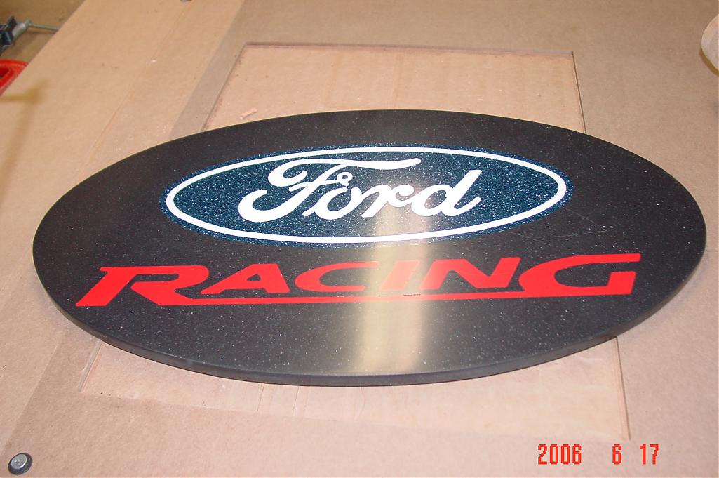

Custom car badges...

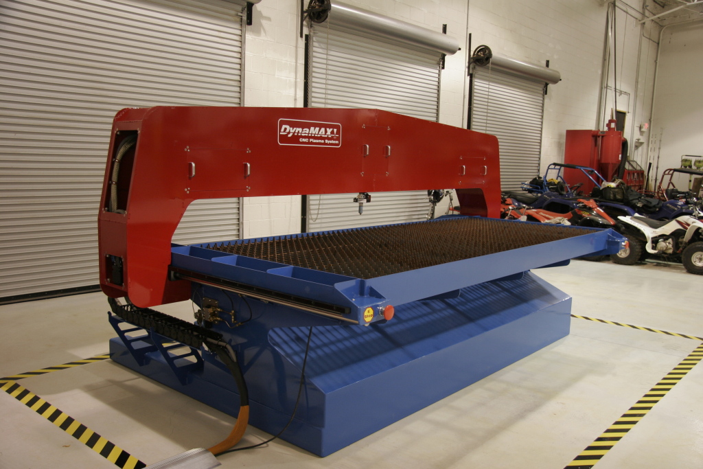

Next up in complexity would be a DIY CNC Plasma Table. These tables move a plasma torch around to cut shapes out of sheet metal. CNCCookbook has a gallery of DIY plasma table ideas that show many of the projects others have done. Here is a nicely finished plasma table:
A nicely finished plasma table…
Basically, you need an XY table with some ability to control Z height. The table doesn’t need particularly tight tolerances, but it is helpful if it can move fairly fast. A lot of what goes into a DIY CNC Plasma Table is very similar to a DIY CNC Router.

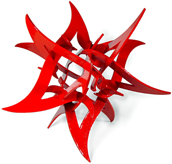

Sample Plasma Table Parts
Plasma tables are designed to cut parts from sheet stock:

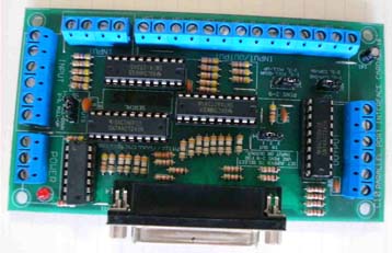

The controller is software that runs on a computer. Depending on the controller, it could be a PC or Mac, or it might be a dedicated small computer in the case of things like GRBL.
In addition to some sort of computer, there is typically a breakout board, one or more drives, and a power supply that generates the DC voltage the motors will need to move the axes. A lot of these components, such as power supply and drives can be purchased assembled, so you are basically just connecting building blocks together.
