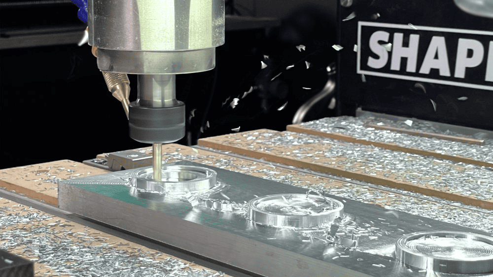

Folks often ask whether a CNC Router can cut aluminum.  They’re used to seeing them primarily cut wood and plastics.  My answer to this question is always, “Yes, any CNC Router can cut aluminum if you do it right.”  I’m going to tell you EXACTLY how to cut aluminum with your CNC Router with these 11 easy tips.
Once you know the secrets, you’ll find machining aluminum with a CNC Router is not only easy, but very productive.  Using a CNC Router for aluminum parts can be a very successful pursuit with a little care and preparation.  That’s not to say a CNC Mill wouldn’t be better for your task, so be sure to read our CNC Mill vs Router article to understand more.
There are a couple of things to remember about how aluminum (and other metals) are different from wood or plastics.  First, they have a much smaller “sweet spot” for optimal feeds and speeds.  If you leave the sweet spot, cutters start breaking, they wear out a lot faster, and surface finish is poor at best.  In fact, there are several sweet spots depending on what you want to accomplish:
Sweet Spots for cnc router aluminum cutting
Metals have much smaller sweet spots (narrower range of acceptible feeds and speeds) than wood or plastics…
The second thing is that for aluminum (and some other metals), there is a “stickiness” factor.  Aluminum wants to stick to the tool.  In fact, it will do so to the point that it welds itself to the tool.  Once you have gummy aluminum deposits on your cutting edges, that tool is not long for this world, especially not at 20,000 rpm or more.
Despite these challenges, you can cut aluminum very successfully on almost any router.  Here are 10 tips for CNC Router Aluminum Cutting Success:

5.  Be paranoid about clearing chips
I can’t stress this enough, especially when the material has an affinity to bond with the cutter.
Recutting chips breaks more cutters than most any other thing I see happening.  Be paranoid about clearing the chips.  Don’t count on a nearby vacuum dust collection system unless you have personally verified it sucks the chips out of even the deepest cuts.  More reliable is an air blast fixed to the spindle and pointing right at where the cutter meets the material being cut.  If you’re standing there, nozzle in hand (or worse a brush) thinking you can keep things clear, you’re not paranoid enough about clearing chips.

7.  Lubricate with a Mist
cnc router aluminum cutting requires lubricant such as mist or flood coolant
Assuming you’re suitably paranoid about those chips, the next issue is providing lubrication to cut down on the tendency for the chips to stick to the cutting edges.
Many CNC Router users are loathe to mess with coolant of any kind, but you pretty much have to use some kind of lubricant to cut anything but the thinnest aluminum reliably.  Since you’ve presumably already rigged up a compressed air blast, you may as well run coolant mist through the same mechanism.  In fact, buy a mister to provide air blast and coolant mist.  It’s easy and inexpensive.
You can set the mist so very little fluid is deposited to reduce the mess, and that’s fine so long as what’s being sprayed is going on the cutter.
Sometimes, it just isn’t possible to use mist but you still need to cut some aluminum.  If you’re cutting very thin aluminum, or taking very shallow passes, you may be able to get by without lubrication.  Do some tests and see.
