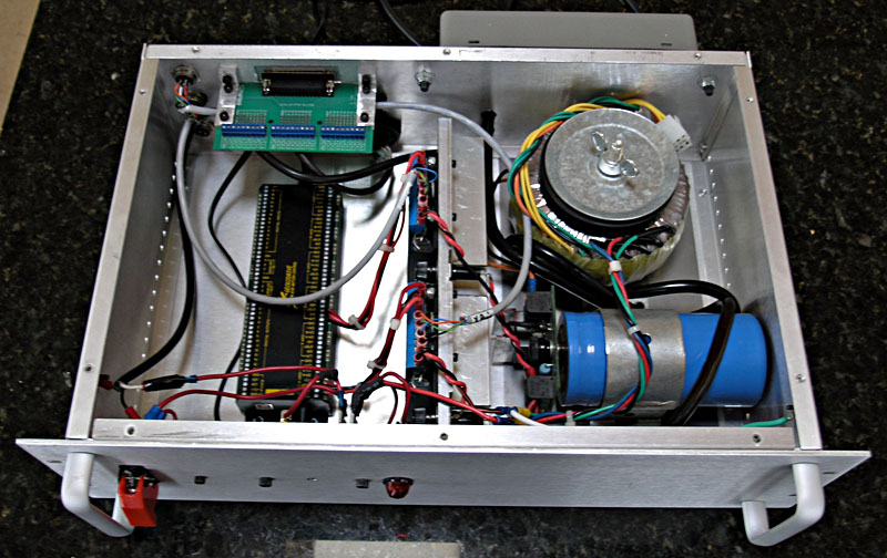

From Left to Right: GRex, Gecko Drives, and DC Stepper Power Supply for my CNC Lathe project...
