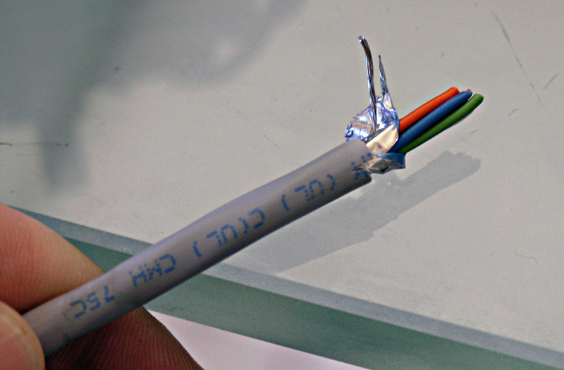

Use Shielded or Twisted Pair Cables
Shielded cabling for the stepper/servo motor wiring, encoder wiring, and limit switch wiring
is ideal for electrical noise resistance.
I bought a 500′ spool of 6 conductor shield 22 AWG cable from Action Electronics (No longer in business, unfortunately). For connectors, I’m using some microphone connectors, also from Action Electronics:
6 conductors and a foil shield: this is the
right cable for my step motors!
For others who may read this, you want to use shielded cables or electrical noise will make your system unreliable. FWIW, when I first got my limited switches going, I did not ground the cable shields to the CNC cabinet. As a result, I had a bogus limit fire about every 2 to 3 minutes. Grounding the shields made that go away completely. If you didn’t think you had electrical noise in your system, maybe it was because you didn’t have a way to check?
