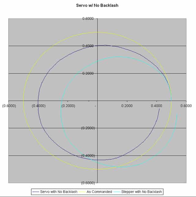

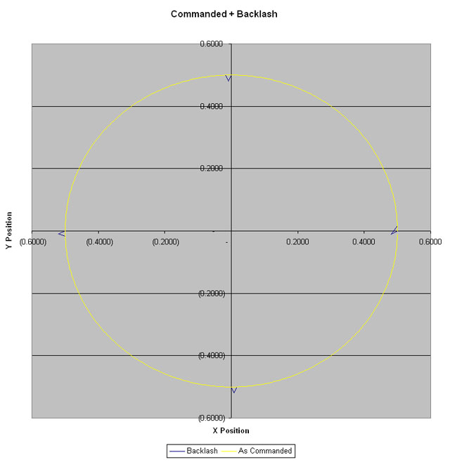

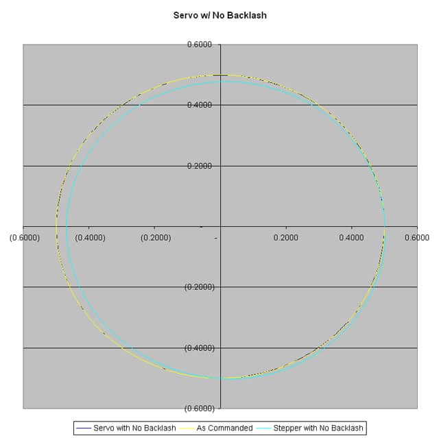

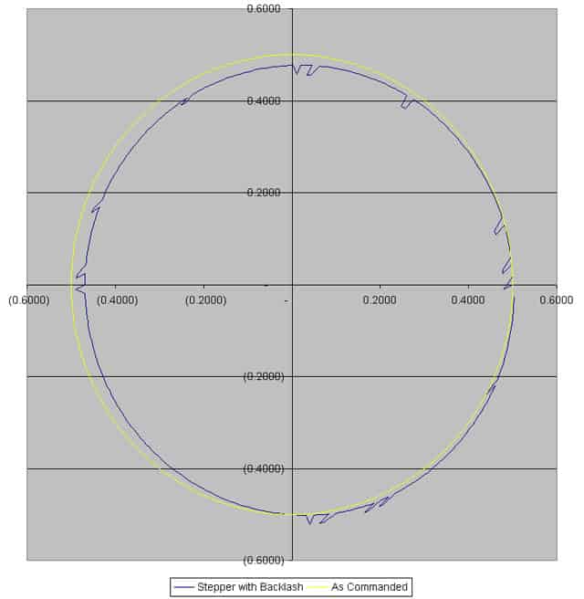

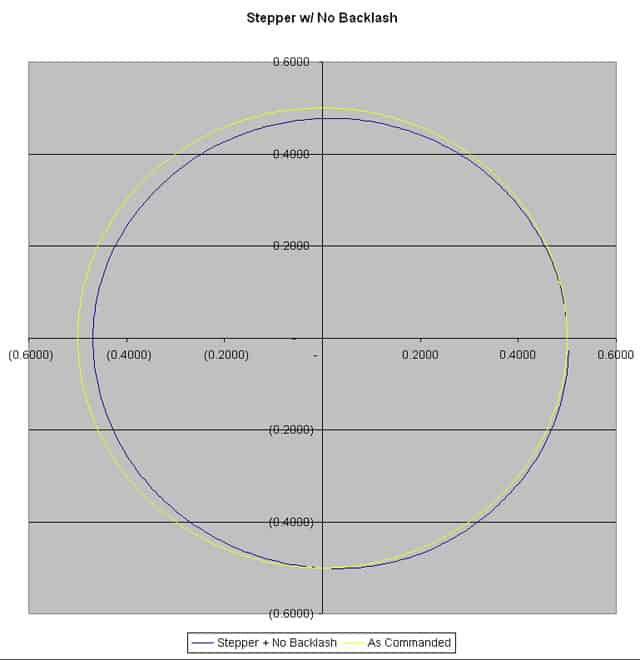

Backlash "Ears": 1" diameter circle, 0.020" backlash on both X and Y axes...
The little kicked out "ears" happen at each point an axis changes direction on the circle.
You can imagine also that when a part is being profiled, the spindle is moving back and forth and up and down to follow the contours of the part. Every time the spindle goes down and then shifts back up, that is a reverse of direction. Backlash is going to cause inaccuracy or dwell marks at those points where the direction is reversed.
As a matter of fact, cutting circles is an acid test for a mill. Try one and see how it turns out to get a rough idea how your backlash is doing as well as a number of other factors.

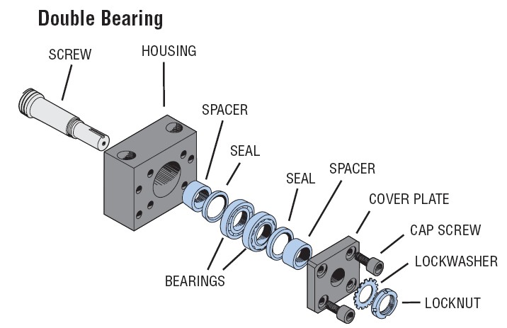

Here is an exploded view of a professional ball screw bearing block:
Note that the spacers shown here are not for preload, they simply allow more bearings to be mounted in the block for even greater stiffness, or different spacers would allow some bearing substitutions. Also note that this block has the bearings mounting in DB configuration, rather than DF.

Leadscrew and/or Nut Mounting (aka OMG those bearings are expensive!)
Okay, we spent a lot of time on this above. But maybe you bought cheaper bearings than will suffice for your application. You might want to save this for last, because if all else fails, you will face the expensive proposition of upgrading the (probably already expensive bearings) to some better (even more, possibly much more) expensive bearings. Try to come up with a way to measure just the play in the ball screw versus the bearings. Disconnect the nut from it's mounting, position a dial indicator to read the end of the bearing end of the ball screw, and try to push and pull on the far end. Can you read any play there? Given some of the preload numbers we've talked about (125 lbs to 500 lbs), you might need a fair amount of push/pull force to tell. Do the best you can. If there is too much play here, you may have a problem with the ball screw mounting, very likely the bearings.
You can also run a test with the ball screw turning. Most ball screws with have an indentation in the end. You can rely on the end to be true, but you can place a ball bearing in the indentation and then indicate off the ball bearing. The ball bearing can be held in place with a little dab of grease or superglue. This is one of the best ways to measure the motion of the ball screw in its bearings.
Make sure the bearings are installed properly. Are they facing each other properly in the DF configuration or is one flipped? Check the torque on the lock nut for proper preload. What about the mounting block for the bearings? Are they tight in there, or can they move around? Check the spacers, shims, and fits of it all. Remember we talked about how in the most precise designs a lot of this requires ground precision? How about the ball screw and ball nut? Is there play there? Try the opposite of the prior measurement. Leave the ball nut mounted, but remove the bearings supporting either end. What kind of play is there? Is the ball screw used? Could it be worn? If so, consider reloading some oversized balls, but start in small increments. BTW, there are outfits that will do this for you at a nominal charge and it is a pain, so consider using one. If you have double ball nuts, how about adjusting the preload?

- Commanded + Backlash: From here on, I show the commanded as one line, yellow, and the others in other colors. On this one, you can see the characteristic backlash "ears" or glitches when describing a circular toolpath:
You can see the little blue "ears" are quite pronounced and would be an unhappy result if you were trying to machine a circle. 0.020" is quite a lot of backlash, but certainly not unheard of.
- Stepper w/ No Backlash: This graph shows the effect of lost steps. As mentioned above, you can adjust the likelihood of losing steps. I have no idea what a reasonable real value is, but after playing with the simulation I can clearly understand why people tune stepper systems to such slow speeds that there is almost no chance of losing a step! Here is a graph with a 2% step loss:
Stepper system losing 2% of steps...
You can see that the problem is once you lose a step, you never get it back and the errors just accumulate, making things worse and worse as the CNC program runs on. The result is scrapped parts or worse, a crash of some kind on your machine.
- Stepper with Backlash:
Wow! Backlash and Steppers are Incompatible!
This graph is particularly glitchy and bad. What's happening is the lost steps are triggering backlash due to direction changes as the machine hesitates. This is probably not that realistic a simulation, but if it was only half right, it shows how bad things can bit if you take a system with lots of backlash and run it open loop.
- Servos with No Backlash: This graph is a comparison of servo vs stepper with no backlash.
Servo vs Stepper, Assuming No Backlash...
The sample assumes 2% lost steps (very high, puts the stepper in a bad light) and that the servo system can correct only 10% of the error in a given step cycle (seems slow to me, but I really don't know what a "real" number might be). What is obvious is that the servo can track extremely well, and basically stays right on the circle (not quite, you can see little bits of blue), and the stepper does the exaggerated walk of the path that we saw before.

Likewise, Closed Loop does not fix all the sins either. Here is a case where the lost step rate is very high (25%) and the ability to correct for lost steps is slow (taking 100 steps). We are little better off here than with an open loop system (also depicted):
When your servos are too slow to correct following error, closed loop is no advantage...
When you hear someone discussing having to slow down their speeds for their servo system to achieve accuracy, think of this graph. Also think of getting some bigger motors to reduce the errors!
