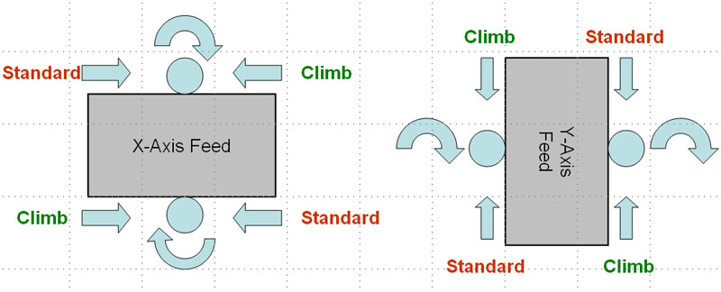

Climb milling is when the direction of cut and rotation of the cutting tool combine to try to “suck” the mill up over (hence it’s called “climb” milling) or away from the work. It produces the best surface finish. Here is a diagram showing climb milling versus conventional milling for a number of orientations:
Arrows show workpiece motion, not spindle motion!
Keep in mind that for this illustration, it is the workpiece that moves, not the spindle. On some machines, like a gantry router, the spindle moves, so the labels would reverse. I keep it straight by thinking of the spindle as a pinch roller that can either help move the workpiece in the direction it was already going (climb milling), or that might fight that movement (standard or conventional milling).
Try the experiment on your mill of cutting both ways and you’ll see that climb milling is a lot smoother and produces a better surface finish (most of the time, there are times when conventional milling gives a better finish, see below) than conventional milling. Note that depending on which way you are milling, you will need to make sure your workpiece is supported well in that direction.

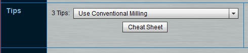

– When cutting from 3/4 to 1x the cutter diameter, you should prefer conventional milling.
The reason is that cutter geometry forces the equivalent of negative rake cutting for those heavy 3/4 to 1x diameter cuts. This is definitely not the best for Tool Life!
It seems that Dapra corporation first discussed this phenomenon way back in 1971. G-Wizard now reminds you with a little hint which one you should prefer:
G-Wizard’s Hints tell you what to do: “Use Conventional Milling”…

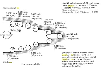

How does climb vs conventional milling affect tool deflection and accuracy?. The following illustration contains small arrows (often called vectors) showing the direction of tool deflection as the cutter moves along the toolpath:
The arrows show where the cutting force is attempting to deflect the cutter. Conventional cut at top, climb cutting at bottom.
Note how the deflection force vector is more nearly parallel to the cut with conventional milling (albeit the arrows are longer, showing there are higher cutting forces). With climb milling, the arrow is nearly perpendicular to the cut. If your cutter deflects 0.001″, wouldn’t you prefer it to be nearly in the direction of travel? The alternative is for the cutter to plow deeper into the wall or pull away from the wall. Either case will introduce more error in the part being machined. The counterpoint is that the lengths of the vectors are longer when conventional milling. That’s telling you that the cutting forces are heavier and the tool is more likely to deflect with conventional milling.
Try climb for roughing, because you can rough faster and the tool deflection effects on accuracy don’t matter–the finish pass will deliver the accuracy. You can rough faster because cutting forces are lighter and the thick-to-thin chip profile carries the heat away on the chip. That thick-to-thin + carrying the heat away is particularly crucial for tough work-hardening materials like stainless. It also results in a nicer surface finish if you can afford to climb for the finish pass.

The problem is that deflection affects surface finish too. If the vector is nearly parallel to the path, you can consider that the portion of the vector that pushes it “off parallel” is very small. Therefore, the tool will have little tendency to deflect and put waves on the wall you’re finishing. Note that this may be particularly important in thin wall work where the walls are weak!
Therefore, you should switch to conventional milling for the finish pass if you’re at all deflection challenged (use G-Wizard to see if your tool diameter and stickout result in small enough deflection for your finish pass). At the very least, one should avoid too much depth of cut when climb milling to create less tool deflection. The same article suggests that when deflection is to be minimized, use no more than 30% of the diameter of the cutter for conventional milling and 5% for climb milling. Of course here again, if you have G-Wizard, you’ll know what kind of deflection to expect and whether it’s a worry.
