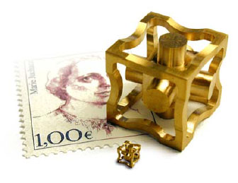

Exquisite micromachined turner's cubes...

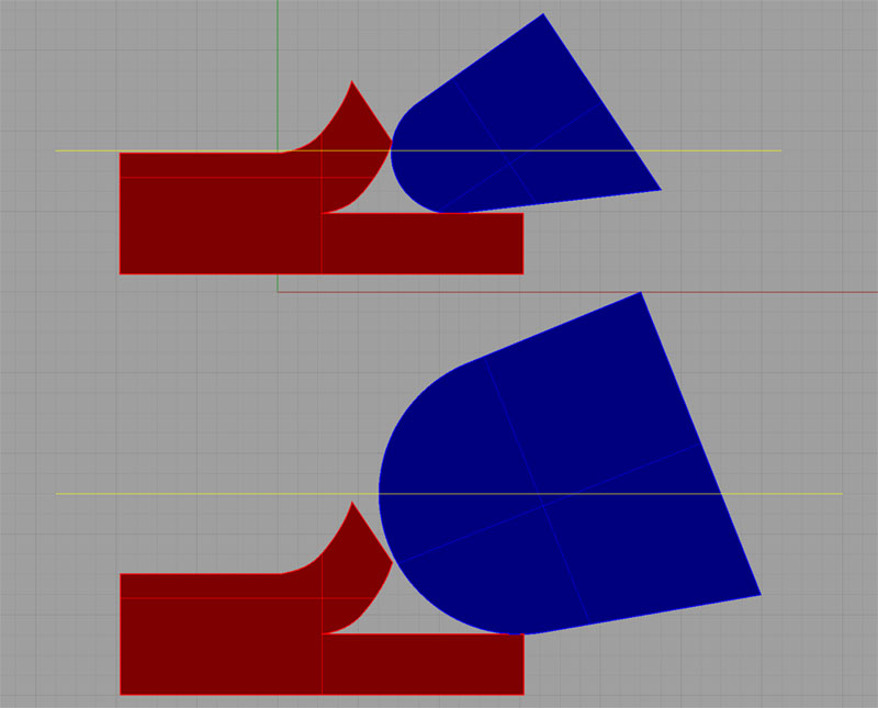

For example, the geometry at these scales is such that the rake on the cutters is almost always negative. To understand why that is, consider our diagram that shows how rubbing occurs when chip load gets too low relative to the radius of the cutting edge:
Two chip loads: Top one has chip thickness > tool edge radius. Bottom one has chip thickness < tool edge radius and therefore is showing negative rake. It's also more likely to plough or rub at these scales.
There's a limit to how sharp micro-cutters can be made, and hence they're far more likely to run in the negative rake regime where ploughing and rubbing are the norm rather than cleanly shearing chips as is the case with regular machining. As a result, The Association for Manufacturing Technology says:
The principal distinction between Macro and Micro-Machining operations emerges and manifests itself as the dominance of ploughing and rubbing phenomena at the cutting edge over shearing and the necessity to take micro-structural effects into consideration. Once feed-per-tooth is on the order of the cutting edge radius of the tool, macroscale rake angle is irrelevant.
For really small cutters, the cutting force is twice what conventional calculations suggest it should be and chip load must be matched even more closely to manufacturer's recommendations to prevent rubbing. In fact, the cutting forces can be even worse, and research from The Association for Manufacturing Technology finds it as high as 10-20 times what conventional machining models would predict.
With micromachining there is a pronounced minimum chip thickness that must be observed if the machining operation is to be successful. Below that thickness, chips simply do not form. In fact, most micro-milling involves a relationship between chip thickness (chip load per tooth) and cutting edge radius that is marginal. Often, a chip is not formed by every revolution. In other words, chips are formed intermittently, and when they do form, they're larger than would be predicted by the calculated chip loads. The difference between the volume of chips formed by "normal" milling operations and micro-milling can be as high as 9x for micro-milling and is typically on the order of 2-3x.

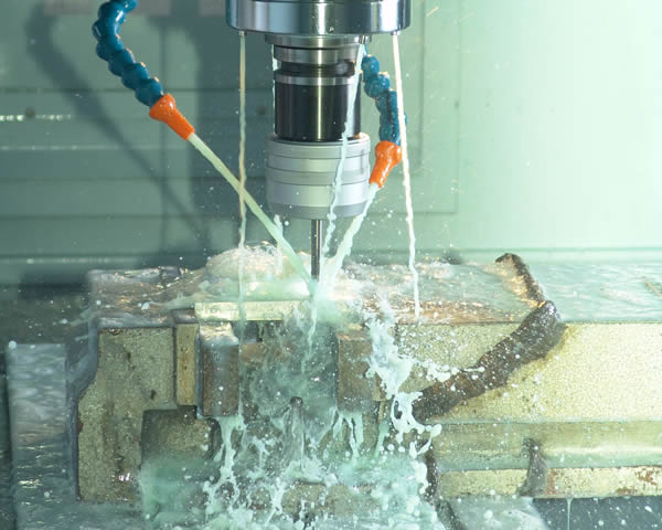

2. Clear The Chips!
In micro-milling it's very important to keep the chips clear. I always cringe when I see a picture with a lot of chips piled around the cutter. Recutting the chips and trying to force the new chips past the pile of old ones is really hard work on your poor old cutter and micro-cutters are even less capable of doing the job. Avoid driving them into deep slots and pockets except with absolutely minimal cut depth and stepover per pass.
Flood coolant is not necessarily a panacea. Really tiny cutters are happier with mist as the pressure of the flood itself can be hard on the cutter. In addition, too little flow or poorly aimed flow can sometimes allow chips to pile up even with a good flood system.
If you train yourself to be paranoid about chips in the cutting area, you'll immediately see benefits in cutter life and surface finish.

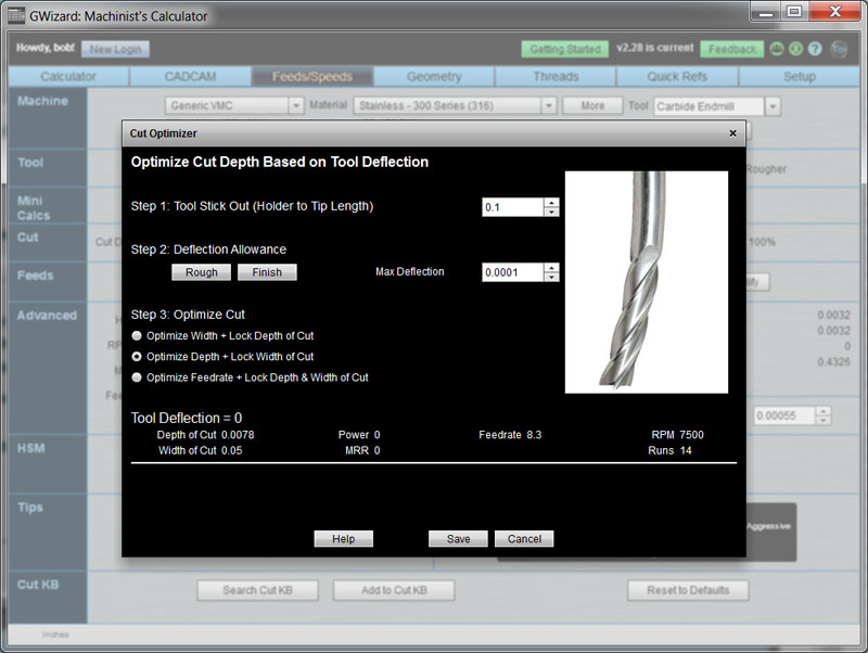

3. Be wary of Tool Deflection
G-Wizard lets you calculate your deflection and even optimize cuts to hold to deflection limits. Deflection is just like runout for small cutters, and it becomes easy to forget about having too much tool stickout because the darned things are so small it seems like only a small amount protrudes.

Just as importantly, G-WIzard has a plethora of tools to help in managing tool deflection, which is critical for micromachining applications.
The key thing to keep in mind is that tool stickout is measured from the top of the cutter-diameter section to the tip, and should not include the much larger tapered shank. From the standpoint of the micro-mill, that tapered shank is so much larger than the cutting portion that its rigidity is not in question. When you buy your micro-mills, look for stub lengths of this section. Keep it as short as possible. 3 x the cutting diameter is a good basis though much longer cutters are available. Resist the temptation to stock up on the longer cutters unless your job specifically calls for it because they're so much less rigid.
The G-Wizard Cut Optimizer will calculate the optimal Cut Width, Depth of Cut, or Feedrate to stay within tool deflection guidelines...
