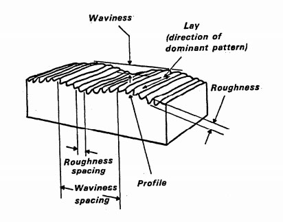

Before we get on with Surface Finish Symbols, let’s understand how Surface Finish is defined. Engineering prints call out a great many things in their attempt to make sure the part that gets made matches the designer’s intent. Aside from dimensions and tolerances, another important callout is Surface Finish.
Surface Finish is a measure of the overall texture of a surface that is characterized by the lay, surface roughness, and waviness of the surface. Surface Finish when it is intended to include all three characteristics is often called Surface Texture to avoid confusion, since machinists often refer to Surface Roughness as Surface Finish. Another term, analagous to Surface Texture, is Surface Topology.
This diagram gives an idea of how to think of the relationship of Waviness, Lay, and Roughness:
The relationship of Waviness, Lay, and Roughness…

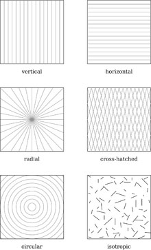

Lay
The Lay is the direction of the predominant surface pattern, and is usually determined by the production method used to process the surface. Here are some typical Lay patterns:
Surface Roughness
Surface roughness is a measure of finely spaced surface irregularities. Surface roughness is usually what machinists refer to when talking about “surface finish.” When talking about all three characteristics, they may use the term “Surface Texture” more properly.
Waviness
Surface Roughness speaks to fine detail imperfections, but there may also be much coarser irregularities. For example, a surface may be warped or deflected from the ideal.

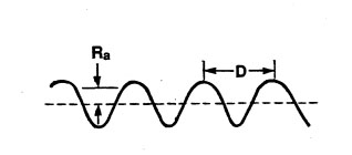

There are a number of different characteristics we might measure with respect to Surface Finish. Two of the most important are the height of the roughness peaks and their separation, often referred to as “Ra” and “D”:
Ra and D are two important surface finish parameters…
The Surface Finish Units we would use for parameters like Ra would be either micro-inches (English or Imperial) or micrometers (Metric). Our chart of surface finishes by manufacturing process (see above) gives both.

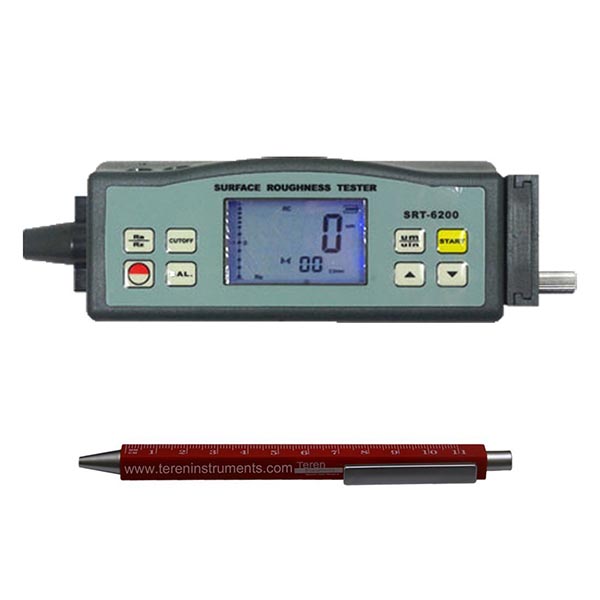

Instrumenets used to measure Surface Roughness using these various techniques are called Profilometers.
Pocket Profilometer…

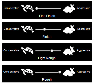

In general, adjust feeds and speeds for a lower chip load at the same rpms for a better finish. Take a finish pass that’s relatively light as well. Make sure as you’re doing this to avoid rubbing, which is very hard on tool life.
Our G-Wizard Calculator software has a handy “Tortoise-Hare” slider that makes it easy to dial in proper feeds and speeds for a finishing pass:
G-Wizard’s Tortoise-Hare slider for dialing in your finish…
G-Wizard will also warn you if rubbing is a risk, which will help you avoid that problem.

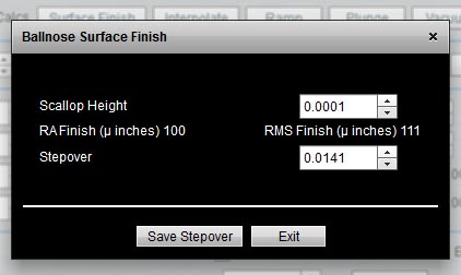

If you’re 3D Profiling, each pass of the ballnosed cutter leaves a “scallop” in the surface of the material. Our G-Wizard Calculator software has a special Mini-Calc that will help you adjust for a scallop height that delivers the required surface finish:
Ballnose Surface Finish Calculator…
Enter the maximum scallop height and G-Wizard will tell you the resulting RA and RMS surface finish as well as calculate the stepover. BTW, if you want to know how to pick optimal stepovers and tool diameters for 3D Profiling, we’ve got an article on that too!

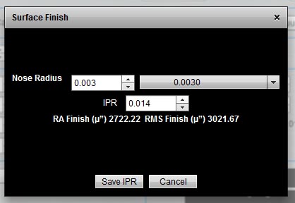

Surface Finish While Turning
Turning is very similar to 3D profiling in that the stepover, in this case determined by the feedrate while turning, results in scallops that match the shape of the turning insert. We use this to good effect when turning threads, but if we want a smooth shaft, we’ll have a surface finish requirement that must be met. That will determine feedrate and insert nose radius we can use for the job. G-Wizard has a nice calculator for that too:
Surface Finish Turning Calculator…

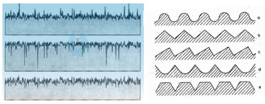

Ra, while common, is not sufficient to completely characterize the roughness of a surface. Depending on the application, surfaces with the same Ra can perform quite differently. Here are 4 surfaces with the same Ra and quite different shapes:
All four surfaces have the same Ra but quite different shapes…
To distinguish these differences, more parameters are needed.

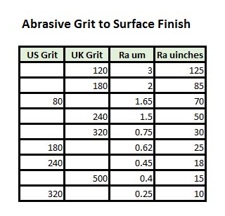

Surface Roughness of Abrasive Grits and Sandpaper
One approach to Surface Finish is to use abrasives or sand the surface. This chart converts from abrasive grit to Surface Finish Ra values:

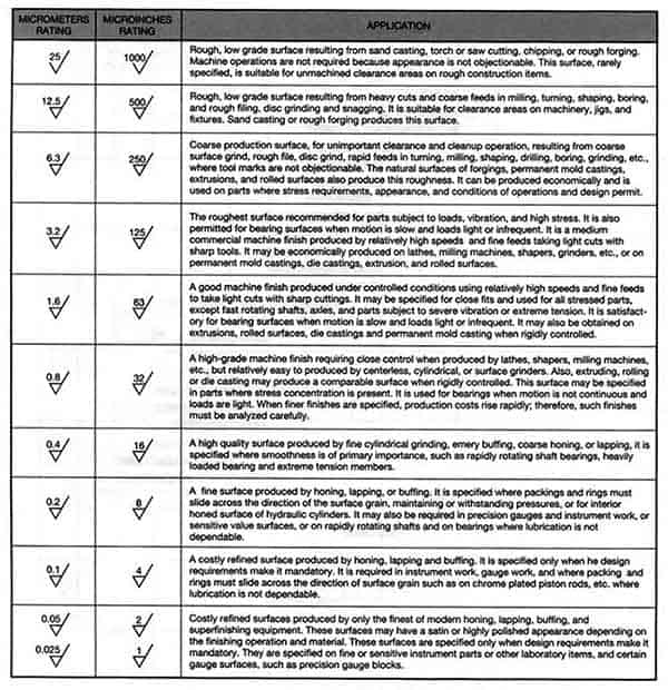

Surface Finish Cheat Sheet
A super handy Surface Finish “Cheat Sheet”:
Surface Roughness Conversion Chart Tables – Metric and Imperial
Cut-off Length | ||||||
Ra (µm) | Ra (µinches) | RMS | Rt | N | in | mm |
0.025 | 1 | 1.1 | 0.3 | 1 | 0.003 | 0.08 |
0.05 | 2 | 2.2 | 0.5 | 2 | 0.01 | 0.25 |
0.1 | 4 | 4.4 | 0.8 | 3 | 0.01 | 0.25 |
0.2 | 8 | 8.8 | 1.2 | 4 | 0.01 | 0.25 |
0.4 | 16 | 17.6 | 2 | 5 | 0.01 | 0.25 |
0.8 | 32 | 32.5 | 4 | 6 | 0.03 | 0.8 |
1.6 | 63 | 64.3 | 8 | 7 | 0.03 | 0.8 |
3.2 | 125 | 137.5 | 13 | 8 | 0.1 | 2.5 |
6.3 | 250 | 275 | 25 | 9 | 0.1 | 2.5 |
12.5 | 500 | 550 | 50 | 10 | 0.1 | 2.5 |
25 | 1000 | 1100 | 100 | 11 | 0.3 | 8 |
50 | 2000 | 2200 | 200 | 12 | 0.3 | 8 |
