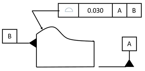

Profile of a Surface on Drawings
Profile of a Surface Callout on a drawing...
Technical drawing of surface profile callout with measurement markings.
Above is a typical example of a callout for Profile of a Surface on a drawing.
