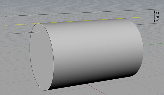

Surface Straightness is a tolerance that controls a line somewhere on a surface or a feature. For example, suppose we are controlling Straightness Tolerance on a cylindrical part or feature of a part. Pictorially, here's what that means:
Cylindrical object with measurement lines and machining-related data.
Straightness Tolerance is the maximum deviation from the yellow line on the cylindrical surface...

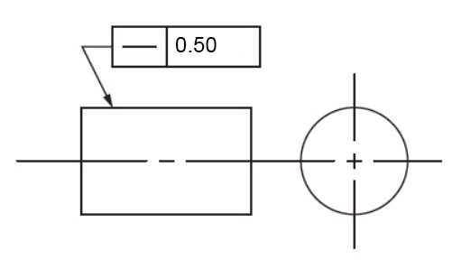

Technical drawing symbol measuring surface straightness deviation.
Surface Straightness callout for the drawing above...
When we specify the surface flatness, the tolerance zone will form a two dimensional wide area above and below the ideal surface position and control all deviations. Surface straightness controls the form of lines anywhere on the surface, and there are two types of applications:
In both cases, the tolerance zone forms a 2D plane. It appears as two parallel lines (also parallel to the surface), one above the surface and the other below the surface.
The Surface Straightness callout or feature control frame points the arrow to the surface and gives the tolerance zone size.
