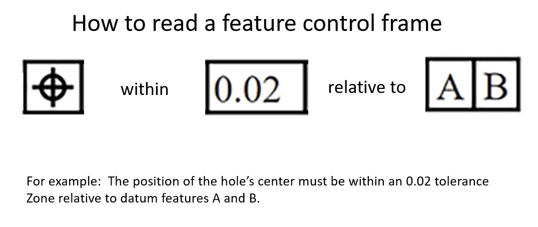

Reading the Feature Control Frame
Think of the Feature Control Frame as forming a sentence when you read it. Move left to right and call out each part in words:
