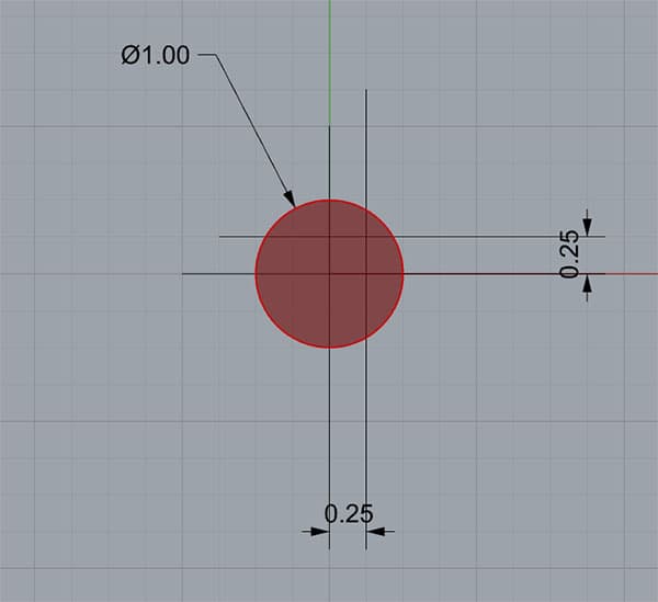

Since a picture is worth a thousand words, geometrically, what we've been talking about looks like this:
The Red Circle is the tolerance zone for the hole center...
In this example, the Red Circle is the tolerance zone for the hole center. The True Position is 1.00 (keeping it in round numbers to make it easier to scale your real numbers and see what all this means). The actual position of our hole differs from True Position by 0.25 in both X and Y. So the True Position in this example would be 0.7071, which is within the 1.00 position deviation called out for the True Position-we're okay!

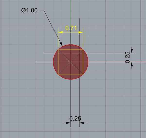

Now let's relate that True Position back to convention plus/minus or limit dimensions.
True Position Example: Traditional plus/minus tolerancing must fit inside the yellow square...
If we were using traditional plus/minus tolerancing, we would use something along the lines of the yellow square. It's sides in this case are 0.71" (at this precision, it's actually the square root of 0.5, the circle's radius), so we'd use plus or minus half that to get a position deviation of plus or minus 0.355.
Here's the rule of thumb to memorize:
You only have a little more than a third of True Position in each dimension for your plus/minus tolerance. About 35% to be more exact.
Now you may have heard people say that GD&T actually lets us use looser tolerances so parts are cheaper to make. This diagram makes that clear. If we can only use plus/minus tolerancing, all we can do is use the square, which is forcing us to a smaller area in which our actual hole center must fit: the area of the yellow square is certainly less than the red circle. In fact, it is quite a bit less.
Because we are allowed to hit a larger position deviation with GD&T's True Position concept, it's easier. Look at it this way-the 4 areas of the True Position Tolerance Zone that are outside the plus minus tolerance zone make it clear that there are places where one of the two plus/minus tolerenaces could be broken and the feature would still be within true position tolerance!

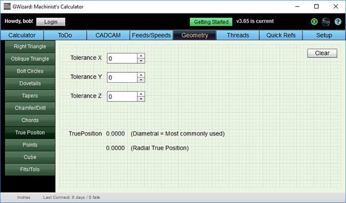

How to Use the True Position Calculator
- Enter the basic X and Y location of the feature from the drawing. Switch to 3D if the callout also controls Z.
- Enter the measured X and Y location.
- Enter the position tolerance from the feature control frame.
- If the tolerance has an MMC or LMC modifier, pick it, say whether the feature is a hole or a pin, and enter the size limits and the measured size. The calculator adds the bonus tolerance.
The plot shows the allowed tolerance zone (green when the feature passes, red when it fails), the stated tolerance as a dashed circle when there is bonus tolerance, and your measured location as a blue dot.
Worked example with MMC: a 0.500"-0.510" hole is positioned at X 10.000, Y 5.000 with a position tolerance of Ø0.020 at MMC. You measure the hole at X 10.009, Y 4.992 and 0.506" in diameter. True position is 2 x SQRT(0.009^2 + 0.008^2) = 0.0241, which is more than 0.020. But the hole is 0.006" larger than its MMC size of 0.500", so you get 0.006" of bonus tolerance: 0.020 + 0.006 = 0.026 allowed, and the hole passes.

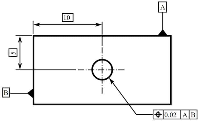

True Position on Drawings: True Position Callout
By now you're grasping the basics of how True Position works. Let's get a good look at how it appears on drawings with an example of a True Position Callout:
True center position of the hole regardless of feature size...
The drawing above has a hole whose center is at X = 10, Y = 5. The True Position of that center is 0.02. The A and B datums are clearly marked and so things are straightforward.
If we wanted to specify the Maximum Material Condition, that would simply be added to the Feature Control Block. What if we added it hear? Knowing the True Position is at Maximum Material Condition would let us construct a functional pin gage. The diameter of the pin would be the nominal diameter of the hole minus the Maximum Material Condition True Position Tolerance. Likewise, we'd position that pin at X = 10 and Y = 5 since the MMC took care of both size and position for our gage.
