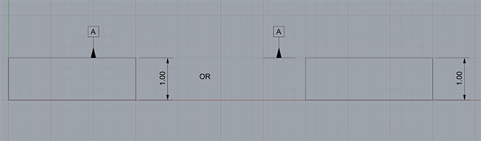

On a Surface (Plane)
datum symbol surface
Two examples of Datum Sybols on a Surface
We can place the datum symbol either on the surface or on one extension line from the surface. For any surface other than a round cylinder, the datum is strictly on the side where the symbol is shown. However, for a round cylinder, the datum is the entire round surface.

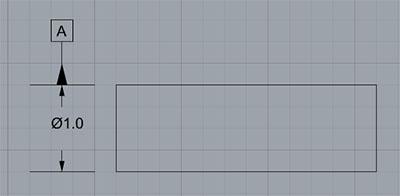

On an Axis
Place the datum symbol on the dimension of a diametric tolerance for Axis control:
datum symbol axis
A Datum Symbol on an Axis
Remember: this places the Datum on the central axis through the feature, not the surface of the feature. Placing the Datum on an axis is common with GD&T symbols that can have axis control like runout, perpendicularity, or concentricity.

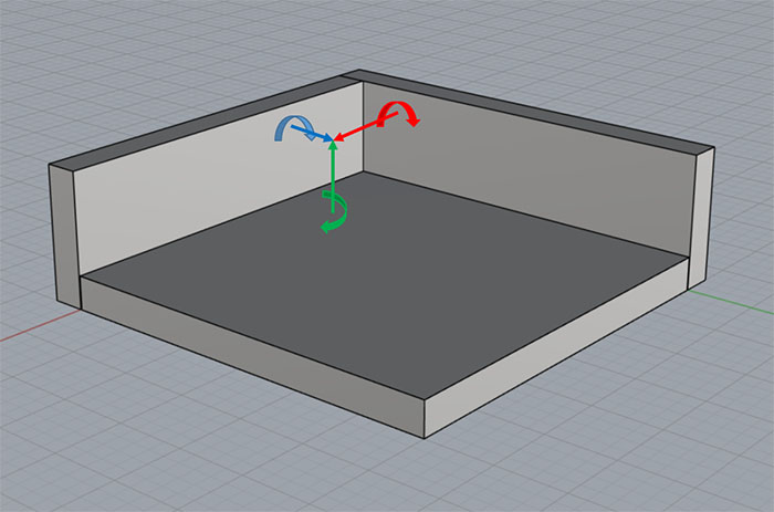

Datum Reference Frames and 6 Degrees of Freedom
Every Datum exists within the context of some Datum Reference Frame. In practice, we must eliminate 6 degrees of freedom before we can fully locate and orient a part within a Datum Reference Frame:
Controlling 6 degrees of freedom…
Controlling 6 degrees of freedom means controlling 3 linear distances from Datum planes to establish an X, Y, and Z position and controlling 3 rotary positions to orient the part at that position. We refer to the translational degrees of freedom as X, Y, and Z and the rotational degrees as u, v, and w.

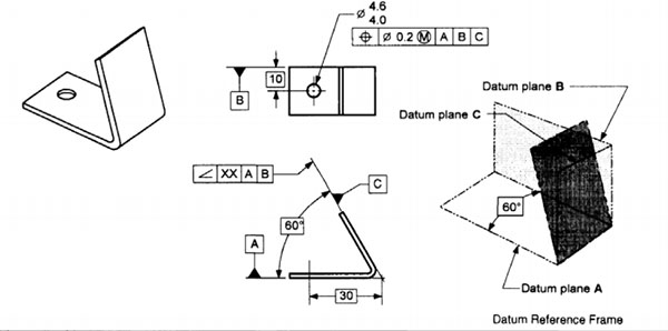

Inclined Datum Features
One may specify a datum feature that is at an angle other than 90 degrees relative to other datum features. These are called Inclined Datum Features.
Datum C corresponds to an Inclined Datum Feature…
