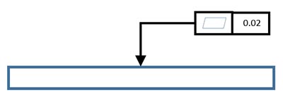

Flatness on Drawings
Technical diagram with horizontal line and downward-pointing arrow indicating 0.02 mm measurement.
Use of Flatness in a drawing...
Use of Flatness in a drawing is straightforward. Simply callout the Flatness allowance in a feature control frame with an arrow leader designating the surface being controlled. The Flatness feature control frame may also rest on an extension line for a dimension of the surface.
