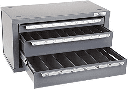

For example, a tool could be located in a bin such as this Huot Twist Drill Dispenser:
Twist Drills in a dispenser like that are not in tool holders, but this is a pretty common way to store them until they’re needed for a job.

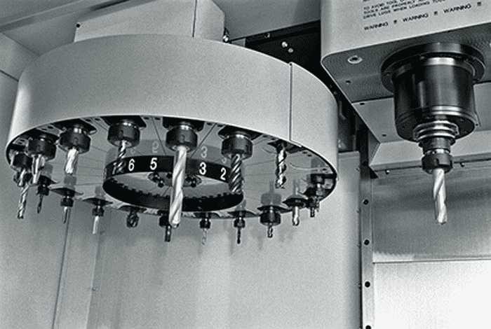

Or, a tool could be located in a particular machine’s automatic tool changer:

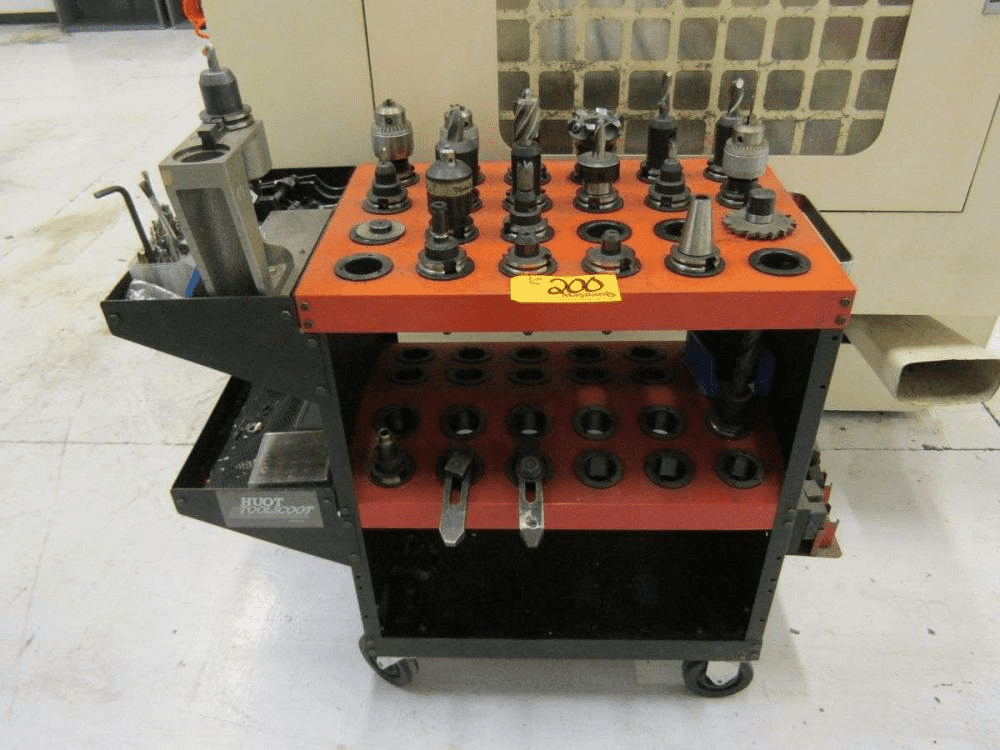

Lastly, it could be on a Tool Cart so it can be transported between Tool Storage and the CNC machine it’ll be used on:

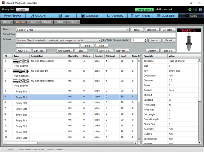

Example: Set Up an Automatic Tool Changer
Suppose you have an ATC on your Haas VF-2 that holds 20 tools.  You might set it up to track tools in G-Wizard like this:

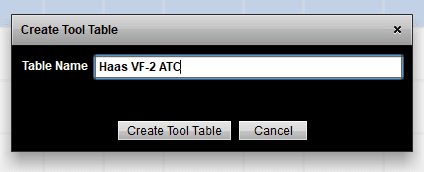

  1. Click the “New” button just to the right of the Tool Crib dropdown to create a new tool table.
  2. Enter a name for the table in the popup.

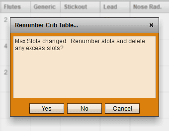

3. Enter Max Slots value of 20 and set the Table Type (under Options) to Machine.  If any changes or renumbering is required, G-Wizard will ask you to confirm.
Now you’ve got a Tool Crib corresponding to your machine’s ATC that has the correct number of slots and is ready to go.
You can move tools to this table (or copy, or just create them in place) to manage what’s installed on your Haas.
