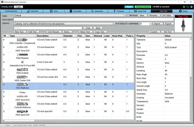

The Tool Crib makes it easy for you to define the tools you actually own or perhaps that are in the toolchanger of your CNC:
The Tool Crib…
Select which tool table you’d like to use from the Table choice. “Default” is the one the Feeds and Speeds calculator will use for tool selection, so that’s a special table. If possible, make it the one that reflects the real tools in your changer or that you own. You can create new tables or delete tables. Eventually, you will associate tables with particular machines too, but this is not yet working.
To edit a tool in the table, simply select it and press the “Edit Tool” button. To create a new tool, press “New Tool”. To delete a tool, press “Del Tool”. The tools are saved when you exit G-Wizard to a settings file.
Finding Tools in the Tool Crib
There are several features designed to help you find a tool in the crib.
First, there is a search feature right above the Tool Crib tool grid.  It lets you search for words in any of the fields of a Tool entry.
Second, you can filter tools by the type of operation they’re suited for.  Just click the icon of the tool in holder and you’ll get the popup:
Select an operation and the crib will be filtered to show only tools appropriate for the operation you select.  This is particularly powerful when used in combination with the “All Tools” checkbox at the top of the Tool Crib tab.
As an example, if you select the “Hole” operation, you’ll get all manner of drills, but also Reamers and other Hole Making Tools.  No endmills, even though you can interpolate a hole, as it wouldn’t be much of a filter in that case.

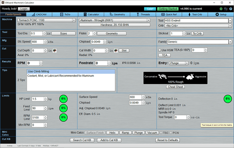

Integration with Feeds and Speeds Tab
As you are editing a tool in the Feeds/Speeds tab, you can send that tool over to the Tool Crib by pressing the “To Crib” button right next to where you enter the Stickout:

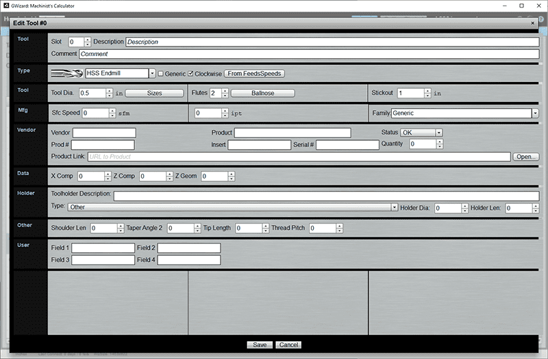

Or, if in the Tool Crib Tool Editor, bring over the tool defined on the Feeds and Speeds tab by pressing the “From Feeds Speeds” button:
The Tool Crib’s Tool Editor…

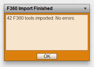

  5. When it’s finished, you’ll see a message like this one:
It tells you how many tools were imported and how many errors were found during import.  G-Wizard will log an error for anything it doesn’t understand in your F360 Tool Library in the “Comment” field.
If G-Wizard does find a problem, it will flag it by adding to the Tool’s Comment field.  Like F360, G-Wizard supports a comment field.  A typical message would be, “IMPORT: Unknown Tool Material”.  Be sure to check for those if the popup tells you there were errors.

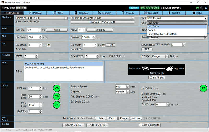

Using Tool Crib Tools in Feeds/Speeds
Over on the Feeds and Speeds tab, if you want to choose from the Tool Crib “Default” Table instead of the generic list of tools, simply click on the “Crib” dropdown, choose a Tool Table, and the tool choices will be those of that tool table:

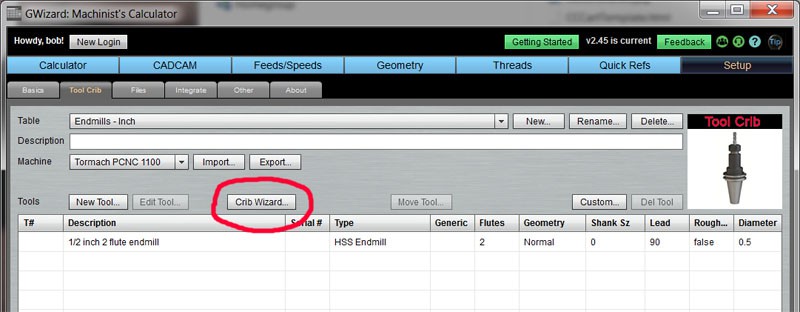

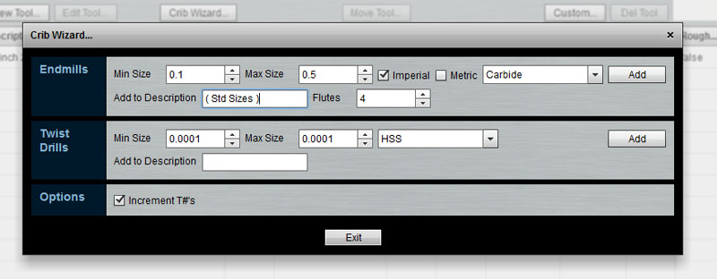

Crib Wizard
The Crib Wizard is capable of automatically generating Tool Crib entries for endmills or twist drills in standard sizes.It’s accessed via a button on the Tool Crib:
CribWizBtn
The Crib Wizard button is located on the Tool Crib screen…
Clicking the button brings up the Crib Wizard:
CribWizard
The Tool Crib Wizard…

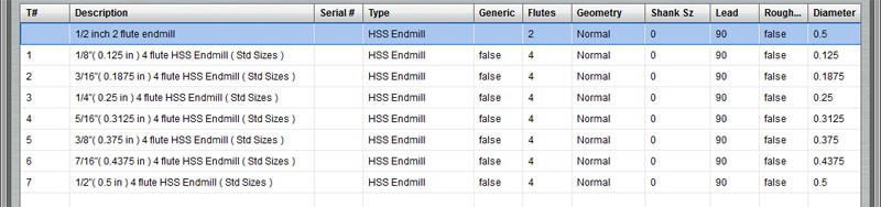

The Crib Wizard makes it easy to set up a Tool Crib with standard tools.  For example, the screen shot is set up to add tools in standard Imperial sizes from 0.1″ to 0.5″ in diameter.  It’ll add Carbide 4 flute endmills, and the comment will have not only a description of the tool, but the suffix “( Std Sizes)” as a reminder of what those tools are.  So the Crib looks like this after the “Add” button is pressed:
CribWizResult
Results after pressing the “Add” button on the Crib Wizard…
As you can see, the Crib Wizard adds to whatever was already there.  This makes it easy to go through and add different collections of tools.  Perhaps the sizes you want to stock for Imperial are in a smaller range than the metrics, for example.
