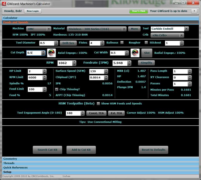

The Cut KB is accessed via two buttons at the bottom of the Feeds and Speeds tab:
Accessing G-Wizard's Cut KB
The Cut KB is accessed via the “Search Cut KB” and “Add to Cut KB” buttons at the bottom of the tab…
To add new entries to your Cut KB, press the “Add to Cut KB” button.
To search or edit your Cut KB, press the “Search Cut KB” button.

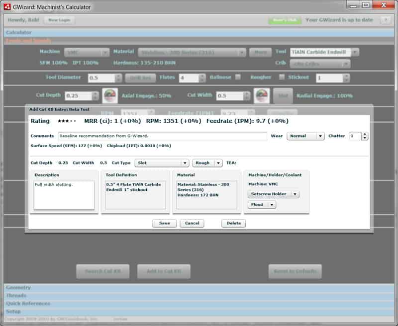

When you press “Add…”, you’ll get a popup like this:
Adding an entry to the Cut KB
Adding a Cut KB Entry…
While the information covered on the Feeds and Speeds tab may not be edited in the popup, a number of new pieces of information are there that are designed to help you do a better job describing the results of the cut as well as the conditions.
For results you get to specify:
– A rating from 0 to 5 stars. This is your subjective rating of the usefulness of the cut. The example shows three stars. Just click on the slot for the number of stars you want to assign.
– A comment. I’m saying that this cut was run with the vanilla recommendation from G-Wizard.
– An assessment of the wear on the tool. Possible values include “Normal”, “Poor”, “Chipped”, and “Broken”. If you try a cut that is problematic due to wear of some kind, be sure to document and save these cuts in your KB as well so you can avoid them in future.
– An assessment of any chatter encountered with a rating from 0 (None) to 5 (Bad). Chatter is a reproducible phenomenon and Cut KB is an excellent tool to help you master chatter.

Let’s say you’re sitting in front of your CAM program and you want to use the Cut KB to determine the best possible feeds and speeds for a particular operation. Your first step is to enter all the relevant parameters for the cut in the Feeds and Speeds tab. Next, press the “Search Cut KB” button to see what’s available.

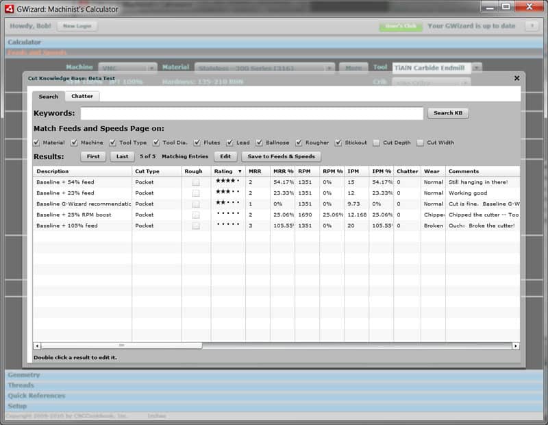

Let’s say we’re trying to do some pocketing in stainless steel with a 1/2″ TiAlN 4 Flute endmill. After entering the various parameters in Feeds and Speeds, we press the “Search Cut KB” button and up comes the result of our search:
G-Wizard Cut KB Search
The Cut KB entries that match the Feeds and Speeds parameters…
G-Wizard goes out to the Cut KB and retrieves the entries that match based on any keywords you enter together with matching the values from feeds and speeds that are checked off in the check boxes. In this case, 5 cuts had been recorded in the KB for us to consider. Clicking the rating column lets us rank them by star ratings. The best cut achieved an MRR 54% better than the G-Wizard recommendation and was achieved by bumping up the feedrate 54%. You can see there were two failed experiments shown at the bottom of the list (no stars!) as well. In one case, bumping the rpm’s resulted in a chipped cutter. In the other we went too far with the feedrate and broke the cutter.
Note, these numbers are simulated. You have to do real experiments on your machine or there are just too many variables that are unknown. That’s the power of the Cut KB–it’s all about helping you control more variables to achieve greater cutting performance.
