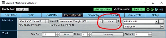

To access the Materials Database, click the "More" button just to the right of the Material menu:
Gray background with white text and icons, featuring the "More" button from CNCCookbook.com.
The "More" button accesses the Materials Database and is located just right of the Material menu...

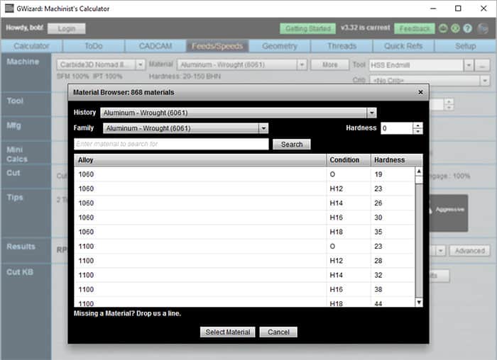

Once you click the "More" button, the Material Browser pops up showing you all of the different materials that are available:
A screenshot of CNCCookbook.com's Material Database table displaying various materials with properties such as hardness and yield strength.
Once you click the "More" button, the Material Browser pops up showing you all of the different materials that are available...
Once it comes up, you can navigate to your material in a variety of ways.
Scroll Through the List by Family
When the Material DB first comes up, you can scroll through the list to find materials in the currently selected family. That's the family shown in the "Family" drop down. It's set to whatever was on the Material Menu, but you can change it at will. When you do so, you'll get the list of materials that goes with whatever family you choose.
Search for a Material
Don't know what family your material belongs with? No problem. Jus tuse the Search box to find it. Type in the name of the material and click the "Search" button. The family containing that material will be selected and you can scroll to find your specific material.
Use the History List to Choose Materials You've Recently Used
As you use the Material DB, your most recent choices are kept on the History list. You can use it to quickly find the materials you've accessed the most often.
What's the Hardness for?
If you need a particular alloy or condition that you know should be in a Material Family, but it's not there, you can enter the Brinell Hardness in the hardness box to adjust the Feeds and Speeds for your material.
