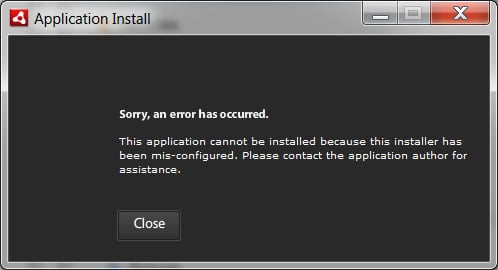

It says, “The Installer has been misconfigured”, what now?
If you see this message:
installer misconfigured
It means you first have to uninstall the application from your control panel and then try installing again. For Macs, delete the application by moving it to trash from the Applications folder.
It does this because the application was installed previously and the new version has a newer digital security certificate that is incompatible with the older one. Why they felt it was helpful to present this message for that problem is hard to understand, but that’s what it is.
Note: Sometimes you uninstall the application and you still get this message. Every time this has happened we’ve traced it to another copy of the application, sometimes on a backup disk that isn’t even mounted. So, you will need to be thorough about tracking down the old ones.

This error may occur during installation if the user has turned off User Account Control (UAC) operating system feature and is a standard or restricted user. From Control Panel, Open UAC and enable it. A reboot maybe required, once complete, re-try the installation.
Does the avatar app run now? If not, we’re going to have to go to Adobe tech support to figure out why. Before you do that, try doing the Adobe AIR install using an alternate browser. Firefox is especially compatible with most things and is less finicky than Microsoft Internet Explorer. Here is Adobe’s AIR Troubleshooting page with their specific hints for each machine type.
In fact, I had one customer overcome their problem by simply trying the whole G-Wizard install (AIR + GWizard) in the Firefox browser instead of Internet Explorer. If you have Firefox installed, this is very easy to try. Just bring up Firefox, go to the Install Page (Calculator InstallEditor Install), and try again.
I get the message, “Another application is already being installed.”
Try the cure suggested in this Adobe thread: https://forums.adobe.com/thread/864569
