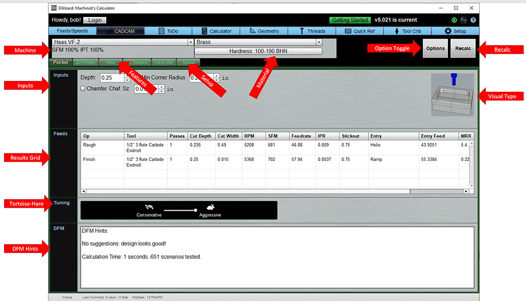

Anatomy of a CADCAM Wizard
The UI of CADCAM Wizards change based on what type of feature you're machining.  For example, the UI for machining a pocket is different from 2D Profiling or machining a hole.  Also, the list of wizards available changes depending on whether you have selected a Mill/Router or Lathe machine.
But, the general layout of each wizard is the same.  Here's a CADCAM Wizard for Pockets with the basic areas labeled:
Machine Shop Interface with input fields and calculation options.
Here's the function of each area labeled with a red arrow:

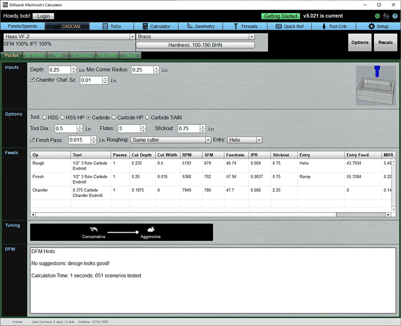

Pocket
Machining computer program screenshot with tools and settings.
Inputs
Depth:  The maximum depth of the pocket.
Min Corner Radius:  The smallest inside corner radius of the pocket.  This radius limits the maximum size of a finishing tool because it has to fit into that corner radius.
Chamfer:  Click to add a chamfer pass.
Chamfer Size:  Determines how wide the Chamfer will be.
Options
There are options to override the tool the CADCAM Wizard will select.
Finish pass determines whether there will be a finish pass and how much finish allowance to leave.
Roughing is the roughing strategy.  See what those strategies are above.
Entry is the type of entry that will be used.  Choices are plunge, helix, and ramp.  Helix is the most gentle, followed by ramp, and plunge is least gentle.

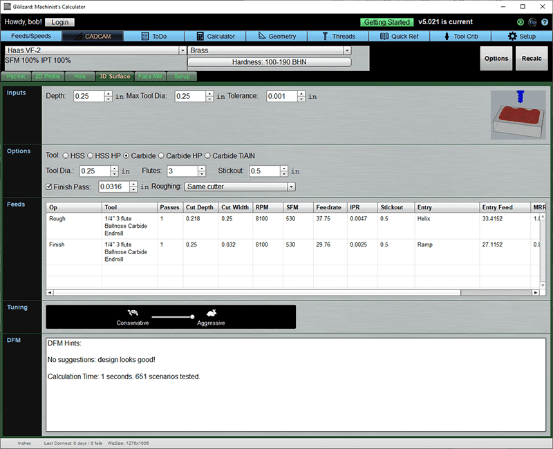

3D Surface
CAM software interface generating G-code for machine tools.
Inputs
Depth:  The maximum depth to be profiled after all passes.
Max Tool Dia is the largest tool that will fit into the tightest nooks and crannies of the 3D surface.
Tolerance is the maximum scallop height allowed after machining is complete.
Options

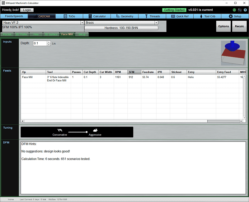

Face Mill
Computer program user interface with input fields, dropdown menus, and buttons for configuring settings and running simulations in a machining application.
Note that the diameter and flutes of the Face Mill are taken from the Setup parameters.
Inputs
Depth:  The maximum depth to be taken off after all passes.

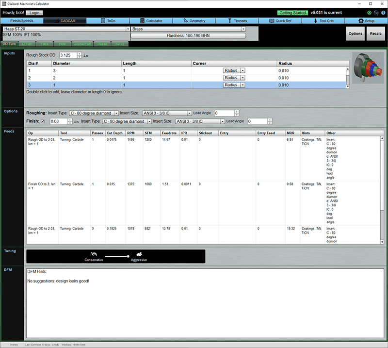

OD Turn
Computer software application screenshot for machining or metal fabrication.
Inputs
Rough Stock OD is the max OD of the rough stock to be turned.
The Input grid lists OD diameters to be turned from left to right.  The first entry is the leftmost, in other words.  Leaves diameters 0 when you have no more to turn.  Diameters must decrease as you go down the list.
You enter the length that each segment of that diameter will be.  In addition, you can enter a corner treatment to either radius or chamfer the corner.  The Radius column tells the radius of the corner radius or the width of the chamfer.
Options
Options allow you to override the insert type specified in the Turning Options on the Setup tab.  They also allow a lead angle, whether or not to have a finish pass, and the insert and lead angle for the finishing tool.

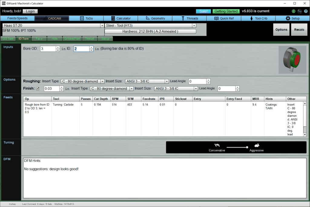

ID Turn
Computer screen displaying machining software with menu bar and tabs for inputs, options, and tuning.
Inputs
Bore ID is the diameter of the initial hole we are starting from.  Bore OD is the finished bore diameter.
Options
