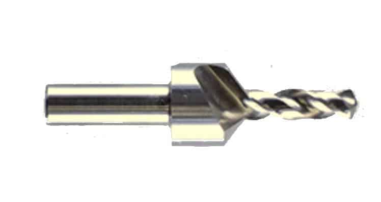

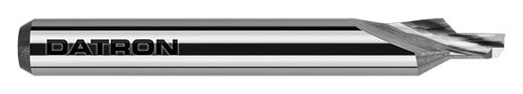

Combination Tools for Drilling and Chamfering
Combination tools save time by putting more than one function on the same tool.  This avoids a tool change to access two tools.  Whether you plan to interpolate a hole or drill it, you can get combination tools that have a countersink for chamfering on the same tool:
DATRON combination cutting tool with milling and countersinking features.
Combination single flute end mill and countersink...
Silver drill bit with spiral flute and square drive.
Combination twist drill and countersink...
Of course it's important that the hole depth requirements be compatible with the tool.  For example, a blind hole may not be deep enough to allow the combination countersink and twist drill to work.

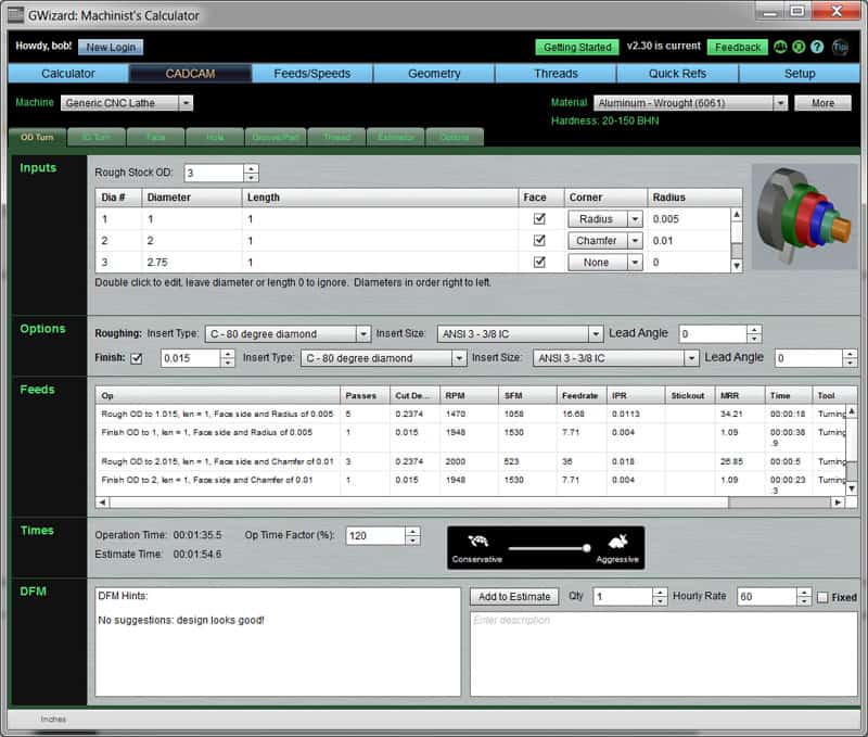

Conversational Chamfering for Lathes with G-Wizard Editor
Our G-Wizard Editor software included Conversational Programming, which made it easy to chamfer the edges when a series of OD's (Outer Diameters) are being cut:
Machining, metal fabrication, metrology, and CNC resources.
Note how the "Corner" column near the graphic had options to treat the corner with a Radius (Fillet), Chamfer, or leave it alone.

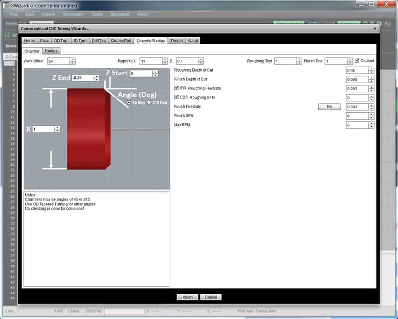

If you needed even greater control, there was the Conversational Chamfer Wizard:
Screenshot of Conversational CNC Turning Wizards software interface.

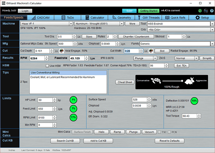

Chamfer Feeds and Speeds
Here's how we figured Chamfer Mill Feeds and Speeds with G-Wizard Calculator:
Step 1:  Choose Machine and Material
As you would for any Feeds and Speeds calculation, setup your machine and material first.

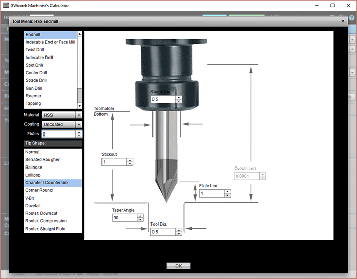

Step 2: Choose the Right Tool
Chamfer Mills are a sub-type of Endmills.  So, you clicked the tool selector, chose "Endmill" at top, set the material, coatings, and flutes, then chose "Chamfer/Countersink" from the Tip Shape menu.
CNCCookbook.com tool menu screenshot, white background, black and grey menu.

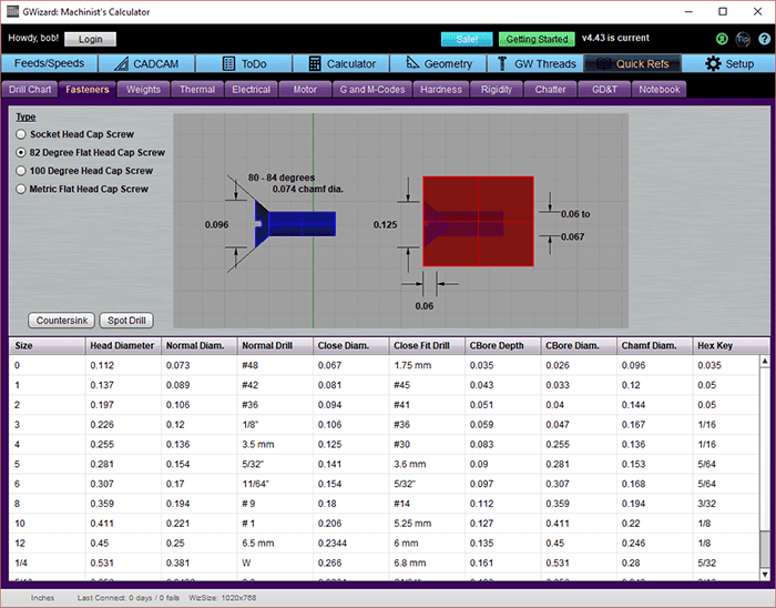

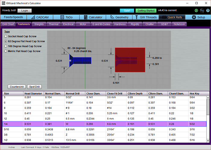

Step 3: Use the Chamfer Depth Calculator or Fastener Database to find your Cut Depth and Cut Width
Suppose I'm cutting the chamfer on a 1/4" Flat Head Cap Screw.  The Fastener Database says I need a counterbore depth of 0.161", Chamfer Diameter of 0.280" and an 82 degree angle counterbore:
Machining and metal fabrication table with graph and measurements.
Step 4:  Read Off Your Feeds and Speeds
From that information, G-Wizard gave me the Feeds and Speeds to use:
A computer screenshot showing a gray website background with various machining-related toolbars and settings.
Pretty easy stuff, right?
