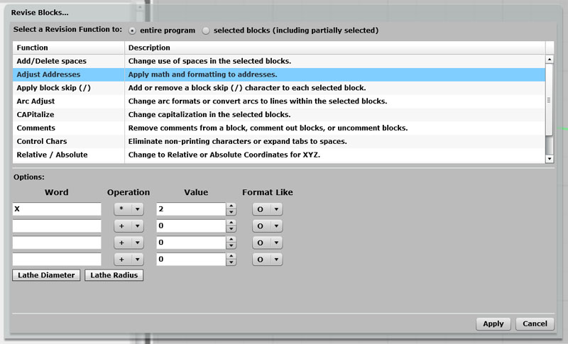

G-Wizard Editor has a revision command that lets you change programs back and forth between diameter and radius mode:
Lathe diameter mode
Lathe diameter mode is simple: multiply all the X’s by 2…
As you can see, it ain’t rocket science–we use the Adjust Addresses Revision to multiply all the X’s by 2.
Some machines may also have the ability to change between radius and diameter mode using special g-codes. You can set whether GW Editor defaults to radius or diameter in the post too.

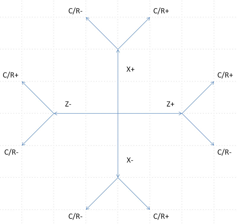

When facing and turning at 90 degrees to one another, you’ll get very sharp edges. It’s very common for drawings to specify that these edges are to be broken with a chamfer or radius. Many controls provide a feature for just that purpose called automatic chamfer and automatic corner rounding. Once you get used to it, it’s a very handy feature to have, but it takes a little getting used to how to set it up. I prefer to use “C” or “R” rather than I and K, so that’s what I will explain here. We’ll use this little chart:
G01 Chamfer Corner Round
To use the automatic corner break feature, the G01 must move in only one axis–X or Z. Using the chart, choose which axis is moving and in what direction. For each axis and direction, there are two possible chamfers (or corner radii). Choose the one you want and that tells you the sign of the value. The “radius” is the amount of the value. Use the “C” word for a chamfer and the “R” word for a radius.
Let’s try an example. Say we are moving up in X (so X+) and on our next move we’ll go left in Z (Z-). Looking at the chart, we go up (X+) and then we want the “C/R-” branch. So, to give a chamfer, we use C-0.05 for an 0.05″ chamfer. For a radius, we use R-0.05 for an 0.05 radius.
Here’s another trick: if you’re programming in GWE, just try out positive first and you can see whether it goes the right way. Switch to negative if it doesn’t. That lets you dispense with the chart.

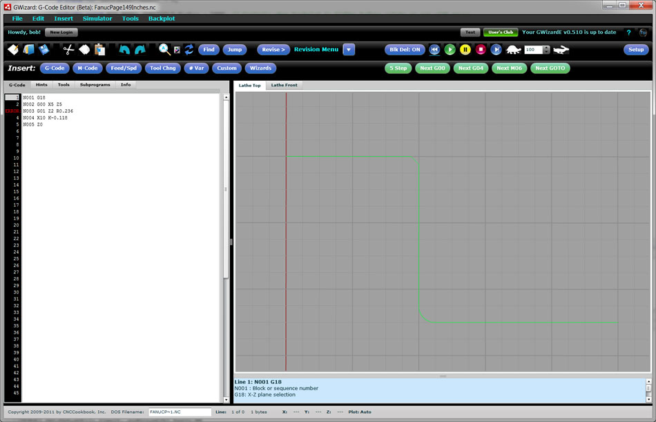

Okay, let’s go over the example from the top of page screen shot. Here’s the g-code:
N001 G18
N002 G00 X5 Z5
N003 G01 Z2 R0.236
N004 X10 C-0.118
N005 Z0

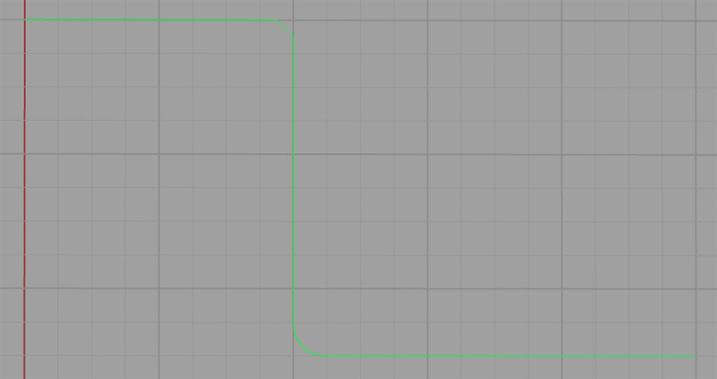

And here is the backplot from GWE:
Chamfer Corner Round Backplot Example
G01 Automatic Chamfer and Corner Rounding Example…
Line N003 is a move purely in Z from right to left. We want to put a clockwise arc in with radius 0.236. Looking at the diagram, that means we want a positive R, so we use R0.236.
Next up is a chamfer at line N004. In this case, the chart tells us we need a negative “C”, so we use C-0.118. Each side of the triangle with chamfer as hypotenuse is 0.118″.
