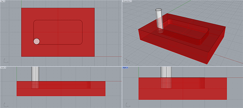

In this example and the next I will show how to carve out the same figure, a rectangular, using both absolute and relvative coordinates. Let’s start with GCode G90 Absolute coordinates.
Given a 6″ wide by 4″ tall by 1″ thick piece of material, we want to cut a pocket that is inset 1″ from the edges using a 1/2″ end mill. Here’s a drawing of our part:
Here’s our part…
Okay, and here is some sample gcode:
; We assume the cutter is somewhere a safe distance above the part so that we can rapid.
G90 ; Make sure we are in gcode G90 absolute coordinate mode.
G00 ; Use rapids speed.
X1.25 Y1.25 ; Absolute coordinates right above the corner
G01 ; Use cutting feedrate (actual feedrate and spindle rpm gcodes are not shown
Z-0.5 ; Plunge to bottom of pocket
; Now we go around the pocket counter-clockwise so we are climb milling
X4.75
Y2.75
X1.25
Y1.25
; Not going to show all the moves to clear the pocket, but we’ve just gone around the perimeter using absolute moves.
The resulting moves look like this:

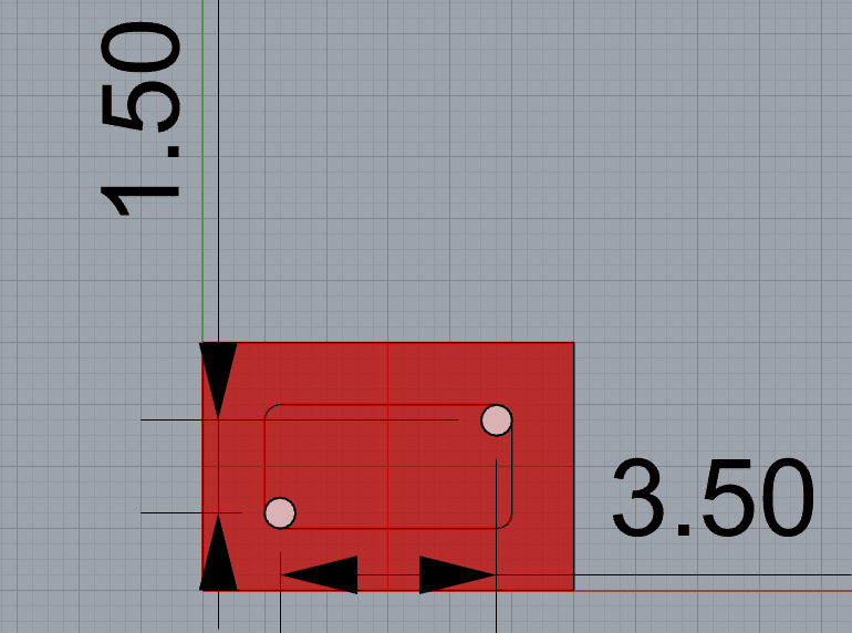

G91 GCode Relative Programming Example
Let’s try it again with relative moves. Here’s our gcode:
G90 ; Make sure we are in gcode G90 absolute coordinate mode. We don’t know where the cutter is, so we use absolute to make sure.
Z0.0
G91 ; Now we know exactly where we are, so switch to relative coordinates.
X3.5
Y1.5
X3.5
Y-1.5
Dimensions are always handy when figuring relative moves:

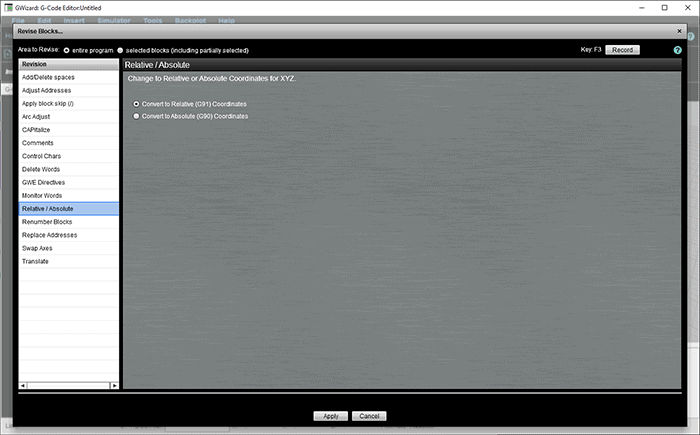

Use G-Wizard Editor to Convert Between Absolute and Relative Coordinates
It can be a tedious and error prone process to convert a bunch of g-code from absolute to relative or vice versa, but it’s easy if you have software to do it automatically. Turns out G-Wizard Editor has a command that does this conversion for you.
Under Tools Revision, there is a Relative / Absolute command that makes it super easy:
You can either convert the whole program or a block of lines you’ve selected.
