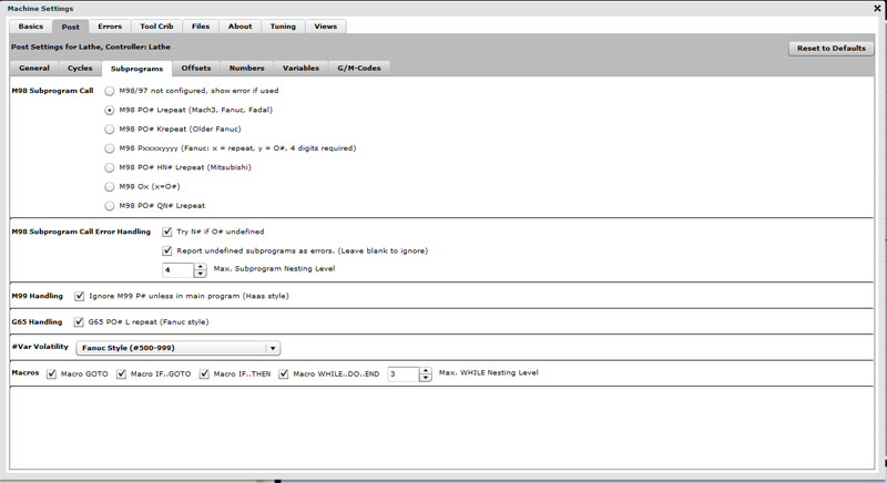

Subprogram Call Syntax
Depending on your controller, there are a number of different syntaxes available for Subprogram calls. Here is G-Wizard CNC Simulator and Editor’s screen for setting up your controller’s syntax:
M98 M99 g-code cnc subprogram
Subprogram and Macro Call Syntax…
While there are a lot of different styles, they’re mostly just slightly different ways of saying the same things:
– Where do I find the subprogram? There is a word (most often the “P” word) that provides the address. That address is typically an “O” word, but many controllers have the option of looking for an “N” word if the O# is not found.
– What about a repeat? It is often convenient to code a repeat on the subprogram in the same line using a different word. For example “L” may tell how many times to call the subprogram before finally continuing to the next line.
– How deeply can I nest subprograms and macros? Your program can call a subprogram, which can call another subprogram, yada, yada. How many levels deep are allowed? Controllers have a limit to this.
– G65 G-Code is a Macro Call, whereas M98 G-Code is a Subprogram Call. More on macro calls in a minute.
– Some controllers allow the M99 G-Code to return to a particular line instead of just returning to where the subprogram was called. I don’t find this to be a good practice because it is confusing. If you wanted to “goto” a line there is a macro “GOTO” for that purpose, but not all controllers have it.
That’s about it. Not so bad. For now, just focus on calling subprograms and returning from them.

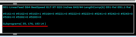

A Stack Trace for Fanuc Macro Subprograms when G-Code Programming
Recently, I was working through a complex g-code program to find and fix some bugs in G-Wizard Editor. Trying to understand what the heck somebody else’s program is doing and whether or not my own g-code simulator was properly simulating the program often leads to helpful ideas for tools that make G-Code programming easier for everyone. For example, it got me to add the ability to make the simulator run until it hits the next macro command that would cause a branch to some location other than the next line of g-code. This is a really handy way to buzz through programs going from one subprogram to the next, and it corresponds to similar commands in debuggers and simulators for other computer languages.
This time around, I had a program that had lots of subprograms all madly calling around to make a bunch of holes and then thread mill them with NPT threads using helical interpretation. The subprograms were quite clever in how they used the “L” word to repeat the helix 4 times for 90 degree moves to complete each turn, and then 9 more times to get 9 threads milled. But man, there sure were a lot of different little subprograms all calling each other, sometimes with “L” repeats and sometimes not. I was getting lost and found myself wishing for another tool that’s commonly available for other computer languages besides g-code. That tool is called a “stack trace”. It basically shows “who called who”. Here is the newly implemented stack trace for GWE:
G-Code Stack Trace
Stack trace is underlined in red…
It’s a simple little tool. The list of numbers are the line numbers of the different callers. So we can see the following:
– At line 35, the first subprogram was called.
– Within that subprogram, at line 176, another subprogram was called.
– Within that subprogram, at line 183, a third subprogram was called, and this one has a repeat factor of “4”.
This particular g-code part program nested down 4 levels and at one point had two different repeat counts going. I told you it was complicated. This little display made it tremendously easier to keep track of what was going on. The “L” numbers count down as each repeat cycle is executed as well.
If you like to write these sorts of macro subprograms in your g-code, you’ll want to have this tool in your arsenal to help you follow what the part program is doing when you simulate it.
