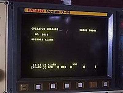

Spindle alarm on a Fanuc controller...
Many times more subtle errors can cause a part program to alarm out on the machine. For example, most machines will send an alarm and stop the part program if they encounter an arc command where the distance from each endpoint to the center of the arc differs by too much. The alarm is sent because it's clear that there must've been a mistake of some kind made.
A good simulator can check for all sorts of Machine Alarm Errors so you aren't scratching your head wondering what's gone wrong in the middle of running the program on a machine.
Some error checking is more along the lines of a sanity check. For example, a simulator might check whether a tool was selected and spindle rpms and feedrate were selected before feed motion occurs.

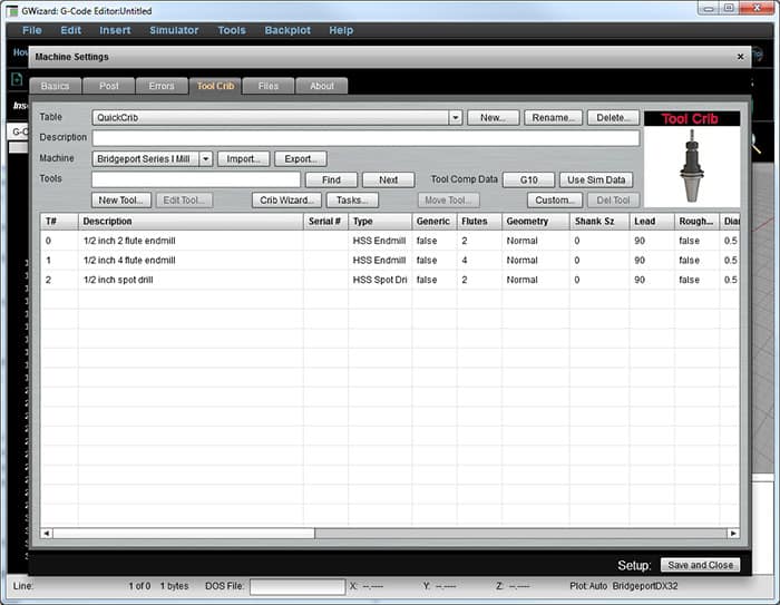

Check Tool List
Deliverable: Setup Sheet Tool List confirmed to match Part Program
Tool Crib display in G-Wizard Editor...
A good simulator will generate a list of the tools used by the G-code program. This list should be compared to the list in your Setup Sheet to make sure that they agree. Make sure all the same tools used by the program are in the Setup Sheet and that they have the same tool numbers so the right tools are selected from the Tool Changer.

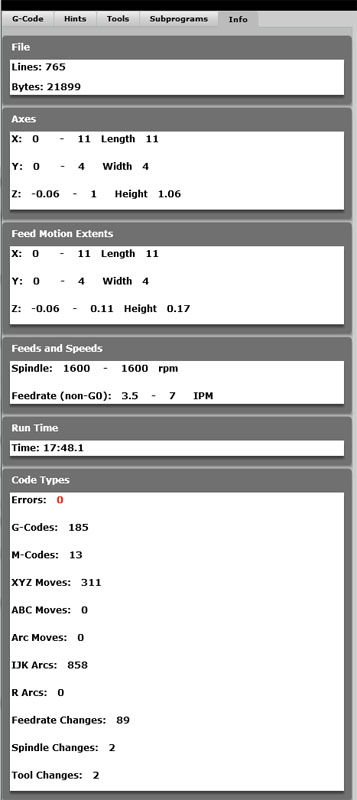

Check Overall Program Stats
Deliverable: Overall Program Stats checked against expectations for the program.
Simulators often have stat sheets that show the overall statistics for a part program. Such statistics include:
- Extent of travels in each axis
- Running time for the program
- etc..
Making a quick read of the statistics to be sure they're in line with expectations is always a good idea.

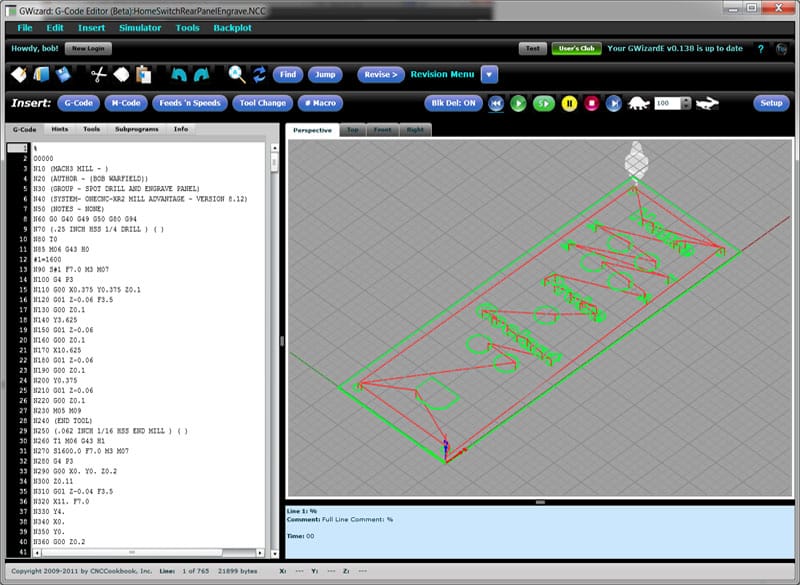

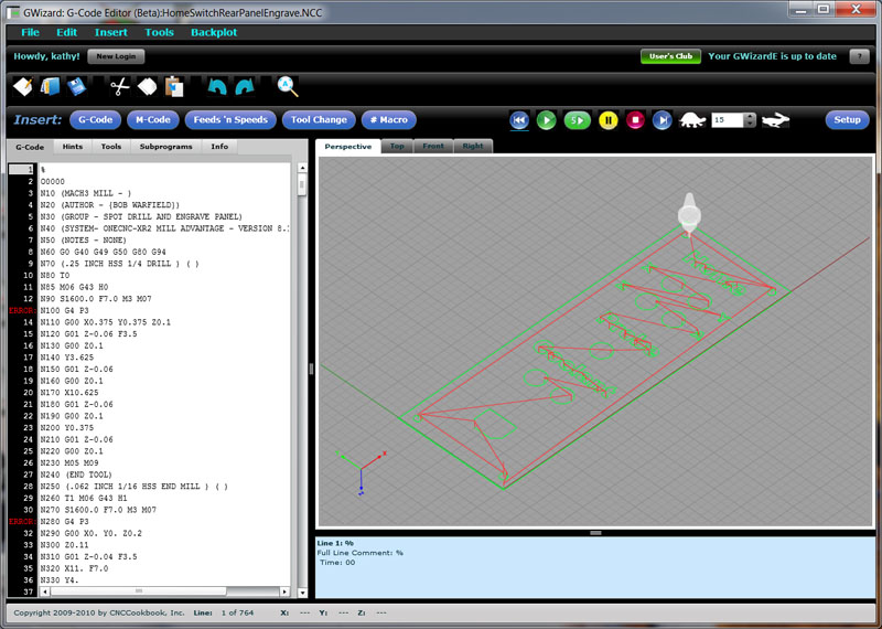

What is a G-code Simulator?
Think of a G-code Simulator (or cnc simulator if you prefer) as a piece of software that can execute G-code programs, but instead of controlling servo motors and a spindle on a machine, a G-code simulator produces a graphical display of what the machine would do. That graphical display is often referred to as a backplot. It shows the toolpath your cutter will follow if the G-code program is executed. Here is a backplot produced by the G-code simulator that was built into G-Wizard G-code Editor:
The CNC Backplot is the graphical display on the right...
In this particular G-code program, we're doing some engraving for an electrical panel that's part of a CNC controller I put together.

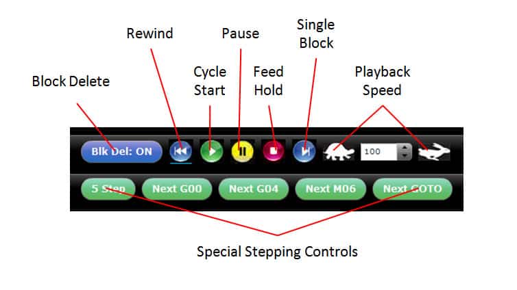

Single Stepping to Understand G-code Better
A good simulator can do a lot more than just display a backplot; it can run through the program step by step and show you a great deal of information about what's going on. In G-Wizard Editor, a set of buttons similar to what is found on your CNC was used to control the simulation:
To start a simulation, press the "Rewind" followed by "Cycle Start". You can control playback speed as a percentage of maximum with the Playback Speed controls. The Tortoise makes it run slow, the Hare makes it run fast and you can change the percentage as well. If you want to step through block by block, turn on the "Single Block" button. It will turn red to signify it is active. To exit the simulator and show only the finished Backplot, just press "Feed Hold".
Using these controls you can go through your program block by block. The "Special Stepping Controls" give you the ability to move ahead to points of interest more quickly:
- "5-Step" causes 5 blocks at a time to execute in Single Block mode instead of just one at a time. You can change the number of blocks this button will execute via the Simulator Options menu.
- "Next G00" moves the simulation ahead to the next G00. Often a G-code program will alternate between cutting moves and G00 moves to position for the next cut, so this is a convenient way to move forward.
- "Next G04" moves the simulator ahead to the next Dwell (G04). Why is that helpful? Dwells can be inserted almost anywhere in a program without causing a problem, so insert a Dwell in a place you want to be able to go to easily while debugging your program and use this button to get there quickly.
- "Next M06" moves the simulator ahead to the next Toolchange.
- "Next GOTO" moves the simulator ahead to the next place where the program jumps to a subroutine or block number. It's handy if you're trying to debug macros.

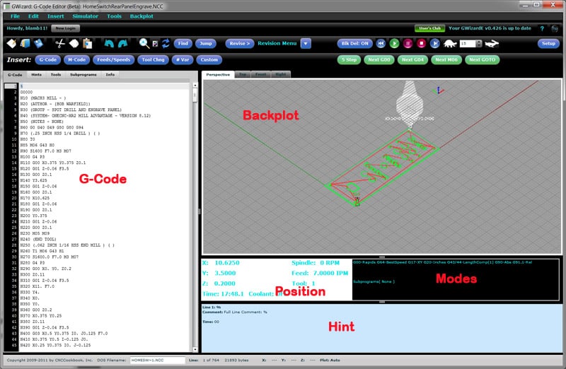

Simulator Screen Areas
When the Simulator was running, G-Wizard Editor displayed quite a lot of additional information in a variety of screen areas:
Each screen area is called out in the illustration above in red. Here is the function of each:
G-code
This area shows you the G-code. The line being executed is highlighted. The illustration shows the very top line highlighted. If you clicked on this pane, G-Wizard Editor would offer to stop the simulation so you can edit the code.
Backplot
This shows you the backplot of the moves made up to the currently executing line.
Position
Position is like the position display on your machine controller. It's showing you the X, Y, and Z coordinates, the Spindle RPM, the Feedrate, the current Tool, the Coolant status, and the time the program has run.
Modes
Modes tells you all the modal states of the controller. For example, is some work offset active? It also tells you the last few #variables that changed and what the values were that they changed to.

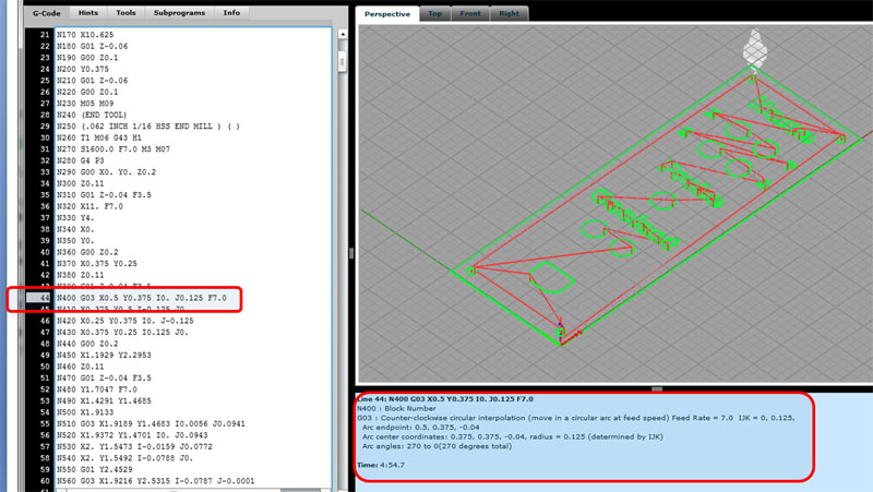

Hints: Data on Individual Lines
G-Wizard Editor had a unique feature called "Hints". Every line has a hint that is displayed below the backplot when the cursor is on that line. You can also select the "Hints" tab and see the G-code replaced by a series of Hints. Hints are simply an English-language description of what the G-code does. They often include a lot of extra information that may not be obvious even to an expert just looking at the G-code. Here is a typical example of a Hint for a line containing an arc:

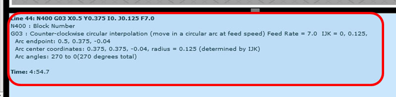

Line N400 has an arc. The Hint below the backplot tells all...
We haven't learned arcs yet, but the line is as follows:
N400 G03 X0.5 Y0.375 I0. J0.125 F7.0
The fact we don't yet know how arcs work makes the Hint even more valuable. Let's take a close look at the Hint:
The Hint for an Arc...
It tells us the following:
- In bold at the top is the original text of the line. This is useful if we're in Hints view and can't see the G-code line text.
Right below the bold, it starts telling us all about what the line does:
- The Block Number is N400
- G03 performs Counter-clockwise circular interpolation. In other words, it tells the machine to move the cutter in a circular arc at feed speed.
- The Feed Rate was set to 7.0 on this line.
- We see what the IJK values parse to be. In this case, we have I=0, J=0.125, and no K
- The endpoint of the arc after the move is 0.5, 0.375, -0.04
- The coordinates of the center of the arc are 0.375, 0.375, -0.04.
- The center was determined by IJK (as opposed to R, which is another way)
- The angle of the arc runs from 270 degrees to 0, a total of 270 degrees.
After all that, the Hint skips a line and gives us a time. This is telling us how long it will take the G-code program to reach this line and finish it if we execute on the machine. In this case, we can see the arc will be completed 4 minutes and 54.7 seconds after the program starts executing.
Phew, that's a lot of data spewed forth, but it can be extremely handy to have when you're trying to figure out what a G-code program is doing or what's wrong with one. And, like I said, it's hard for an expert to tell all of this stuff at a glance.

Overall Program Information
In addition to detailed specific information on each G-code line, G-Wizard Editor also provided useful overall information about the program. It had an "Info" tab that held the overall information. Take a look at the illustration to the right to see what the Info tab looks like. As you can see, it tells you a variety of information about your G-code program including:
- It's size both in terms of lines and bytes. If you're trying to make your program fit in the limited RAM memory available to an older controller, it's important to be able to tell quickly how you're doing.
- For each axis, G-Wizard Editor spelled out the range of motion used as well as the length, width, and height these ranges imply. You get the information both overall and in terms of just feedrate motion. The rapids will nearly always extend outside the feedrate envelope, but the feedrate envelope may give you a good idea of the rough stock size needed by the program.
- You get to see the range of spindle rpm's used as well as the range of feedrates used in the program.
- You get to see the overall predicted run time of the program.
- Lastly, there is a count of the different classes of operations within the program, as well as a count of the number of errors G-Wizard Editor discovered in your program.

4 More Reasons CAM Users Need a G-code Editor & Simulator
I get asked this question a lot:
Why would I need a G-code Editor Simulator when I’ve got CAM and it has a Simulator too?
For many CNC’ers, they think CAM means they’ll never need or want to deal with G-code. So why would they ever consider having a G-code Editor / Simulator? Wouldn’t it be redundant?
Honestly, to me that’s like asking why I’d need bacon if I already have eggs for my breakfast. The two really do go together extremely well (eggs and bacon or CAM and G-code Editors–both go well together!).
We have run a survey for a long time that asks CNC’ers what their knowledge of G-code is, and here are the results:
Look how few CNC’ers can’t really work much with G-code…
Most CNC’ers discover that if you’re going to be into CNC, you owe it to yourself to pick up a decent grasp of G-code. It really is useful and fun.
We've talked at length above about how to use a G-code Simulator to verify your G-code is correct before it goes on your CNC Machine. Here are 4 more reasons CAM Users need a G-code Simulator:
#1 - Making Little Fine Tuning Changes Much Faster than you can with CADCAM
Fine tuning your G-code can make a big difference…
Lots of times you get the G-code from CAM on the machine, and as you’re running it, there can be little changes you’d like to make. Change a tool number, adjust feeds and speeds, and so on. You could go all the way back through the CADCAM cycle to do that, or you could use a G-code editor to make these kinds of fine tuning changes quickly and easily.
Some kinds of fine tuning are hard to impossible to do in CAM too. Those programs can be pretty stubborn about how they want to generate a toolpath given some geometry from a CAD model.
G-code editing gives you total control. Maybe you just need to change a retract motion a little bit to clear a clamp, for example. Or, slowdown that one certain point on the tool path that always lets out a sharp chatter squeal without having to slow everything else down.
Another great example of little changes is all the little tweaks that come up when you’re debugging a new production program or have a problem in the middle of the program you need to recover from.
Suppose the program is set up to run 8 parts at a time, and the endmill breaks after 5 parts have run. Do you rerun the whole thing and just let it cut air for the first 5 parts to finish up the remaining three? That’s really slow and painful. With a few minor tweaks to the G-code, you can run exactly what needs to be run and skip the rest.
That kind of situation comes up all the time during production. But, it also comes up constantly when making one-offs. In fact, it’s even more likely because you don’t have the luxury of perfecting the program across lots of parts. You need it to work for just one part. So, when things go awry, how do you rework things without constantly going back into CADCAM, a very slow process?
Or, let’s go the other way. Is it easier to lay 8 parts out on a fixture and CADCAM all of that, or just let the CADCAM deal with 1 part and use a little G-code programming to do the rest? The answer is, it depends on the job, but it can often be easier to use the G-code.
If you know a little G-code, you can do an amazing amount just tweaking and correcting the CAM-generated G-code.
