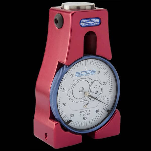

Tool Presetters are measuring arrangements that make it easy to measure the Tool Offset Data off the machine. They range from utter simplicity–a way to reliably position a tool holder on a surface plate plus a height gage–to the super sophisticated models with digital cameras, lasers, shrink fit induction heaters and probably someone makes one with an integrated espresso machine too! Here is a typical super-simple height gage arrangement from Techniks:
Techniks has a nice integrated tightening stand with surface plate so you can use a height gage as a presetter…
The simplest versions are little more than height gages with a repeatable way to secure the tooling. Such presetters are only able to accomodate Tool Length Offsets.
The next step up would provide a means of rotating the tool so that diameter measurements could be taken. Such systems typically add a precision DRO and leadscrews for motion. Here is such a system Frank Mari had looked at (MariTool doesn’t seem to sell it though):
Glass scale DRO, leadscrew adjustment, dial indicators, and rotating taper holder…
For diameter, rotate to maximum reading on the dial indicator, turn the leadscrew to zero the indicator, and read the diameter off the glass scale…

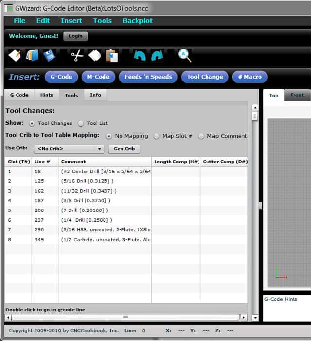

Step 1: Determine What Tooling is Needed by the G-Code Program
The Tools View scans your g-code program and makes a list of which tools are being used both by T# and by identifying comments if they are available…

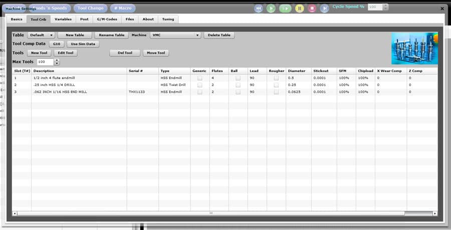

Step 2: Map the Tools Called for by the G-Code Program to Real Tooling in the Tool Crib
You can see by the mapping options in the screen shot above that GWE can match tools up either by T# or by matching the comments. If you’ve set your CAM program up to use a particular set of tool names that it outputs as comments, and you’ve set up your GWE Tool Crib with the same comments as tool names, you are good to go. Here is a shot of the Tool Crib:
The Tool Crib…
