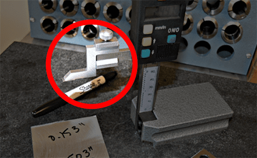

Height Gauge Scriber
Metal cutting tool with angled blade on grey surface amidst machining tools and machinery.
Most height gauges come with a scriber by default.  It makes it easy to scribe a line, particularly in layout dye, on a part at a particular height.
