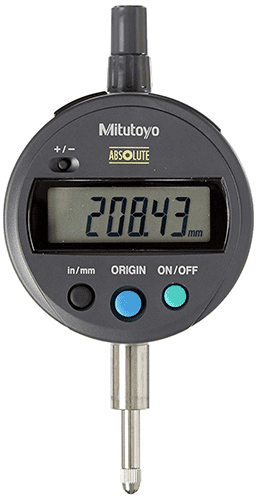

Digital Dial Indicators
A digital micrometer with grey body and black screen displaying measurement data.
Mitutoyo Digital Dial Indicator.  About $162.31 on Amazon...
Dial Indicators are available with Digital Readouts too, but most prefer the analog dial.  As mentioned, they're often used for making relative measurements, and it's harder to see relative motion with a digital readout than an analog dial.  Digital Dial Indicators are also called Electronic Indicators. An advantage they have is they're typically better at measuring small linear distances.
By definition, Electronic Indicators all have Continuous Dials.  Other than the electronic readout, Electronic Indicators are pretty similar to Dial Indicators.  Same stem diameter, and so on.
