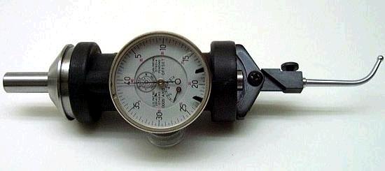

The Blake Coaxial Indicator is one of those methods left over from the days of manual machining:
A Blake Coaxial Indicator…
You stick one of these little goodies in the machine spindle, position it over the feature in question, start it spinning slowly, and adjust position until the indicator needle stops swinging. There’s an offset arm not shown in the picture that keeps the indicator facing your way. It usually takes more time to dig out your Co-ax Indicator and stick it in the machine spindle than it does to dial in the feature–they’re very convenient, in other words. If there’s a knock on them at all, it’s about their accuracy.

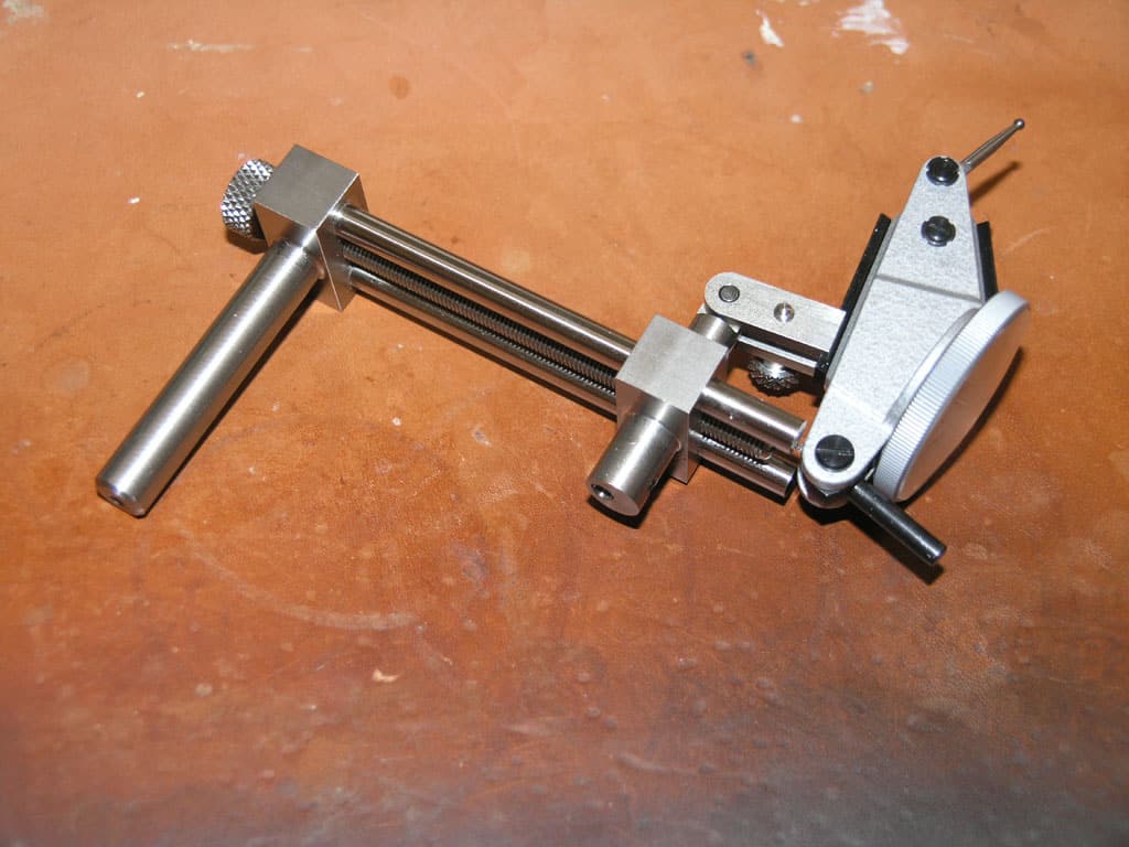

If you want to measure the feature much more accurately, most machinists reach for what is typically called a “Zero Set:”
Zero Set-Style Indicator Holder…
The one I’ve got was made for me by a fellow from CNCZone called “Widgitmaster.” It’s a beautifully made piece of work with a fine screw adjustment for diameter. You stick it in the machine spindle and you can tell when you’re centered on the feature because you rotate the DTI (Dial Test Indicator) and get no motion on the needle. With a nice Dial Test Indicator, you can measure very accurately indeed.
A coaxial indicator set should include:
- The spring loaded co-ax indicator.
- A set of probes that range from straight to curved.
- An offset arm to keep the co-ax indicator facing your way as the machine spindle rotates.
Since the co-axial indicator is a centering indicator, it is a relative reading tool, not absolute. Therefore, no calibration is needed when we switch one of the probes for another.

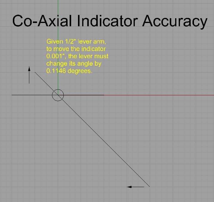

For this problem, let’s first consider the mechanism of the Co-Axial Indicator. It basically uses a probe that swings a little lever as the machine spindle rotates. That lever raises or lowers a ring, and the ring is connected to an indicator. The lever on mine is about 1/2″ long. So an important question to understand is how far must that lever move in order to move the indicator a particular distance, such as 0.001″?
Here is the geometry:
How far must the arm of a Co-ax Indicator move to make the indicator needle show 0.001″ difference?

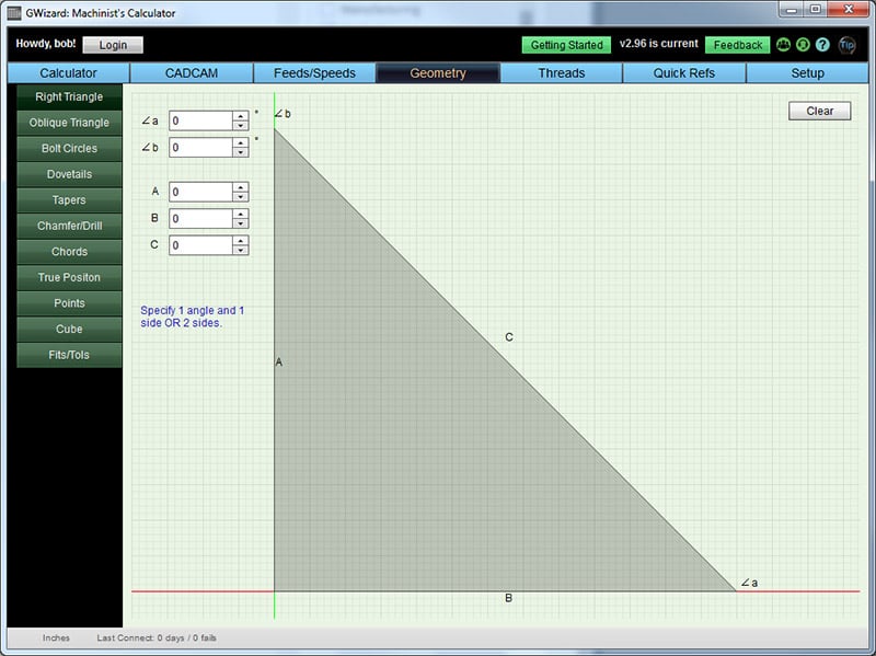

Now let’s set up the calculation in G-Wizard that produced that 0.1146 degree figure:
The Right Triangle Calculator from the G-Wizard Geometry tab…
This is an easy problem to set up. Referring to our CAD drawing, distance “A” is the 0.001″ change on the indicator. Distance “B” is the offset of the probe tip.
Here is the result:
We use the Right Triangle Geometry Calculator to find the angle…
And sure enough we can see the angle is 0.1146 for that particular deflection.
