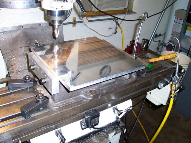

Milling Large Plates in the Kurt Vise
Kurt outside jaws vise on milling table.
Put the jaws on the outside of the Kurt vise to hold a big plate...

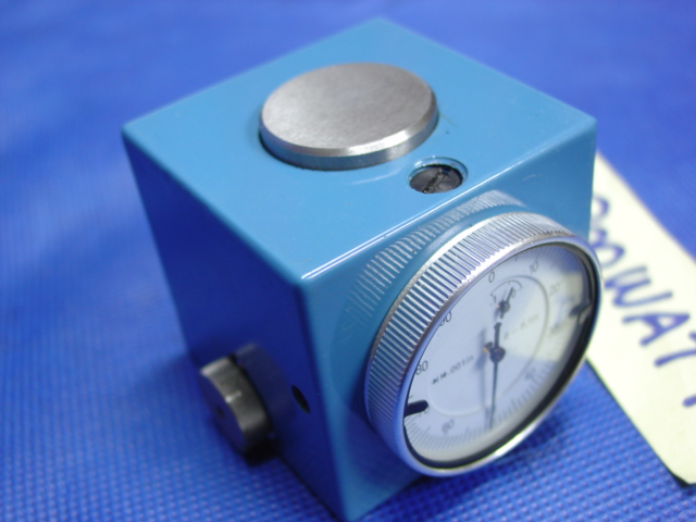

Z-axis Presetter: At this point, I thought I was done and would be using the good old paper trick.
But I had a vague recollection that finally came back to me. Did you ever by a gadget that looked like a good idea, but before it ever arrived you started doubting it would work well, stuck it up on a shelf, and never actually tried it?
I do that way too often. In this case, thing I remembered was a Z-axis Presetter I bought off eBay months ago. Search for "Z Axis Presetter" on eBay, and you'll find the ubiquitous 800watt listed Chinese machine tool gadget. They look like this:
Small blue device with silver knob and round dial for machining or metal fabrication use.
A Z-axis Presetter from eBay seller 800watt...
How does it work? Simple. There is a little knurled knob visible on the bottom left. It has a "test" and a "use" position. Set it to "test" and an internal standard swings into place so that if you press the anvil on top with your finger until you hit the stop, you'll have exactly 2" from top of anvil to bottom of gadget. You rotate the dial to zero in that position. Now reset the knob to "use", place it atop the workpiece, bring the cutter down until the needle registers, zero the needle, zero your DRO, and you should be exactly 2" above whatever the presetter is sitting on.
So, not expecting much, I plunked the sucker down atop my aluminum cube in my Kurt vise on the mill, cranked the head until the cutter almost touched. Locked the head and cranked the quill with the fine adjust until the needle zeroed, zeroed my DRO, removed the presetter, cranked down another 2" with the fine adjust, zeroed the DRO again, added 0.010" for a modest cut, ran the cube through under power feed, and hauled the block over to the surface plate to see what I had done.
The desired result was 2.396". I brought the height gage down to take a reading which was, drumroll please, 2.396"!!!!
Holy uncanny accuracy, Batman! The silly presetter actually worked, and it worked well, and even though the quill travelled 2", and I expected the worst, it came out deadly accurate!
Hooray for the gadget that actually worked. I guess I'll be using the silly thing more often. At $39, it was worth it!

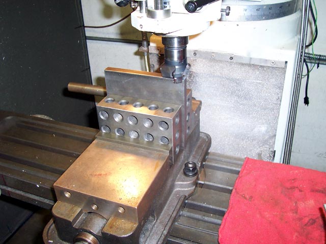

Playing With Blocks (2-4-6 Blocks, That Is)
I always look carefully when an experienced machinist is showing how he has done something. Here is the Fidgiting Widgitmaster showing how he squared a 6" x 6" plate in his vise using 2-4-6 blocks to lend support (they stick up out of the vise pretty far otherwise):
Large brass or bronze metal plate on milling machine table with vice holding it in place.
Squaring a plate in the vise with the aid of some 2-4-6 blocks for support...
I had tons of 1-2-3 blocks hanging around, but this tip got me to buy a set of 2-4-6 blocks.
