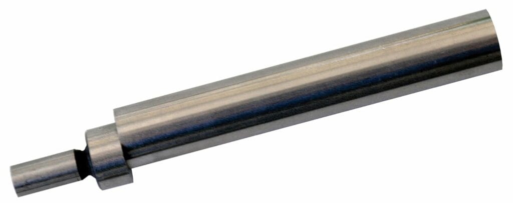

The classic method of locating features on mills is to use an edge finder. These fall into two categories–mechanical edge finders and electronic edge finders.
Here’s a typical mechanical edge finder:

Technically, the pointed contact versions are center finders. A center finders edge is whatever the tip can reliably measure. Center finders are also capable of picking up things like scribed lines. The ability to pick up scribed lines can be very handy if you’ve got a set of layout tools that involve marking up the work piece with scribed lines.
These tools can be had in a variety of body diameter–usually 0.375, 0.5, or 10mm. The choice of body diameter for your edge finder isn’t really important, just choose a body diameter that you have a toolholder for (preferably a collet-style) so you can leave it setup and ready to go.
Operating one of these isn’t obvious until you’ve learned how. This video from Tormach will walk you through it:
As you can see, its pretty easy to use edge finders and center finders to locate a work edge. Stick it in your collet or check, start the spindle moving slowly, and move the worktable until the edge finder first lines up and then “kicks”. At the point where it kicks, you know the center of the finder is one-half the diameter of the contact from the work edge.
As you can imagine, locating scribed lines with center finders is just as easy. Put the tip into the scribed line, move the worktable until it is lined up and running concentrically, then moved it slightly more until it kicks. You’ve just established a work edge on your work piece that’s inline with your scribed lines.

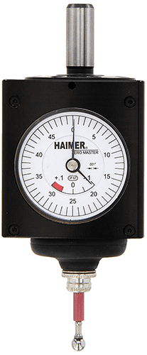

These German-made measuring devices are my favorite aside from a 3D Touch Probe for edge finding and part zero setup. They used to be called “3D Tasters”, which was such a charming name, though I am sure a mis-translation of the original German. Now you look for them as “3D Sensors.” They can be used as edge finders, center finders, and more.
Here’s the typical unit:
Haimer 3D Sensor. About $408.46 on Amazon…
They’re not inexpensive, but boy are they a time saver and a pleasure to use. They do have a less expensive “Mini” 3D Sensor:
Haimer Mini 3D Sensor. About $390.00 on Amazon…
I haven’t tried a “Mini”, but I wouldn’t hesitate because the Haimers are very well made. One thing you must remember to do is get at least 2 extra tips when you buy one. It’s only a matter of time before you break a tip:

Haimers are good for all sorts of things, so I will leave you with this video from Tormach on how to use one:
Be sure to adjust your Haimer for concentricity. The video shows how.
One thing to keep in mind–the Haimer is a larger tool than the wiggler style edge finder. It has a larger shank than the typical edge finder body diameter. You want to keep both types of tool around.

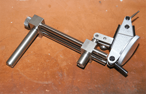

Here’s a neat DTI holder that’s designed for finding circle centers:
The radius is adjustable with the knurled wheel on the left.

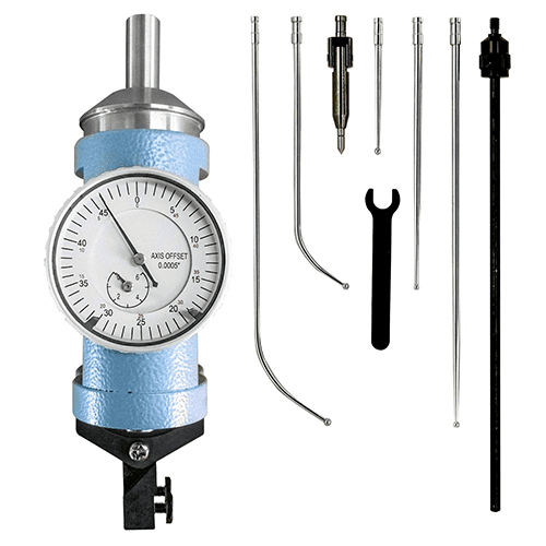

Blake Coaxial Indicator: Hole Center Finder
Coaxial Indicator. About $59.99 on Amazon…
Finding the center of bores is a common mill setup operation. It also comes in handy with lathe tool setup in certain cases. You can use a Haimer 3D Sensor for bore center, wiggler-style center finders, DTI rig similar to the above, or a Blake Coaxial Indicator.
The Blake Coax dates from manual machining days, but it is super simple to use and handy. Mine is a cheap Chinese knock-off, but it works great just the same.
Using a coaxial indicator is simplicity. Position it in the spindle over the hole, put the probe edge on the hole edge, and start the spindle rotating SLOWLY. Now adjust the X and Y handwheels until the indicator needle quits moving as much as possible.
Done! Wasn’t that quick and easy?

Think of coaxial indicators as good to maybe a few thousandths. If you need better, set up your DTI or Haimer 3D Sensor. I’ve written an article about Blake accuracy that goes into the details of what’s going on.
