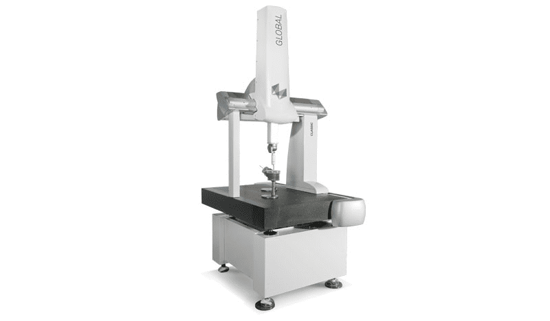

Metrology goes hand in hand with Quality Control (QC) as it is practiced in CNC manufacturing. The strict definition of Quality Control is checking to be sure that Requirements for a manufactured part have been met.
The leading system of defining these tolerances is called GD&T or Geometric Dimensioning and Tolerancing.  We offer a free course on GD&T Basics if you want to learn, get a refresher or to better understand how it works.
Metrology provides the science, techniques, and precision measuring machines that are used to determine if parts or features of parts fit within the tolerances and dimensions specified for the part.

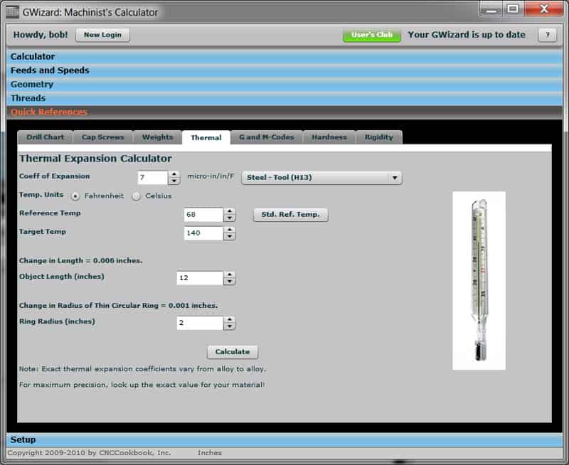

To reach the highest degrees of accuracy in measurement, Metrology may be conducted in a Metrology Lab.  The essential characteristics of a Metrology Lab are that it be temperature controlled, clean, and well organized so delicate Metrology Instruments can be well taken care of.
A Metrology Lab should be clean because contaminants can get between Metrology Instruments and the parts they are measuring to affect the measurement.  They should be temperature controlled because both parts and Metrology Instruments change size based on the temperature of a room.  The most accurate measurements are expressed in terms of a Standard Reference Temperature.
Our free Thermal Expansion Calculator can show you how much temperature can change the size of an object:
Thermally expanded metal calculator for machining.

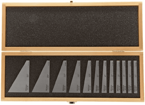

    • Angle Gages

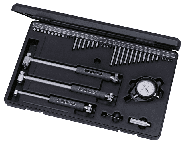

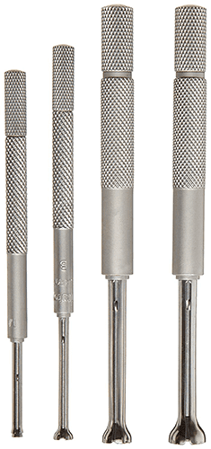

  5. Bore Measuring Tools

  4. Coordinate Measuring (CMM, CMM Machine, Coordinate Measuring Machine, Measuring Machine)
    • CMM Programming
    • CMM Inspection
    • Portable CMM / CMM Arms
    • CMM Training
    • Coordinate Measuring Machine PDF
    • CMM Metrology
    • CMM Fixtures
    • Optical CMM
    • CMM Probe

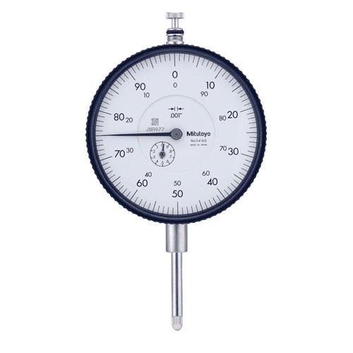

Dial Test Indicators & Dial Indicators (DTI, Dial Gauge, Digital Dial Indicator, Digital Dial Gauge)
First, what's the difference between a Dial Indicator and a Dial Test Indicator?
It's pretty simple.  The Dial Indicator has a plunger and reads how far the plunger is raised by the surface below.  The Dial Test Indicator has an arm that sweeps an angle.  It measures how far the arm is pushed sideways.  Both are handy, but you'll tend to use a Dial Test Indicator more often.
These photos should make the differences clear:
Precision instrument with white face, black trim, and silver accents featuring a dial indicator.
Mitutoyo Dial Indicator reads how far plunger moves up to nearest thousandth of an inch (0.001")...
Technical illustration of an Interapid dial indicator with precision scale.
Interapid Dial Test Indicator, Tenths Accuracy (0.0001")...
Easy Guide to Dial Indicators & Dial Test Indicators

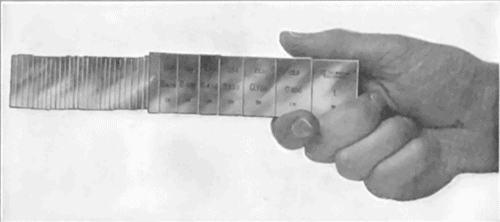

Joining gauge blocks together is a process called wringing.  The ultra-flat surfaces cling together naturally.  A normal set of 30 gauge blocks lets you take 3 blocks to make up any length from 3.000 to 3.999 mm in 0.001 mm steps (or 0.3000 to 0.3999 inches in 0.0001" steps).  That's pretty cool.
Gauge blocks are typically used as a reference for the calibration of other measurement tools.  They were invented in 1896 by Swedish machinist Carl edvard Johansson, hence the name "Jo Blocks."
Now for the weird and wonderful-we don't actually know for sure exactly how wringing holds the blocks together.  It is believed to be a combination of:
In practice, you have to wring two blocks together to feel the effect.  It's like two magnets that want to bond.  And the force is quite strong.  Here's a shot of 36 blocks wrung together and supporting their own weight:
Stainless steel ruler with engraved markings.
Gauge Blocks are typically used with two pads.  One is oiled, and the other is clean.  To wring two blocks together:
  1. Wipe the clean blocks across the oiled pad.
  2. Wipe any extra oil off on the clean pad.
  3. Slide one block perpendicularly across the other.
  4. Once the block is in the middle of its travel, rotate it so it is aligned with the other block.
After use, it is important to keep your Gauge Blocks clean of debris and contaminants, and oiled to preven corrosion.
If a block becomes dinged or damaged, it won't wring properly.  You can gently stone the nick out to restore wringability.

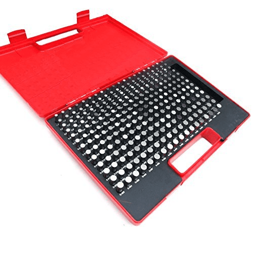

Pin Gages (Pin Gauges, Gauge Pins, Go / No-Go Gauges)
Red plastic case with hinged lid open, showing a grid of small metal tools.
HFS 250 pc 0.251" - 0.500" M2 Class ZZ Steel Pin Gauge Minus Set.  About $93.99 on Amazon...
Pin Gauges are not as handy as Gauge Blocks, but they can still come in plenty handy depending on your application. Pin Gauges are cylinders that come in precise sizes.  Typically they are used to determine the diameter of small holes.  The idea is to find the largest pin size that will drop into the hole unaided by any force but gravity.
Gauge Pins come in different grades, with the most common being Class Z.  They can be either "Plus" or "Minus" pins, and the most common are "Minus."  A Class Z Minus Pin is toleranced to be -0.0002".  So, a 1.000" Minus Pin is actually 0.9998" in diameter.
One commonly uses a "Go" "No-Go" Pin Setup.  So, for a hole that is specified as 0.150" diameter, +0.004" / -0.002" tolerance, you'd use a Go Pin of 0.152" (largest pin that can fit) and a No-Go Pin of 0.154".  If the NoGo pin fits without interference, the part is oversized.
In other words, the role of a "Go" gauge is to fit the smallest acceptable diameter, while the No-Go gauge is chosen to be large enough that it won't fit the largest acceptible diameter.  If the No-Go fits or the Go won't fit, the hole is out of tolerance.
Keep in mind that issues with Go/NoGo Pin fit may also be due to out of round or surface finish issues with the hole.

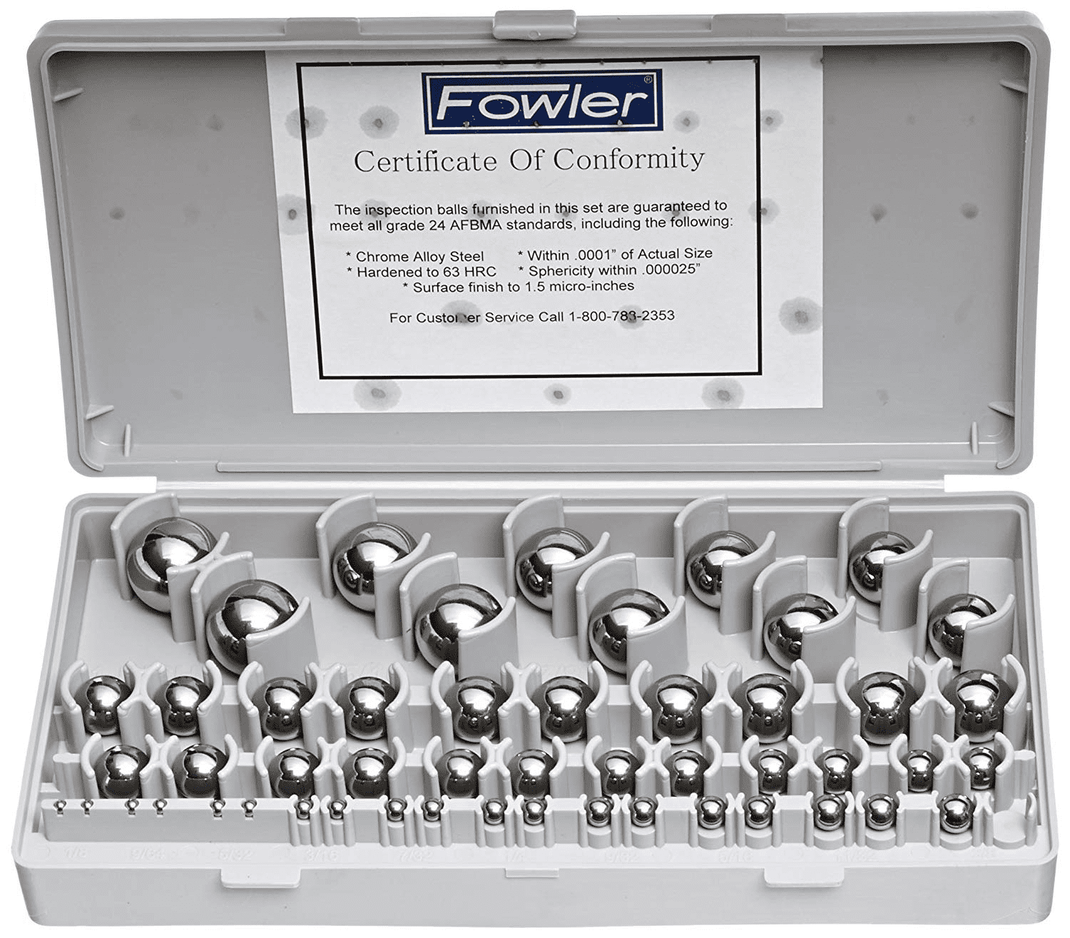

Fowler Gauge Ball Set, 52 piece.  About $71.02 on Amazon...
Gauge Balls, as the name suggests, are precision balls in specific accurately made diameters.  They're handy for a variety of applications, but typically you'll need to be a bit handy with math to use them.
For example, this diagram shows how to use a Gauge Ball to measure the major diameter of a countersink:
Ball diameter calculation formula.
For more information on Gauge Balls, be sure  to check out our dedicated article:
Ball Gage Guide [ Tips & Calculator ]

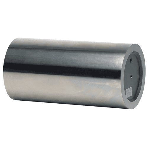

Cylindrical Square (Cylinder Square)
Cylindrical metal object with smooth, shiny surface and small hole at one end.
3" x 6" Cylindrical Square.  About $169.99 on Amazon...
For certain kinds of Metrology tasks, Cylindrical Squares are handy.  They're simply upright cylinders that are very accurately made so that when they sit flat on a surface the cylinder's circumference is truly perpendicular to that surface.  The accuracy of the 6" tall square pictured is such that the top edge is within 0.0001" of where it should be.
Cylinder Squares are typically used to check and measure squareness.  For example, you could check the squareness of an angle plate by placing it on a surface plate adjacent to a cylinder square.  If the contact is continuous for the whole contact area between the two, the angle plate is square.  Shine a light to show up any gaps and you can tell to within a tenth (0.0001") the squareness.
Another use is to have the square be a standard while we sweep an indicator up and down the square.  For example, we can check the tram of a milling machine by placing the square on the table, a DTI in the spindle, and sweeping up and down the cylinder square.

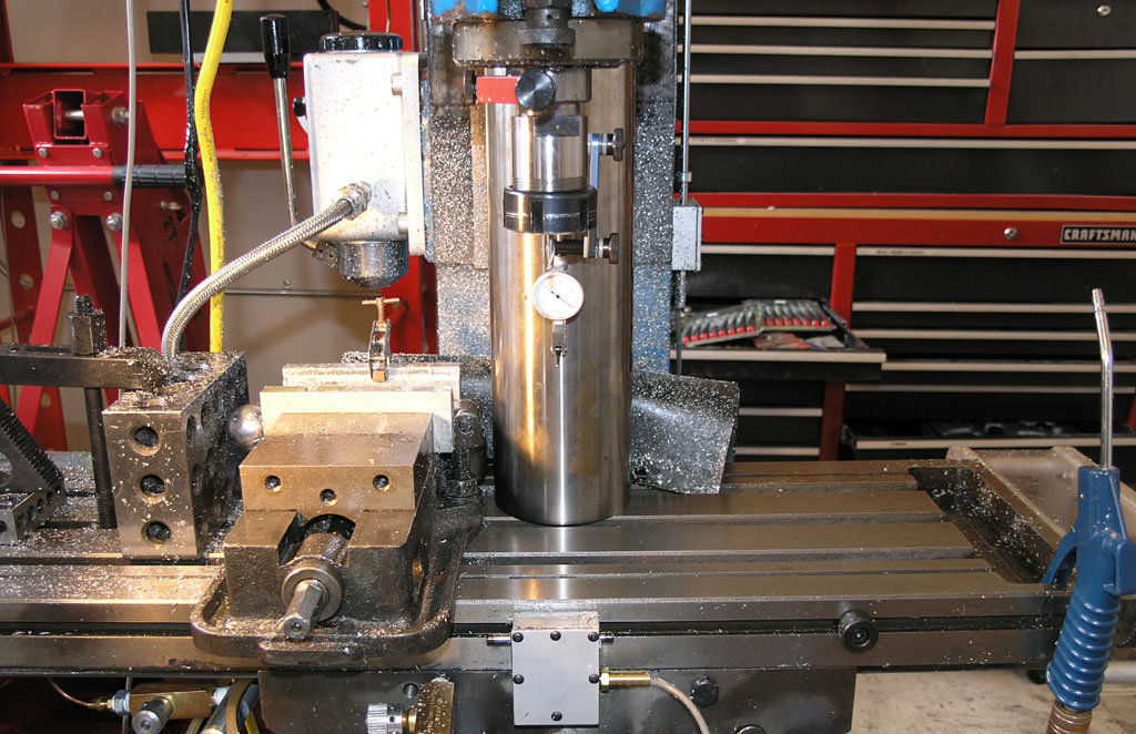

Here's a photo I took while checking squareness of a CNC Mill:
Milling machine in workshop setting with cluttered surface and industrial backdrop.
As you can see, the DTI is in the spindle, the square is flat on the table (I cleaned that area before putting the square down) and I can evaluate how well the mill is in tram by raising or lowering the Z-axis and watching the behavior of the DTI.

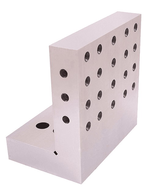

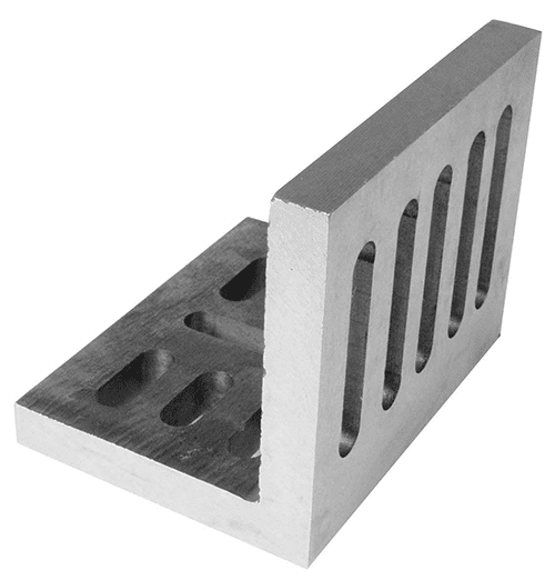

If you don't have a Cylinder Square, and I admit they are something of a luxury, your next best bet is an Angle Plate.  These are typically made of cast iron, and are more commonly used for setups than for Metrology purposes.
Using the typical cast iron angle block is pretty rough and tumble.  The plate pictured above is only rated to 0.002" per 6".  So that top edge could be 0.002" off what it should be if the angle was perfect.  That's pretty terrible for metrology purposes.
A rectangular metal workpiece with holes drilled into it.
6" x 6" Ground Angle Plate.  About $182.28 on Amazon...
They do make precision ground angle plate that are high accuracy but they're a lot more money.  Typically, they are made for grinding and other applications requiring high accuracy.  The one pictured above is accurate to 0.0002" at the top edge.  That's about twice the cylinder square, but way better than the cheaper angle plate.
You can, of course, buy higher quality angle plates for more money than either of the models pictured here.

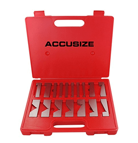

Suppose you want to setup a part quickly in your machinist vise, but it needs to be cocked at a particular angle and not square?
Try some Precision Angle Blocks.  They're the equivalent of Gauge Blocks for setting angles.  Pretty nifty, eh?
Of the two versions shown, I prefer the top style just because I can more easily stack to make up different angles.

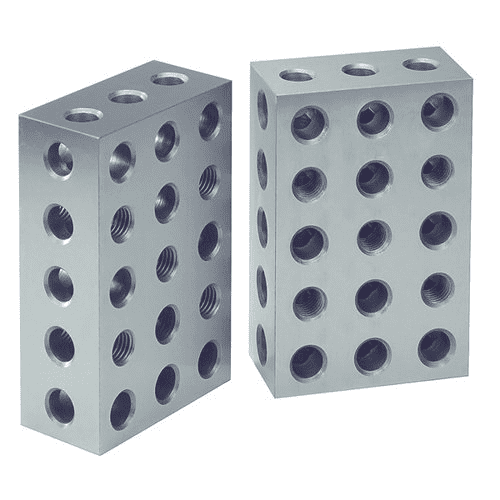

1-2-3 Blocks and 2-4-6 Blocks
Rectangular metal block with evenly spaced circular holes.
Precision ground 2-4-6 blocks.  About $99.99 on Amazon...
So you don't have a Cylinder Square or an Angle Plate that's accurately made enough to work.  How to get things square?  Your last avenue is to use your 1-2-3 or 2-4-6 Blocks.  If they're accurately made, they should be square.  The ones pictured above are spec'd to be within 0.00024", which is not bad.  If it were me, I am buying a nice set of 2-4-6 blocks before any cylinder squares, angle plates, or precision angle blocks.  They're just so darned useful for various setups.
Tip:  Have you got a friend with a surface plate and cylinder square?  Haul your angle plates, 1-2-3 blocks, and 2-4-6 blocks over and check their squareness.   You may be very pleasantly surprised at how good they are.  And if not, at least you'll know!

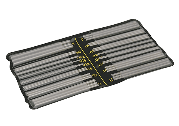

Feeler Gauges.  You probably came across them for the first time as an aid to setting spark plug gaps when working on your car.  But, they're also viable metrology tools for measuring very small gaps.

Telescoping Hole Gages (Snap Gages)
Precision tools with threaded ends and knurled handles.
Mitutoyo Telescoping Gage Set for 1/2" to 6" holes.  About $152.99 on Amazon...

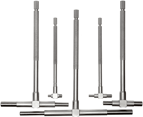

A set of Telescoping Gages is one of the first bore measuring tools most CNC'ers acquire.  The Mitutoyo set I have featured above is more expensive than what most machinists purchase, but there is a method to the madness.  You see, it takes a fair bit of touch and technique to use Telescoping Gages successfully.  Having a nicer set of Gages helps, because they have better feel, though you will still need to practice your technique until it is accurate and repeatable.
Telescoping Gage Accuracy
If you know what you're doing, and it takes a ton of practice, you can measure measure bore diameters to within a few tenths.  Read on to be sure you understand what it takes to master these gadgets.
How to Use Telescoping Gages
The idea behind Telescoping Gages is you insert them into the bore.  The bore causes them to retract, then you withdraw them and measure the end to end distance between the contact points with a micrometer.  The end of the handle has a knurled knob that controls a lock.
Sounds easy, right?  Except you've got to make the measurement while keeping the Gages across a true diameter and not cocked in any way.  In practice, this is done with a sort of rocking motion and simultaneous use of the lock.
I refer you to one of Suburban Tool's excellent videos to see just how it's done:
Ideally, get a few different bores to play with whose size you know very accurately.  Try working the feel with your eyes closed until you can get repeatable accurate measurements.

Dial Bore Gauges (dial bore gage)
If I left you with the impression that telescoping gages can be difficult to use consistently, good because it's true.  So what do you do if you want an easier, albeit much more expensive method of measuring bores?
Commonly the answer is to use a Dial Bore Gauge.  Here's a beautiful (if costly) Mitutoyo Dial Bore Gauge set:
A comprehensive tool set for metrology or precision measurement, featuring a dial test indicator, straight-edge rulers, vernier caliper, micrometer, and measuring pins.
Mitutoyo Dial Bore Gauge Set, 0.7" to 6" range.  About $875.14 on Amazon...
In practice, you set the dial bore gauge up with the correct anvils and other attachment for your bore's size, insert it in the bore, and gently rock it to get the maximum reading of the diameter.
Dial Bore Gauge Accuracy
Good dial bore gauges are accurate to perhaps a few tenths, and they're faster and require much less touch than telescoping gages.

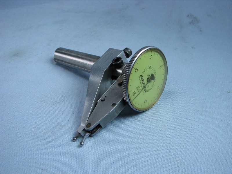

Indi-Calipers
These are a great shopmade tool for accurately measuring bores:
Dial indicator gauge for precise machining and manufacturing measurements.
I've written an article about Indi-Calipers with more details, but the idea is pretty simple.  You've got two adjustable points with one end being a DTI.  Adjust to the nearest reference (for example using a mic), the read off the difference on the DTI when you probe the bore with the Indi-Caliper.
Simple, accurate, and relatively inexpensive compared to Dial Bore Gauges.

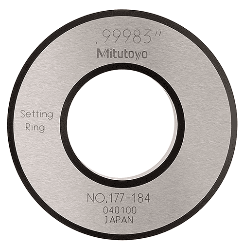

Ring Gages (outside gages)
Engraved silver ring with black trim and text labels featuring Setting Ring and NO.177-184 040100 JAPAN.
Mitutoyo Ring Gage, 1.000", +/- 0.00004".  About $192 on Amazon...
Ring Gauges are useful for measuring diameters and for calibrating ID bore measurement tools.  They're often the "gold standard" for such calibration, in fact.

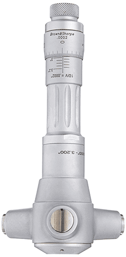

Hole Micrometer (Brown & Sharpe Intrimik, Mitutoyo Holtest, Fowler Holemike, Tubular Inside Micrometer, Bore Gage)
Precision caliper with cylindrical body and flat head, featuring measurement markings.
Brown & Sharpe Intrimik Inside Micrometer, 2.8-3.2" Range.  About $277.10 on Amazon.
Inside Micrometers come in a variety of styles and tradenames.  Pictured is one of the classics, a Brown & Sharpe Intrimik.  It has 3 measuring anvils that meet the bore, so it is less susceptible to the types of errors caused by 2 point measuring instruments.
Some 3-point mics also space the mics asymmetrically, such as the Etalon brand.  The purpose of this is to allow multiple readings to determine the roundness of the bore.
Many prefer a Dial Bore Gauge to these inside mics, because the measurement is affected less by heat transfer from the hand holding the instrument.  They do make clamp on handles for these mics to minimize the heat transfer.  A good 3-point inside micrometer with the handle is typically a bit more accurate than a dial bore gauge.
Tip:  It's a good practice to use an outside mic to verify the measurement of an inside mic assuming you have a diametral reading and not a 3-point inside mic.

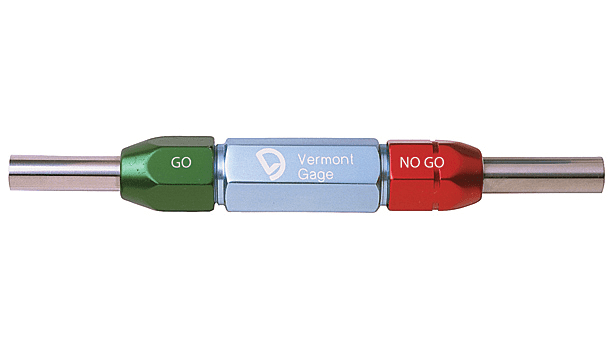

We talked a bit about Go No-Go Gauges in the section on pin gauges where we described how to use pin gauges for Go No-Go.  For convenience, we gave this example:
For a hole that is specified as 0.150″ diameter, +0.004″ / -0.002″ tolerance, you’d use a Go Pin of 0.152″ (largest pin that can fit) and a NoGo Pin of 0.154″.  If the NoGo pin fits without interference, the part is oversized.
In other words, the role of a “Go” gauge is to fit the smallest acceptable diameter, while the NoGo gauge is chosen to be large enough that it won’t fit the largest acceptible diameter.  If the NoGo fits or the Go won’t fit, the hole is out of tolerance.
Here's another style of Go No-Go Gauge that one frequently sees in machine shops:
Tool gauge with green, blue, and red measuring ends.
Note how the pins are kept together and the "Go" and "No Go" ends are clearly marked and color coded.

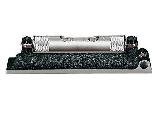

Machinists Levels (Precision Levels)
Most machinery works better if it is leveled when installed.  The preferred tool for leveling is a machinist's level, and there are both old-style and new digital tools available.
Here's the slick digital version:
Digital level with smartphone app for machining precision.
Digi-Pas Digital Level.  About $239 on Amazon...
Note how it even has a phone app to assist.
And here is the old-fashioned analog precision level from Starrett:
Silver and black metal device with two knobs and central opening.
Starrett 6" Precision Level.  About $131 on Amazon...
I own a Starrett level like that and have used it to level all of my CNC Machines.  It works great, but clearly the digital version has a lot more bells and whistles for not a lot more money.  If the digital level had been available when I bought the Starrett years ago, I probably would've gone digital.  If nothing else, the digital protractor function of the digital level would sure be handy a lot of times.

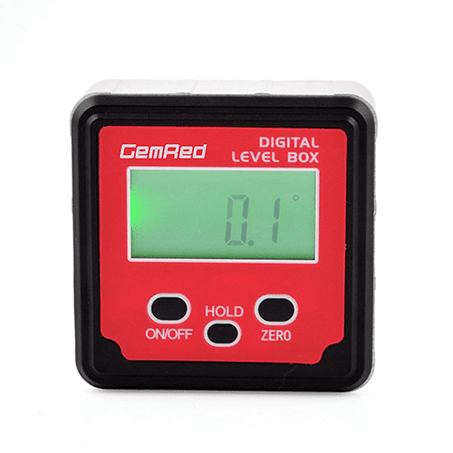

Digital Protractor (Inclinometer)
Speaking of Digital Protractors, they're readily available, and yes, I've got a cheap one that I use from time to time.  Mine is similar to this model:
Digital level box with red faceplate and green LCD display.
GemRad Digital Protractor and Inclinometer.  About $25.99 on Amazon...
These inexpensive inclinometers are handy, but I don't know how much I trust their accuracy versus a unit made for the machinist market like the Digi-Pas.

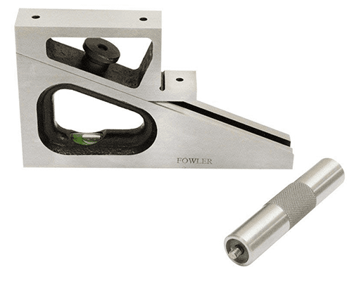

Sine Bar, Sine Plate & Sine Vise
We give the Sine Bar, Sine Plate, and Sine Vise a special place in angle measurement because they're used both for measuring and for fixturing when specific angles other than 90 degrees are important to make a part correctly.
Here's a typical Sine Bar:
Rectangular metal part with three circular holes.
Fowler Sine Bar.  About $145 on Amazon...
We've put together a complete guide to Sine Bars, Sine Plates, and Sine Vises for you.  It even includes a free Sine Bar Calculator:

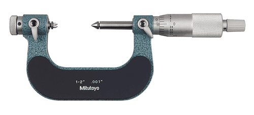

Screw Thread Micrometer
It should come as no surprise that screw threads are fickle beasts that take lots of measurements requiring a degree of precision.  The cheap method is to use 3 wires.  The more convenient and probably more accurate method is to use a Screw Thread Micrometer:
Micrometer caliper with black handle and silver body.
Screw Thread Micrometers have interchangeable tips because they have to match the angle of threads.

Imagine a CNC-style machine capable of making extremely precise measurements in a highly automated way.  That’s what CMM Machines do!
Precision instrument with flat base and vertical post.
Hexagon Global Classic CMM, a typical coordinate measurement machine…
CMM stands for “Coordinate Measuring Machine”.  They’re perhaps the ultimate 3D measuring devices in terms of their combination of overall flexibility, accuracy, and speed.
Check out our Complete Guide to Coordinate Measuring Machines for much more on these powerful metrology tools.
