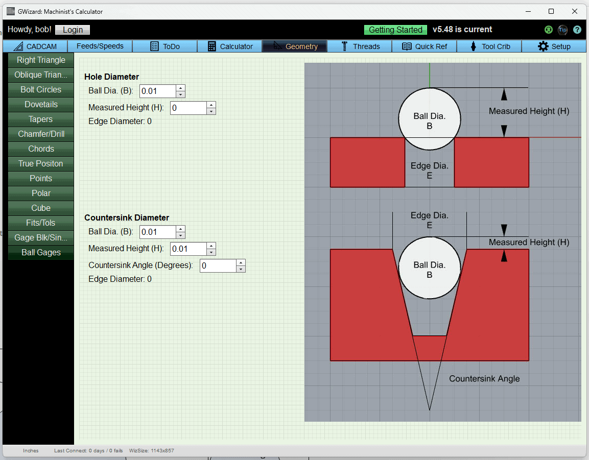

Ball Gage Calculator in G-Wizard
That last countersink example was one of two ball gage calculators that were included with the G-Wizard Machinist's Calculator. It looked like this:
A computer screen displaying CNCCookbook.com with calculator for machining calculations.
The Calculator was dead simple to use. You entered the Ball dia, measured height, and if using the countersink calculator the angle, and the resulting diameter at the edge was displayed.

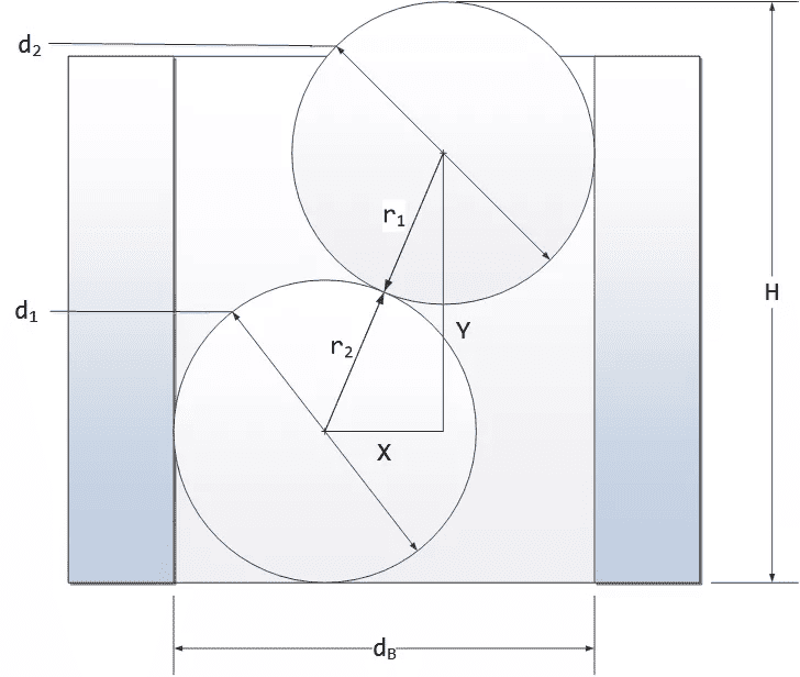

One can also use Gage Balls to measure the diameter of a bore like this:
Technical diagram featuring two circles with labeled radii.
Mathematical equation for calculating cylinder bore diameter on white background.
Bore diameter example courtesy of Math Encounters Blog…

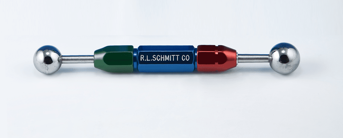

Ball Plug Gages
Loose precision balls can be a pain to manage.  If your application allows, ball plug gages are often more convenient:
Two metal balls on a rod, color-coded green/blue and red/blue with "R.L.SCHM" label.
A typical go/no-go ball plug gage...
Ball Plug Gages simplify handling by introducing a handle, and they also typically come in go / no-go pairs of gage balls.
