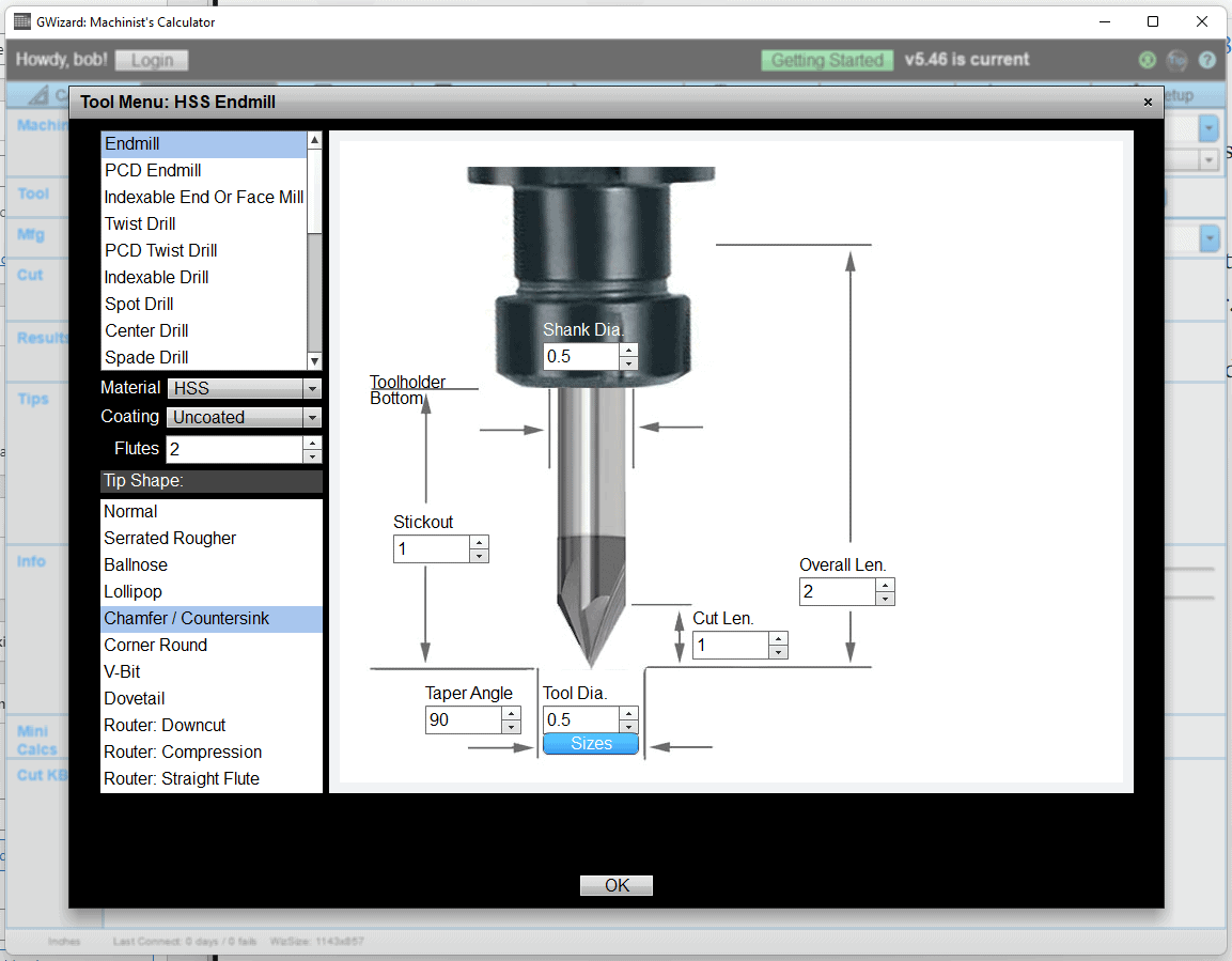

Use the same units (inch or mm) for every field. For a pointed countersink, tip depth = (diameter ÷ 2) ÷ tan(angle ÷ 2). If your countersink or chamfer mill has a flat or rounded tip, touch off on the surface and use the depth below the hole edge instead, or subtract the tip's offset. The countersink diameter must be less than the tool's diameter.
This calculator makes no assumptions about your countersink diameter (tool diameter). You must make sure the chamfer diameter is always less than the countersink's diameter.

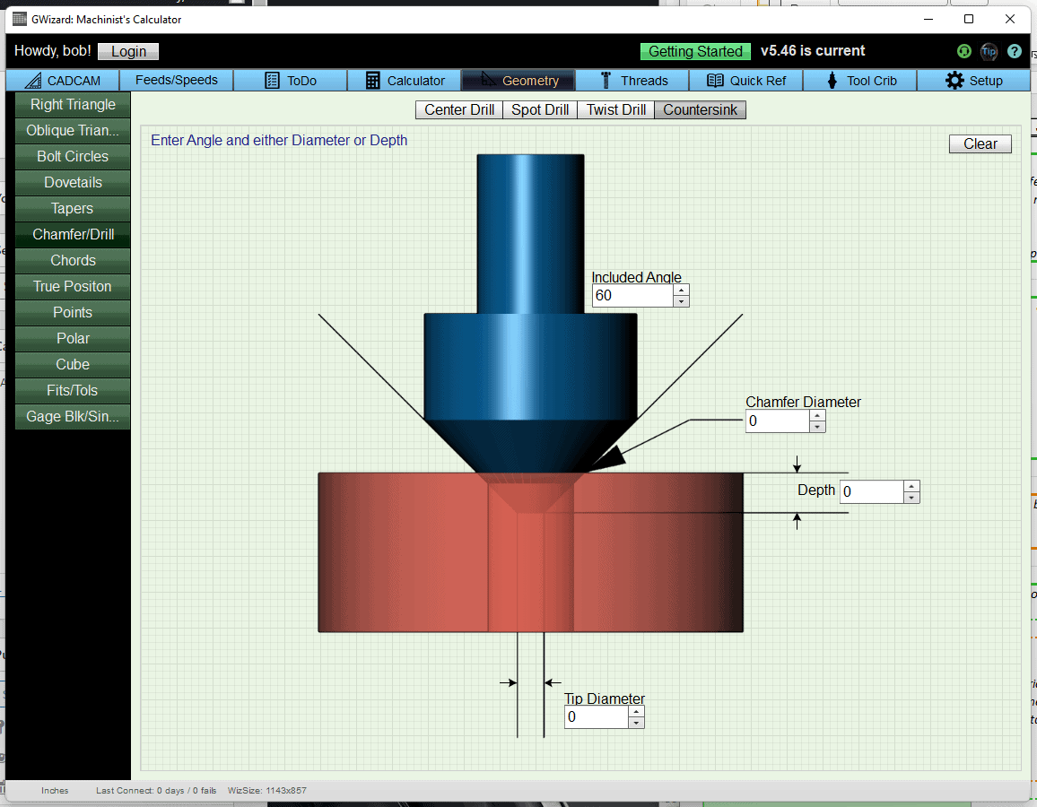

A countersink is a cone, so the depth and diameter are related by the countersink's angle:
Depth = (Countersink Diameter / 2) / tan(Angle / 2)
For example, an 82 degree countersink that's 0.500" across at the surface needs the tool tip 0.250 / tan(41) = 0.2876" below the surface. That's the Z depth to program when you touch the tool's point off on the top of the part.
If the hole is already drilled, the countersink only cuts between the hole edge and the surface. For a 0.257" hole, the chamfer is (0.500 - 0.257) / 2 = 0.1215" wide on each side and 0.1215 / tan(41) = 0.1398" deep.

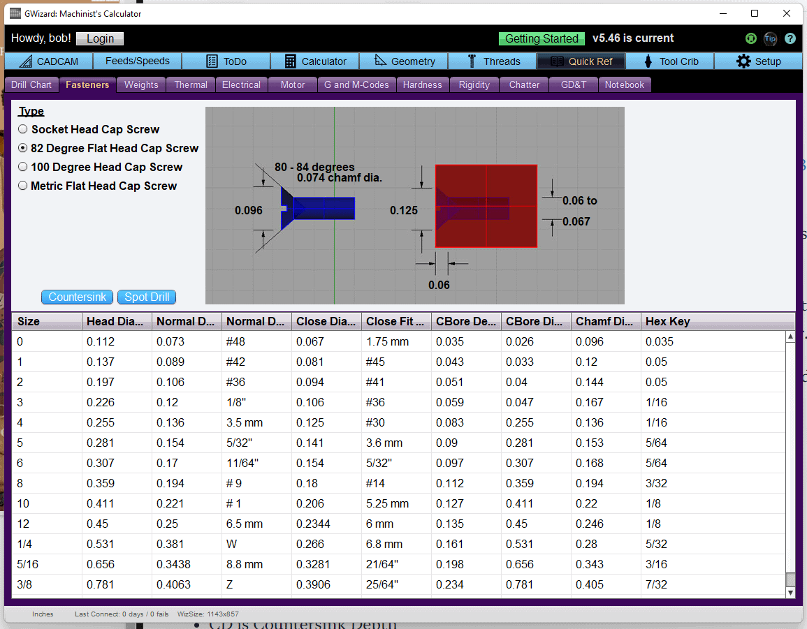

- 82 degrees: inch flat head screws, including flat head socket cap screws.
- 90 degrees: metric flat head screws, and the usual angle for chamfering hole edges.
- 100 degrees: flush rivets and screws in sheet metal and aircraft work.
- 60 degrees: center holes for lathe centers.
- 118 and 120 degrees: the point angles of common twist drills, handy if you're spot drilling to chamfer a hole.
Match the countersink to the screw's head angle, and look up the head diameter in the fastener maker's data so the screw sits flush.
