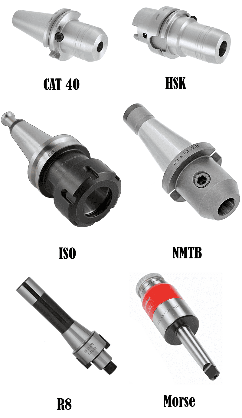

Types of Machine Tapers
A variety of machine tapers, including:
  • Morse
  • Jacobs
  • Jarno
  • Brown & Sharpe
  • HSK
  • and others
cater to diverse machining needs in the expansive world of machinery. Each type of taper has its unique application and specifications. For instance, BT tapers are used in machining centers and heavy-duty milling applications and are available in eight dimensions.

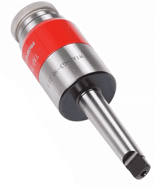

Morse Tapers: A Closer Look
A deeper exploration into the realm of tapers reveals Morse tapers, named after Stephen A. Morse. Developed in the mid-1860s, these tapers were designed for the swift and easy changing of tools within machines. Morse tapers are characterized by a typical angle of 1.49°, a key specification for identification and fitting into machine heads.
These tapers are often deployed in securing reamers, drill bits, mill holders, collets, and lathe centers.

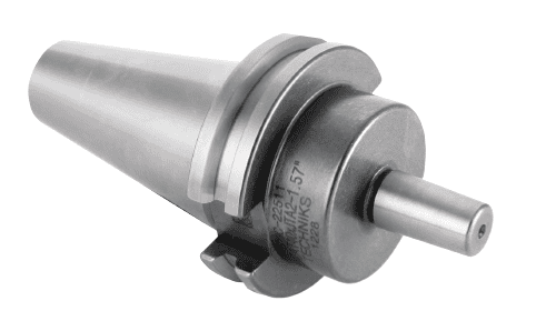

Jacobs Tapers: Features and Applications
A Jacobs taper for holding a drill chuck on a CAT taper toolholder…
Next, we focus on Jacobs tapers, which boast a unique design. Known for their self-holding feature, they can be used for light-duty applications without the need for a drawbar. Specifically designed to securely attach drill chucks to arbors, they enhance the precision of drilling operations.
These tapers are polished smooth to keep the tapers clean and dry, thereby preserving the necessary friction for their self-holding characteristic.

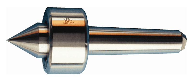

Jarno Tapers
Jarno Taper on a lathe center…
Named after Brown and Sharpe Manufacturing, Jarno tapers are characterized by their 0.60 inches per foot taper ratio. Often found in lathe machinery, they serve as headstock and tailstock spindles, and are also employed in profiling and die-sinking machines.
There are 19 standard sizes of Jarno tapers, with the larger diameter ranging from 0.25 to 2.50 inches and the smaller diameter from 0.20 to 2.00 inches.

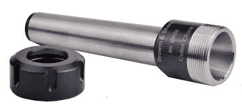

Brown and Sharpe
Brown and Sharpe taper on a collet chuck…
Much like Jarno tapers, Brown and Sharpe tapers come in a range of sizes, with the large end diameters starting as small as 0.250 inches and reaching up to 3.4271 inches for the largest size. The taper per foot for the Brown and Sharpe tapers varies, with some sizes having a taper per foot of 0.6000 inches, while others have different measurements such as 0.6246 or 0.5010 inches.
Older tooling machines, such as those used for drill bits, reamers, end mill holders, and collets, commonly utilize these tapers. Machine tool spindles are most commonly found in these types of machinery.

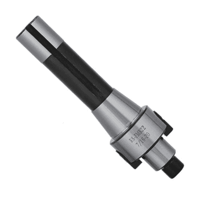

R8 Taper
Another type worth exploring is the R8 taper. Specified as 3.5 inches per foot, they are often associated with Bridgeport Machines, Inc., for milling machine applications. The correct angular conversion for an R8 taper from inches per foot is approximately 16.26 degrees.

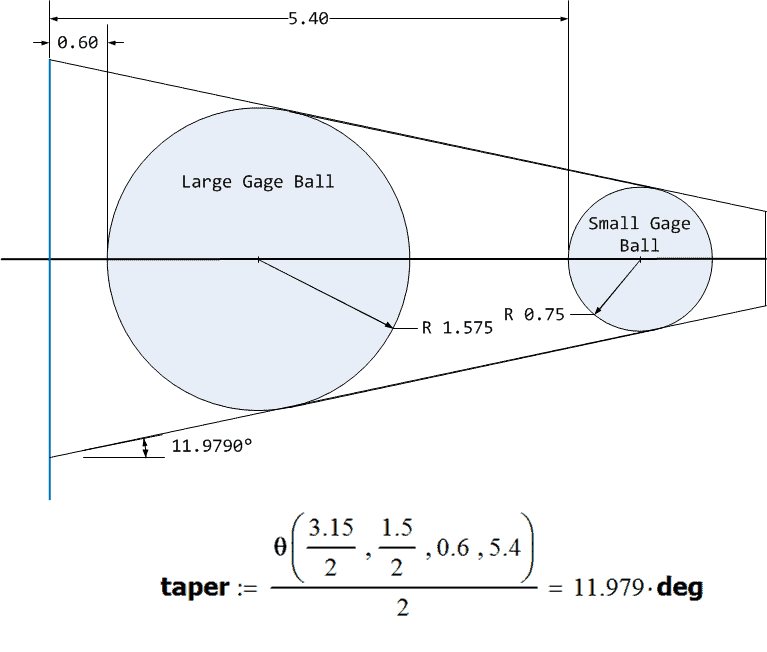

Having explored the various types of tapers, it’s time to understand how they are measured. The measurement of tapers is integral to ensure their proper fit and function. Tools such as calipers and indicating 2-point gauges are commonly used for this task.
An easy way to measure the taper angle is to use ball gages.

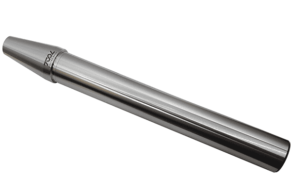

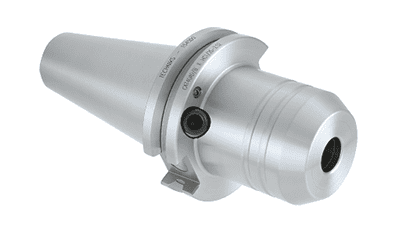

Precision test bars are employed to ensure the taper is correctly dimensioned and aligned within the machinery.  Here is a typical CAT 40 Test Bar:
It is essentially a cylindrical standard attached to a tool holder.

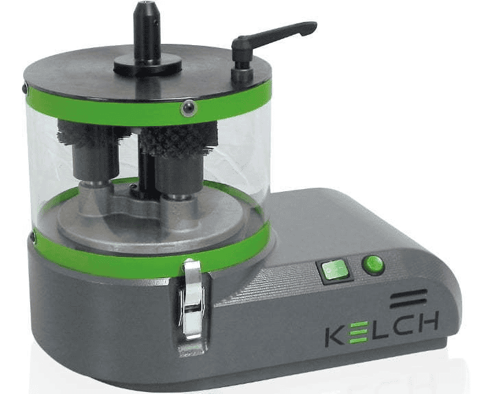

Cleaning Methods and Tools
Kelch Taper Cleaner…
An effective cleaning system for tool tapers involves using a specialized taper cleaning tool, which includes a drive unit with a brush and compressed air nozzles to clean automatically. Tapered brass brushes are recommended for cleaning tapers without causing damage.
For heavy surface corrosion on tapers, a wire wheel on a Dremel and WD-40 can be effectively utilized.
