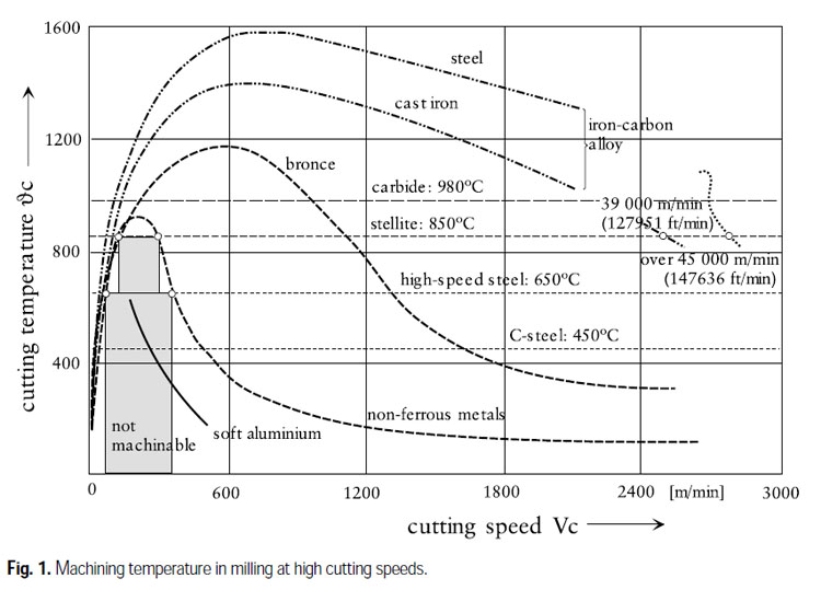

One of the things that got people thinking about HSM was the discovery that after a certain point, increasing spindle speed actually reduces the heat in the cut:
This amazing chart is from Dr Herbert Schulz’s, “History of High Speed Machining.”
The dotted lines represent temperatures at various surface speeds measured in m/min. Here is the US, we’re more used to SFM. Want to understand Surface Speed, SFM, and how do we get from SFM to RPM on the spindle? If you’re not familiar, it’s simple stuff and the link will explain.
Note that all of the materials go steadily up and then eventually start dipping back down again as surface speed increases. Somehow, high speed machining causes temperatures decrease beyond a certain spindle rpm!
This chart is in meters/minute, so multiply the values by about 3 to get to SFM. For aluminum, we have a pretty good dip by the time we’re hitting 1000 SFM, for example. In fact, it’s temperature is more equivalent to less than 300 SFM on the other side of the aluminum curve–that’s nothing for aluminum. Heck, if we have a fast enough milling spindle, there’s even room to run HSS faster and get lower temperatures (you’ll note various cutter materials critical temperatures are also marked off–stay below the line for your cutter!).
Steel and cast iron taper down more gently than aluminum, but the effect is still alive and well. Yes Virginia, there surely is some strange behavior when you start in with that HSM stuff!

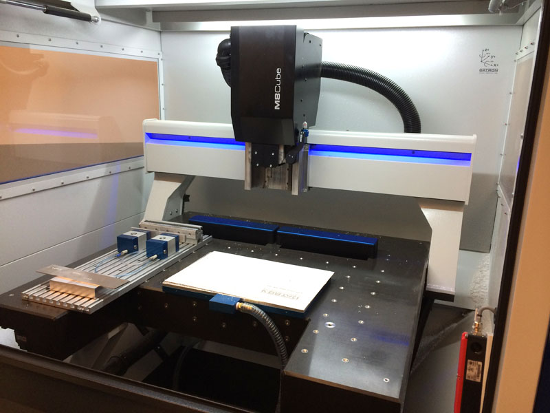

Datron’s M8 Cube uses a high speed spindle and high speed machining techniques to achieve maximum productivity…

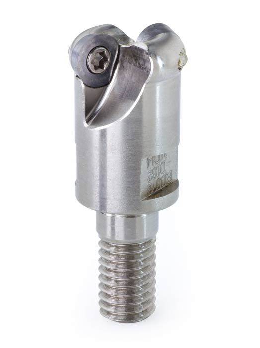

Tormach’s Toroidal Cutter uses round or button inserts for better results…

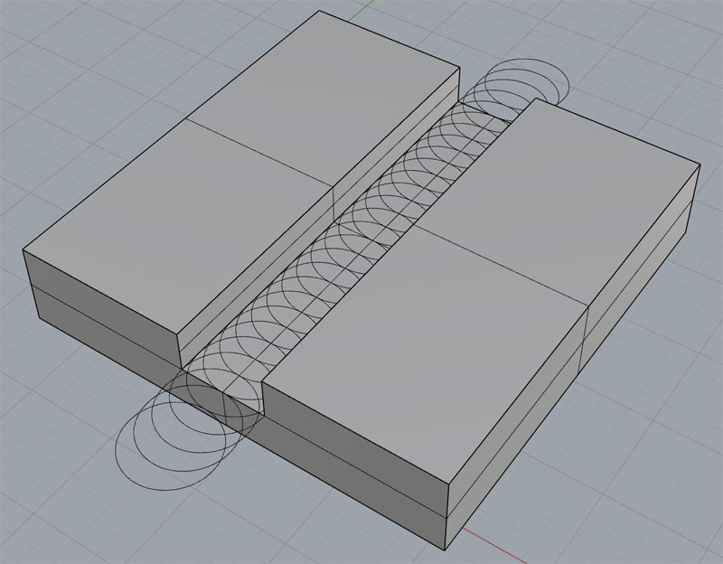

Trochoidal Milling is similar in concept. Let’s take the example of a slot, which is very demanding to cut and forces us to slow down. Suppose we have a cutter that is 1/2 the width of the slot in diameter. Now we have some room to work with. Let’s treat it just like the corner peeling and perform a series of looping moves that slice off little peels of the slot rather than just digging straight in with a big cutter. That’s Trochoidal Milling, which is a type of High Speed Machining.
Here’s an idea of what it looks like for our slot:
Trochoidal Milling for a Slot…
There are some variations, such as whether we use full circular loops or keep the retract side shorter by making little D’s. The choice of the latter depends on your machine’s acceleration capabilities. The D’s demand a faster tighter machine while the loops can be a little more forgiving of slower machines.
The thing is, these sorts of cuts are capable of driving the tool enough faster that they can beat a big hogging cutter at material removal, especially if you don’t have a big heavy machine with a lot of horsepower to back up the big hogging cutter.

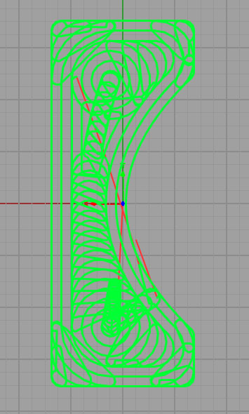

Here is a comparison of typical HSM and conventional toolpaths for the same pocket done in GibbsCAM:
Comparison of the same pocket done with HSM and conventional toolpaths in GibbsCAM as shown by the GWE CNC Simulator…
You can see there are sure a lot of sharp corners in a conventional toolpath. No wonder HSM can be so much faster!

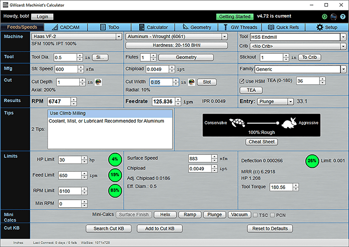

G-Wizard has a built-in HSM calculator:
An HSM cut in 6061 aluminum…
The example cut being shown is a 1/2″ endmill in 6061 aluminum, 10% radial engagement as we’ve been talking about, and a full 1″ depth of cut. With an HSM toolpath that guarantees no corners will be cut, we can run 6747 rpm at 125.8 ipm feedrate. That’s a 1.2 HP cut. Without HSM (turn off the HSM checkbox in the “Cut” row), the cut falls back to 4272 rpm at 34.89 ipm for a cut that’s only 0.3 HP.
The material removal rates for HSM are about 5x greater with HSM. You don’t have to think to hard to realize why these HSM toolpaths have become almost indispensible for a lot of shops.
