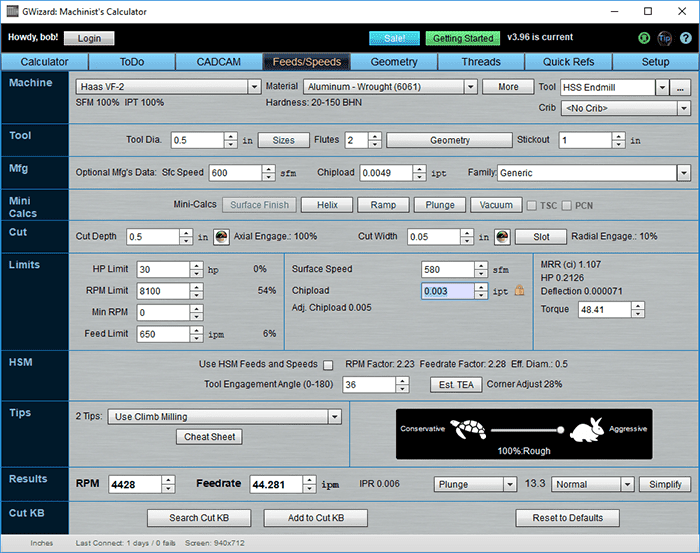

Pitfall #1: Radial Chip Thinning
Did you know that the chips your end mills make get thinner if you reduce the cut width below half the tool’s diameter? Here’s a graphical depiction of this strange phenomenon, which is called “radial chip thinning”:
Circular diagram illustrating chip thinning in machining with varying chip thicknesses.
Radial chip thinning makes your chips thinner if your cut width is less than half the cutter’s diameter…
In the diagram, you’ll look straight down the axis of the endmill and compare two cuts.  The blue shows how much thinner shallow-cut chips are versus full-width (red segment). This may seem pretty harmless.  At worst, it seems like using these thinner cuts may be leaving money on the table.
That much is true, and you’ll need to speed up your feed rate to compensate for the chip thinning if you want to keep your productivity up. However, chip thinning taken to the extreme can be very hard on tool life.
The reason? Let’s imagine a new machinist.  They’ve got a lightweight CNC machine, they’re just starting, and they want to take it easy.  So, they keep the Cut Width very light.  Let’s say only 10% of the cutter width. Here’s what the Feeds and Speeds look like without the chip thinning adjustment:
Machining calculator interface with Calculator, Machine, Tool, Getting Started, Quick Refs, Cut Depth, HP Limit, and RPM tabs.
I manually bumped the chip load down from the chip thinning-adjusted value G-Wizard would normally give. Now further, let’s suppose I decide to run things even more conservatively, so I take the feed rate down to 1/10 what it was.  I’m only going to move at 4 inches per minute. Now G-Wizard is giving me a warning:
Machining screenshot with warning about low chipload.
Chip thinning can drive down chip load so low that the tool begins to rub instead of cutting.  If you want to read more about radial chip thinning and rubbing, try my article on the subject that’s part of our Free Feeds and Speeds Course.  I even did a video on chip thinning for Cutting Tool Engineering.

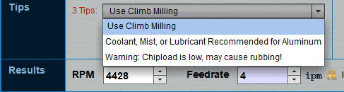

Pitfall #11 – No Tips and Warnings
Ask any good expert the answer to a question, especially something like an exact feeds and speeds scenario, and they’ll give you a good answer.  But, they’ll very likely give you more than just that answer.
For example, they might tell you the numbers and then let you know that there’s a better way.  They might remind you of some other considerations, for example, that the cut might be likely to rub, or that those parameters are a risk for tool deflection or a myriad of other things.
Do you ever go through tooling catalogs and read the Technical Information in the back? They’re chock full of great tips and techniques.  Except, who can ever remember them all?
Well, the expert will.  Formulas won’t.  But somewhere in between, great software can remember all that and try to offer it up to you at just the right moment.
Please take a look at the screenshot above where G-Wizard had three tips for us. It wanted us to use Climb Milling, it reminded us to use coolant or mist to lubricate when we’re cutting aluminum (otherwise chips can weld to the cutter), and it warned us we were in danger of rubbing.
Try getting any of that from the simple cutting speed formulas.

Cutters are not cheap and neither is your time.  Being able to get not only better performance but longer life from your cutters is worthwhile-proper cutting speed matters!
Being able to do so cheaply and in far less time than it’ll take you to punch the numbers up in your spreadsheet is nearly priceless. Our free Milling Speeds and Feeds Calculator is a good place to start.
Cutting Speed Formula FAQ
What is the Feed Rate Formula?
Feed Rate Formula:
Feed in ipm = Spindle RPM x Feed Per Tooth x Teeth in Cutter
What is the Cutting Speed Formula?
Cutting Speed Formula:
Cutting Speed in RPM = (Surface Feet Per Minute x 3.82) / Tool Diameter in inches
What is Chip Load Formula?
Chip Load Formula:
Chip Load (IPT or Inches Per Tooth) = ( Feedrate (Inches Per Minute) / RPM) / Cutting Edges
