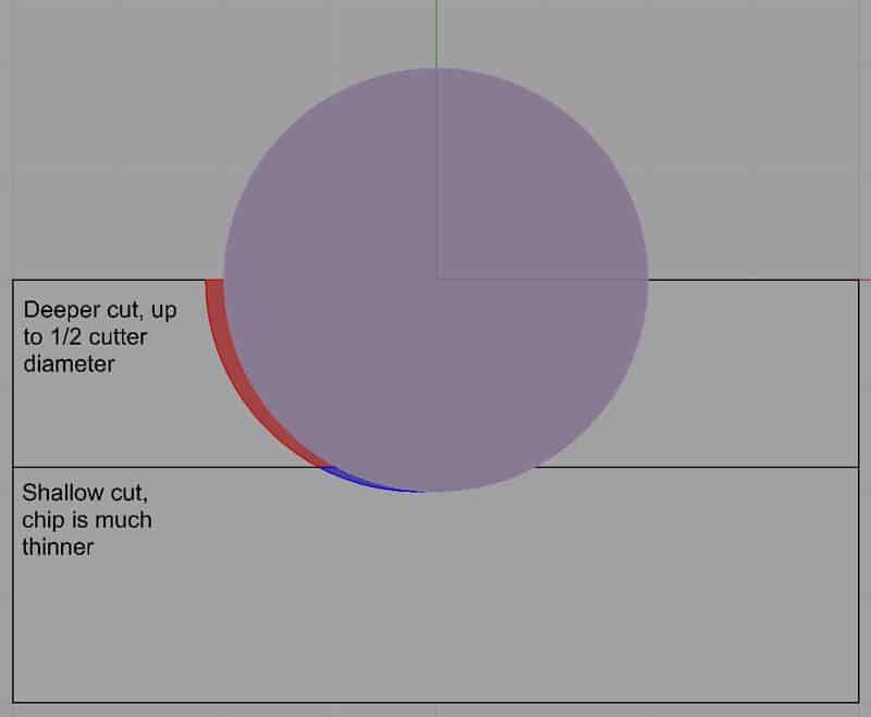

Two Odd Geometry Effects of Cutting Tools: Rubbing and Chip Thinning
There are a couple of odd geometry effects that have to do with chip load. The short summary is if you lower the feedrate too much, or lower the cut depth too much, you can get into trouble. In fact, it can be pretty big trouble too. I’m not going to present all the details here. You can look to our special article on chip thinning and rubbing for details. You should know that the above free calculator can’t account for either factor, but our G-Wizard Feeds and Speeds Calculator covers both.

On the right, you see G-Wizard’s “Tortoise-Hare” slider. It moves cuts from most conservative (full tortoise) to most aggressive (full hare). The most conservative position is calibrated to be the slowest you can feed without rubbing. It’s handy, both to know where the limit is, but also to get the nicest possible finish. We’ll talk more about the Tortoise Hare and Finishing vs Roughing Feeds & Speeds soon, but I wanted to get that out there.
Now I manually reduced the feedrate further after setting it to the Fine Finish position, so now we are rubbing. And you can see the lefthand red rectangle shows a warning message that these settings may cause rubbing. If you use a tool like G-Wizard, you won’t have to worry about rubbing much because the software is looking out for you.
For a complete chip thinning walkthrough using G0Wizard, see our article.
You’d be surprised at how helpful managing these two factors can be for increasing your Tool Life and reducing your cycle times.
