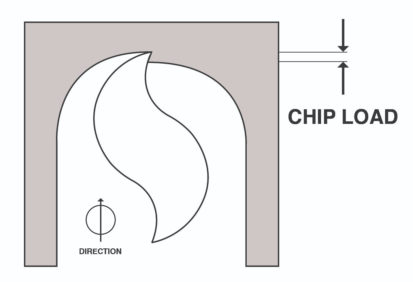

Chip Load: Chip Thickness per Tooth
Chipload is the thickness of the chip being sliced off by your cutter. Image courtesy of Onsrud.
I briefly described chipload above, but let’s dive in a little deeper (don’t worry, not too deep).
While cnc feed rates are specified in length units per minute, the more important measurement is something called “Chip load”. Think of a chip as looking something like a comma in cross section, or perhaps an apostrophe. One starts big and gets smaller at the end. The other starts small and gets bigger at the end. We’ll ignore that difference for a moment, though it is important as we shall see later. If we measure the thickness of the chip at its thickest point, that’s the chipload. Simple, right?
Chip load is a measurement that is independent of spindle rpm, feed rate, or number of flutes. It tells how hard the tool is working. That’s a very useful thing, as you could imagine. Hence, manufacturers and machinists typically like to talk about chip load for a particular tool.
