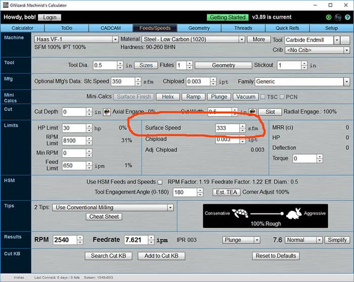

Why use a Surface Speed Calculator for Spindle Speed?
There are various reasons to use fancier surface speed calculators over simple sfm to rpm formulas.  For example, if you're drilling a deep hole, it is often helpful to slow down the rpms a touch.  But, for the most part, you've just learned everything you need to know about Surface Speed, SFM, and calculating spindle rpms.
Now I know you're wondering. Given how easy it is, why would you need a fancy feeds and speeds calculator?
First, not everything is as simple to calculate as spindle rpms.  Second, I've already mentioned fancier calculations can be beneficial to your tool life.  But probably the most important thing is that these variables don't exist in isolation.  Each one impacts the others.  For example, your machine is limited to a certain amount of power based on the size of its motor.  All sorts of things, including spindle rpm, go into determining how much power is used in a cut.
What should be done if the cut exceeds your spindle's available power?
We could choose to adjust a lot of different variables.  We could throw up our hands and just tell our user that particular scenario is impossible.  But, the right answer is to adjust the variables in some optimum order that gets the user as close as possible to their desired result.  We just learned we can reduce rpms and all is well–tool life improves!
But, if you have a high speed spindle, perhaps for a CNC Router, you can only make it run so slow.  For many machines, slowing down too much also reduces available power.  Can you see all the interactions that take place between all these variables?
Dealing with that complexity is the role of a good Feeds and Speeds Calculator. Our free Milling Speeds and Feeds Calculator is a good place to start, and our Feeds and Speeds Guide explains how all these variables interact with one another. Getting a little help mastering speed and feed will make your CNC work go so much faster and easier too.
