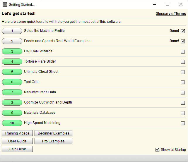

Notice that Getting Started popup and button?
G-Wizard is full of quick tours called "Getting Started..."
Screenshot of a tutorial guide with numbered steps and images for machining software.
These little tours will get you up to speed with G-Wizard in a hurry!
As long as the "Show at Startup" checkbox is checked, the Getting Started Tours open every time you start G-Wizard.  If they don't click the "Getting Started" button near the top right corner of the G-Wizard window.
Take time to go through the "Setup the Machine Profile Tour" and the "Feeds and Speeds Real World Examples" at the very least.  Then go play with G-Wizard a bit.  When you're ready to pick up even more power, take the other tours.
Did you notice some of the buttons are colored, some are not, and there are little checkboxes on the right that say "Done!"
This helps you track which tours you've already taken.
Note some of the other resources on the Getting Started popup:
It'll be tempting to turn the Getting Started Popup off too soon, without doing all the Tours.  Fight the urge, knowledge is power.  Get every bit of Feeds and Speeds power you can.

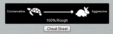

The cheat sheet button is on the Feeds / Speeds tab right under the Tortoise-Hare Slider:
Black banner with "100%:Rough" centered between a turtle and a rabbit.
The Cheat Sheet pops open right in G-Wizard, and it helps you understand exactly how to change the various parameters to create whatever end result you desire.  It looks something like this:
Machining information, CNC machines, metal fabrication and software cheat sheet.
So, for example, there are 8 suggestions for how to create shorter cycle times.  And they’re in the order of highest to lowest impact, so you know what to try first.  Talk about making it easy to get seriously in control of your feeds and speeds!
