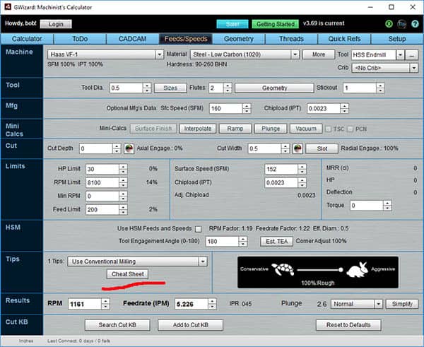

Thus was born the “Cheat Sheet” button starting with G-Wizard Calculator version 3.69 (just uploaded it).  I stuck it right below the “Tips” area, because it’s really extended Tips-style help:
g-wizard feeds speeds cheat sheet button
The Cheat Sheet Button: right below the Tips…

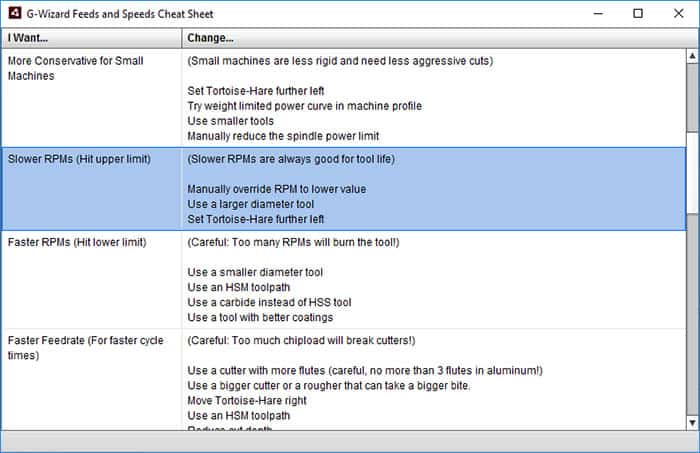

If you click the Cheat Sheet Button, you get a popup Feeds and Speeds Cheat Sheet you can use to help you push G-Wizard in whatever direction you’d like:
Feeds Speeds Cheat Sheet
The Fees and Speeds Cheat Sheet…
Notice there are two columns:
  • Under “I Want…” are various things you’d like to achieve–longer tool life, faster cuts, better surface finish, making millions (oops, just kidding about that one!), and so on.
  • Under “Change…” it tells you a little bit about what this accomplishes and suggests various things you might change to achieve your goal.
For example, to get better surface finish, it suggests you “Set Tortoise-Hare further left.”  Of course that’s what the Tortoise-Hare slider is especially good at.

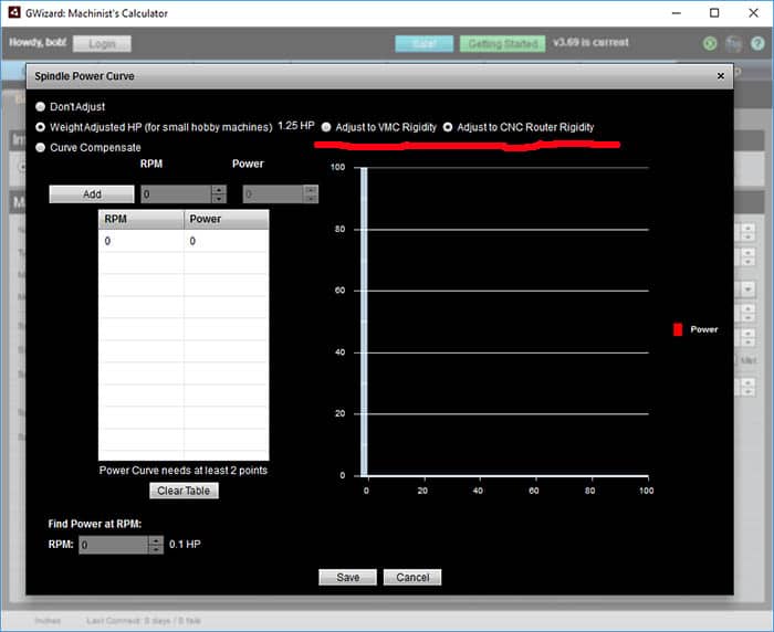

The Cheat Sheets are not all that’s new in v3.69.  I have also added a new setting to our Machine Rigidity Power Curve Adjustment Mode (that’s a mouthful!).  Take a look:
cncroutervsvmcrigidity
New Rigidity Adjustment Options marked in red…
First, to get to the Spindle Power Curve Adjustments, go to the Setup applet and bring up your Machine Profile.  There’s an “Adjust” button down by the spindle parameters that brings up this box.  You have 3 choices:
  • Don’t Adjust: Assume the maximum horsepower is available at all rpms.  This is often the easiest to get started with.
  • Weight Adjust:  Lighter machines are not as rigid, so we derate their spindle power so the cutting forces don’t bend their frames any more than larger machines.  This is usually a good choice for lightweight hobby machines to keep them out of trouble.
  • Curve Compensate:  This lets you enter data points to create an rpm-adjusted power curve.
A great many hobbyists with very lightweight machines have gotten tremendous benefit using the Weight Adjusted mode.  For more details on the theory behind it, check out our article that analyzes Machine Rigidity.
What we did with this feature, was to derate your spindle power curve were limited to forces commensurate with the ridigity of your machine.  We derive an approximation of that rigidity by looking at the machine’s work envelope and its weight.  A well-designed machine that concentrates all of its mass in a smaller space will be more rigid than if we spread that mass out over an extended area.
That brings us to the question of CNC Routers versus VMCs (Vertical Machining Centers, you know, like Haas milling machines and the like–industrial strength CNC Mills).  Even fairly hefty CNC Routers are not built to be as rigid as a 6000 pound VMC.  There’s no need–typically they’re used for wood and don’t need to hold tolerances that are nearly as tight.
Given just how many folks using our software are CNC Router users, it seemed like a good idea to add an option to weight adjust for CNC Router rigidity.  This lets them use more power and cut through wood (or whatever material they like) faster if they’re not so worried about tolerances.
OK, what kind of tolerance differences?
That’s a really complex question.  For the sake of simplicity, let’s say you want to hold as tight as 0.001″ on the VMC (perhaps tighter) and 10x that or 0.010″ on the CNC Router.  That’s approximately what we’re talking about here, give or take.
This new option should be much nicer for folks running smaller CNC Routers.
