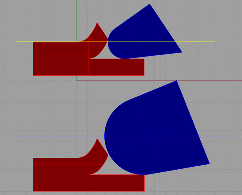

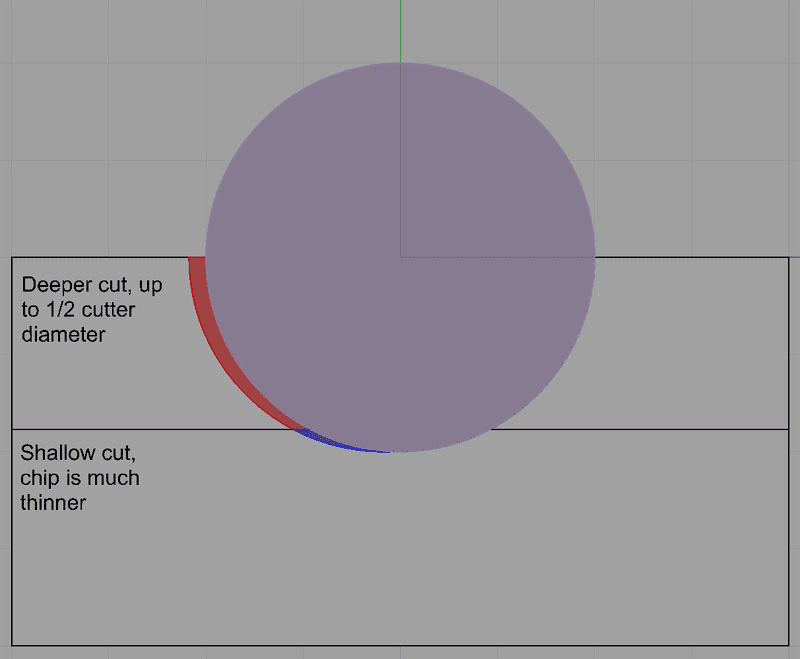

Improper Feeds and Speeds
Yep, you can definitely get into trouble with improper Feeds and Speeds. You are using a Feeds and Speeds Calculator, right? You do know you can't actually hear proper feeds and speeds or feel them, despite what many old timers may claim? Let's assume you are using a Calculator. You can still get into some trouble depending on the Calculator. You're unlikely to be going too fast if you used a Calculator properly, but beginners very often go too slow.
Come again? How can going too slow get me into trouble?
Welcome to the wonderful world of Feeds and Speeds Sweet Spots, where you had better have dialed in that special Goldilocks "just write" combination of Feeds and Speeds. Here's the Sweet Spot diagram from our free Feeds and Speeds Course:
Too much or too little of either spindle rpms or feedrate leads to trouble. In this case, slow feedrates can lead to rubbing because chip loads are too low. Remember, the chip load is the thickness of the chip that the cutter slices off each time. If that thickness is too small relative to the sharpness of the cutter's edge, it can't get under the chip to slice it off cleanly. It rubs and scrapes it off, which generates a lot of heat and is hard on the tool. Here's a graphical diagram of what causes rubbing:
The bottom cutter is starting to rub-its edge can't get under the chip to slice it of cleanly...

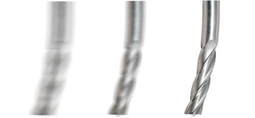

Too Much Runout
Runout is a common problem for small machines. The spindle and toolholder will each have some sort of runout component. If the toolholder involves a collet, the collet will have its own runout.
Runout is nothing more than the tendency for the cutter to rotate a little off-center rather than exactly along its axis. The problem with runout is it changes the chip load (thickness of chips being cut) and forces the flutes on the part of the revolution that sticks out to do more than their share of the work. Having fewer flutes on the cutter doing a lot more work than you intended is obviously a great way to stress out and ultimately break the cutter.
Less expensive machines and toolholders often have a lot more runout than you'd like. Sometimes you can isolate it to a particular toolholder that wasn't machined well and just needs to be junked. Fortunately, it isn't hard to measure runout. We've written a number of articles about it that you can search for or click this link to track down.
Once you measure your runout, you'll be wondering, "How much runout is too much?" There's no concise answer-it all adds up. Think of runout as being added to the chip load of your cutter. Whatever that recommended chip load may be (G-Wizard Feeds and Speeds Calculator will give you that), think of the Runout as a percentage of the chip load. If it's more than 5-10%, it's probably causing you problems.
This chart shows the effect of runout, as a percentage of chipload, on your tool life:
Pretty scary, right?
What can you do about runout if you have too much?
First thing is measure it for all your toolholders and get rid of the most egregious runout toolholders. Sorry, I know they cost money, but they have quality problems and cutters are expensive too. On a suspected bad toolholder, be sure to try it with several collets-it could be just the collet that needs replacing.
If you still don't have runout under control, clean everything meticulously. Chips and dust can add up to runout too.
Did all that and still not happy? Well, you can still do a couple of things. First, you could reduce the chip load you're willing to run by an amount equal to the excess runout. That'll take care of breaking cutters and it isn't hard to do if you use a Feeds and Speeds Calculator like G-Wizard.
Second, you may want to try "clocking" your toolholders. This is the practice of rotating the toolholder in the spindle before tightening it so that the runout of the spindle and the toolholder partially counteract each other. You'll need a reference mark on the spindle and another on the toolholder to be able to do this well. Mark the tool holder so that lining up the toolholder mark with the spindle mark yields minimum runout.
It's kind of a pain to do this, but it will yield results and sometimes the small CNC Machines may make us work a little harder to get our best results.

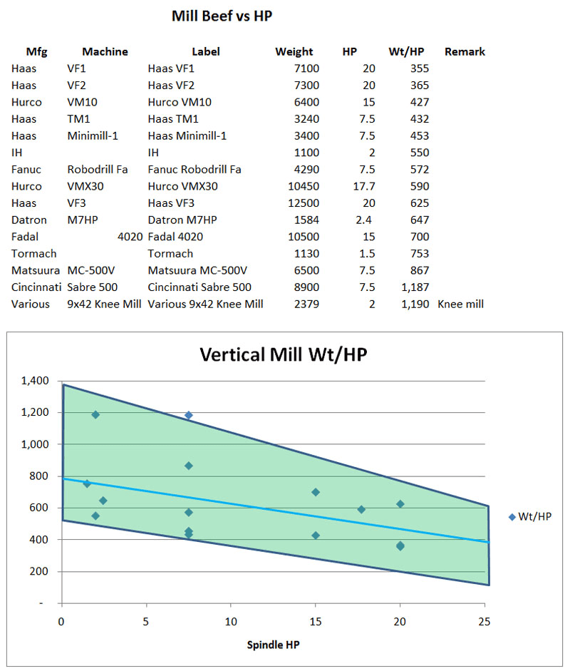

Compensating for Machine Rigidity
Industrial VMC’s weigh thousands of pounds yet the actual size parts they can machine may not be a lot larger than a mid-sized desktop CNC Router. Clearly those thousands of pounds do something for the VMC that the little machine isn’t getting, and that something is machine rigidity.
Spindle Power (HP in Imperial and KW in metric) is a measure of how much power the machine has available to try to deflect the machine’s frame. It doesn’t just go to deflection, it also goes to cutting, but let’s take the worst case here. In the industrial world, the relationship between machine weight and spindle power is pretty predictable. Here it is visually:
Machines fall within a pretty narrow zone…
G-Wizard uses this relationship, together with your machine’s work envelope (volume of its travels in X, Y, and Z) and weight to find an “ideal spindle power” that is right for the estimated rigidity of your machine. If that adjusted spindle power is less than your spindle’s rated power, then it derates to the adjusted power.
Many hobby CNC machines actually have spindles that are monstrously powerful for their rigidity. This happens because things like Trim Routers are relatively cheap, fairly powerful, and easily adapted for use on a small CNC. If you use too much spindle power and it overcomes your machine’s rigidity, you’ll have problems. That’s where G-Wizard can help by limiting the power.

4: Be Aware that Your Machine is Probably Not Very Rigid and Adjust for That
Machine Rigidity is the machine’s ability to resist flex when forces are applied to the frame. The usual source of those forces are the cutting forces as your machine cuts through whatever material you’re feeding it. In general, Machine Rigidity is proportional to mass, design, and work envelope. An Industrial CNC Milling Machine is a big heavy beast indeed. A $35,000 Haas Mini Mill is at the lightweight end of the Industrial range, yet it weighs about 4000 lbs. Your little router may not even weigh 100 lbs. The Shapeoko 3 pictured at the top of this article is one of the more rigid designs yet you can easily pick one up in your own two hands.
Work envelope refers to the travels of one of these machines. CNC Routers have large travels for their weight compared to CNC Milling machines. The effect of this is that they’re less rigid. In the case of lightweight routers, they can be a LOT less rigid. What does that mean for your cutter and project? If the machine is flexing, it may just flex in a direction that sucks the cutter deeper into the wall of the cut. That means cutting forces shoot up and the cutter may break right then and there if it is close to the edge.
Now you’re wondering, “How in the world can I adjust for that?” Well, it turns out this is another exclusive feature of our G-Wizard Calculator. When you define a Machine Profile, which is how you tell G-Wizard what your machine is capable of, you will be telling it your machine’s weight and its X, Y, and Z travels. From that, it has the ability to adjust your spindle power curve so that the machine will act like a much more rigid machine. How does that work?
First, we plotted the typical relationship of these variables for Industrial machines:
Matching up Spindle Power to Machine Weight…
We took this relationship between weight and horsepower together with the third variable–work envelope–and use it to extrapolate the maximum spindle power you can run without over flexing your machine’s frame. G-Wizard will then use this information to reduce Feeds and Speeds to stay within those limits. It’s a very potent tool for helping small machines to reliably produce better results. It also makes a great starting point for beginners. Over time, you will want to see how far your specific machine can dial up from these limits so that you can cut things more quickly. But when precision and surface finish really matter, it’s nice to be able to drop back and use this adjustment. Owners of really small machines like Sherline’s and Taig’s tell me they’ve gotten great results with this feature.
More on how to set up small machine weight adjustment in our step-by-step here.

6: Be Aware of Deflection–Like Runout it Adds to Chipload
Your cutter can actually bend or deflect in the cut…
If you push on the end of a cutting tool with your finger, it will deflect a bit. Depending on the cutter, the deflection might not be visible, but rest assured, it is deflecting, even if only on a microscopic scale. When the cutter is in the cut making chips, there are significant forces working on it and trying to make it deflect. Depending on exactly what’s going on, the tool can deflect in any direction. Somewhat counter-intuitively, it can even deflect in a way that makes it cut more deeply into the wall of the cut than you had intended. This has to do with how the teeth on the cutter bite into the wall and try to drag it in. The exact orientation of all that has to do with whether you’re Climb or Conventional Milling. I will leave the latter as a more advanced topic–click the link if curious, but we need not worry as Beginners about it just yet.
When it cuts more deeply than intended, Tool Deflection is additive to chip load, just like Runout. I guess it is one more reason to prefer larger diameter tools. We can use the G-Wizard Rigidity Calculator to experiment with 3 variables and see their effect on Rigidity. We know from the previous example that doubling diameter results in a tool that is 16x more rigid. Even small increases in diameter can really help rigidity a lot. There’s another parameter to be aware of, called “Stickout.”
“Stickout” is how far the tool protrudes from the toolholder or collet. That portion is unsupported and is where all the bending will take place. Let’s take our 1/8″ end mill. If we compare a 3/4″ stickout versus a 1.5″ stickout, we see the longer stickout made the tool 8x less rigid. That’s right–double the stickout results in 8x less rigidity. The moral of the story is not to extend your cutter any further out of the collet than you absolutely have to, and to use the largest diameter possible to make things rigid so as to resist Tool Deflection.
The other thing to do, is be aware of how much Tool Deflection we’re getting for a particular combination of Feed and Speed parameters. G-Wizard will calculate your deflection for every cut and it will light the deflection up in Red if it is likely to be a problem:
A Tool Deflection Disaster in the making…
That’s a Tool Deflection Disaster in the making: 0.011″ of deflection on a 1/8″ cutter that can only take 0.001″ of chip load!
What can we do with too much Deflection? Here’s the quick cheat sheet:
- Use a larger diameter cutter.
- Use less stickout.
- Use Carbide instead of HSS cutters–they’re 3x as rigid for any given diameter and stickout.
- Change cutting parameters to lower cutting forces enough to be within deflection limits.
That last one is often your only choice as other factors prevent choosing a different cutter. Here again, G-Wizard can help. It’s the only Feeds and Speeds Calculator out there with our exclusive Cut Optimizer capability. Cut Optimizer lets you hold either Cut Width or Cut Depth constant while it figures the maximum amount the other variable can be within deflection limits. Let’s say you to cut a full cutter width slot with this 1/8″ cutter shown above. How deep can we go in each pass?

Let’s start with rubbing and refer to this diagram:
Rubbing happens when the cut is too shallow relative to the sharpness of the cutting edge…
Imagine the red thing is the workpiece and the blue thing is one of the cutting edges on your end mill. If we were to look at the edge under enough magnification, we’d see that it never comes to a sharp point–it is a round radius at some scale. Now if the centerline of the radius is below the surface of the workpiece as in the top diagram, the edge can get under the material and slice it upwards to peel off a nice clean chip. That’s what we want!
OTOH, if the cut is too shallow, the centerline of the edge radius will fall above the surface of the workpiece. It doesn’t get up under to slice. Instead, the bottom of the radius plows along and if it peels off a chip at all, it is tearing it off through abrasion. This latter condition is what we mean when we say a cutter is “rubbing.” You can imagine that rubbing produces a lot of heat because instead of slicing off the chips, it is rubbing and tearing them off. There’s much more friction involved.
How do we ensure this doesn’t happen? Well, we have to make sure there’s enough chip load without there being too much. It’s a Goldilocks problem where the chip load has to be just right. It’s just one more way of saying we have to stay in the Sweet Spots we talked about above. Making the feedrate too slow isn’t conservative at all, it’s hard on the cutter because it overheats the cutter through rubbing. Overheating softens the cutter if it gets hot enough, and ultimately this dulls the cutter. Not long after, it will break.
Now what about that other scary sounding term, “Radial Chip Thinning.” Forget how scary it is and lets look at another picture:
With shallow cuts, your chips are thinner than expected…
Viewed from directly above, the diagram shows how shallower cuts result in thinner chips. Let’s go back to our “Chipload” term. We never really described exactly what Chipload is, but now is the time: chip load is the thickness of the chips our cutter peels off. In fact, if we pick up a chip and straighten it up, we should be able to measure its thickness to find the actual chip load of the cut.
Now we can see from the diagram above how much thinner the chips are when we take shallow cuts. And what happens when we let them get too thin relative to the cutting edge? Why we’re rubbing and as we’ve seen, that’s very bad for tool life. So, the combination of super low feedrate and super shallow cut is suddenly a perfect storm of rubbing misery for our once happy little cutter.
What to do?
The answer is once again in our Feeds and Speeds Calculator. It should automatically be applying a calculation that accounts for the Cut Width and that will actually speed up the feedrate if we specify very shallow cuts. You probably thought it did this because we can be more aggressive on shallow cuts, right? Yes, we can, but we also have to speed up just to maintain the level of aggressiveness we already thought we had due to chip thinning:
“Now, here, you see, it takes all the running you can do, to keep in the same place. If you want to get somewhere else, you must run at least twice as fast as that!” — Red Queen from Alice in Wonderland. True in Wonderland and true when chip thinning is a factor.
You only have to consider chip thinning for cuts less than half the diameter of the cutter. But for all those, an adjustment to feedrate should be made.
