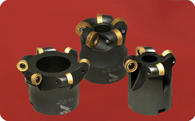

– The number one request for a new tool type in our G-Wizard Feeds and Speeds Calculator is the button cutter (and close relative bullnose endmill). A button cutter (toroidal indexable tooling) is a wonderful tool. Yet, to get proper feedrates, it needs to account for chip thinning in two different dimensions. Both the cut width and cut depth can lead to chip thinning in one dimension or the other. That’s not simple math you do in your head. But if you ignore it in a material like stainless, you can get to rubbing real fast, work harden the material, and lose tool life. You can be off a little and all will seem well, but you’re leaving money on the table every inch you feed the tool. Money either from reduced tool life or from not pushing the tool as hard as it could otherwise go. BTW, I should have bullnoses and button cutters available in G-Wizard shortly, so this math is top of mind right now.
