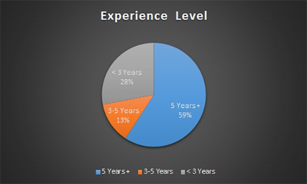

Who Responded?
First, a little background about the respondees. On the whole, they were experienced professional CNC’ers:
59% had more than 5 years of experience…
70% listed themselves as Professionals and 30% as Hobby CNC’ers.

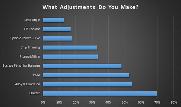

Adjustments Made to Feeds and Speeds
Each of these “adjustments” requires some special calculations. Some of them are quite extensive. They also serve as a benchmark for which respondents are using the most advanced methods.
By far the most common thing people are attempting to adjust for is Chatter. Did you know Chatter is a resonant phenomenon that can be methodically attacked and tamed? The right way to deal with it is not just to dial down your Feeds and Speeds until it goes away. Check out our special article on Chatter for more–it’s part of our free in-depth Feeds and Speeds Cookbook. G-Wizard Calculator even includes a special “Chatter Pitch Calculator” that can help you assess the optimal spindle speeds to minimize chatter on your job. It’s covered in our Chatter article, so do check it out if Chatter is ever a problem for you.
Adjusting for alloy and condition is the second most important adjustment. You want to be sure you’ve got a big Material Database at hand to help with that. We built one into G-Wizard for just that reason.
HSM is #3, followed by Ballnose Surface Finish (scallops!), Plunge Milling, Chip Thinning, and so on. It’s interesting that so few people consider either their spindle power curve or chip thinning in their calculations. You will encounter chip thinning any time the cut width is less than half the diameter of your tool, so way more than the 33% or so of folks are dealing with it, they’re just using the wrong feeds and speeds. For the record, G-Wizard Calculator deals with every single thing listed. Lead Angle is another great one–it makes a big difference and is even a factor when selecting what Face Mill to use for a particular application. None of these are areas that can be helped by simple rules of thumb or by ear.
In fact, machinists who use advanced techniques like HSM, Plunge Milling, and High Pressure Coolant are about 30% more likely to use a Feeds and Speeds Calculator, and it was already the most popular choice for calculating your Feeds and Speeds.

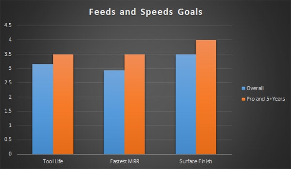

Feeds and Speeds Goals
What do you strive for when looking for the “Best” Feeds and Speeds? Tool Life? Material Removal Rate? Surface Finish?
Surface Finish trumps all else. For the whole group, Tool Life would be next most important, but for our group of experience pros, they put Tool Life and MRR on an equal footing–they want it all, in other words.

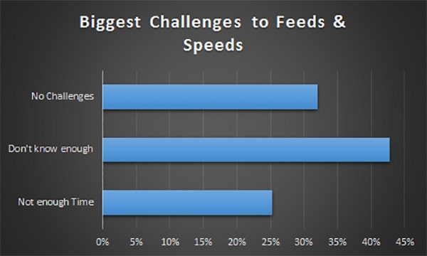

Biggest Challenges to Feeds and Speeds
We know from prior surveys that both Beginners and Pros consider Feeds and Speeds to be one of the more challenging aspects of CNC. Between the prior link and this new survey, we can get a clearer picture about why:
The number one answer was, “Don’t know enough to do all the calculations.” For those that want to know more, check out that Feeds and Speeds Cookbook. It delves into almost every facet from beginner to advanced. It isn’t just about Feeds and Speeds either–there are a lot of valuable tips and techniques there as well.

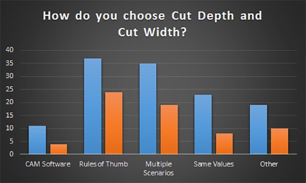

How are Cut Depth and Cut Width Figured?
In many ways, we have the cart before the horse–the Cut Depth and Cut Width will determine what the range of allowable Feeds and Speeds are. You’re defining the rules of the Feeds and Speeds Game, and ought to consider them carefully to make sure the game is played in your favor. How do people go about it, then?
The most common answers were Rules of Thumb and Multiple Scenerios (trying a lot of combinations to find a good one). In the “Other” category, basing it on either G-Wizard or rigidity (which is essentially what G-Wizard does) got 80%. FWIW, G-Wizard offers 2 excellent tools for deciding your Cut Depth and Cut Width:
- Cut Optimizer will do a quick calculation that lets you hold one of the two fixed and find the maximum value for the other within deflection limits.
- CADCAM Wizards will try 600-800 scenarios within a few seconds and tell you what the optimal combination is. When was the last time you tried 800 scenarios?
You can read more about those tools here.

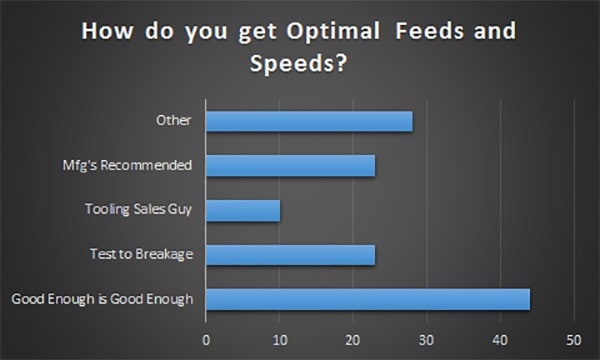

How Do You Find Optimal Feeds and Speeds?
This is an interesting question which many punted:
I say “punted” because the most popular answer was “Good Enough is Good Enough”–they didn’t try to optimize, they just went with their first answer. This is not tremendously surprising given the High Mix/Low Volume world we live in. It’s hard to do the old business of increasing Feeds and Speeds until something breaks and backing off when you’re not making many parts, though we still had that as the #3 most popular answer. The #1 answer in the “Other” category was G-Wizard as a write-in, which was very gratifying. I definitely hear from lots of shops who felt their Feeds and Speeds were much more optimal after adopting the product. You can see that in some of the statistics they report back to us–56% longer tool life and 46% increase in cutting speed on average is pretty good!
Several were a little more detailed in the Other comment and told us they went with the best result on small lots and did more exhaustive testing on larger lots. That’s a great way to do it. But here’s another thing I’m not sure many realize–the results you get from any kind of testing can be systematically gathered up and used in future small lot jobs. In fact, it’s all about knowing just what information to collect, how to apply it, and especially how to apply it to new jobs. G-Wizard has a special Knowledge Based Machining “Cut KB” module for this purpose.

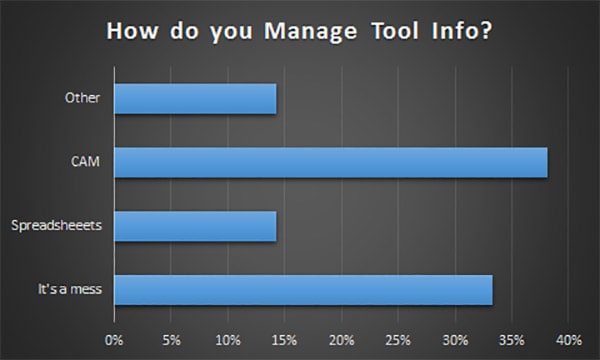

Managing Tool Info
This one is perhaps a little ways afield from Feeds and Speed, but managing tooling data is a task we’re interested in here at CNCCookbook. Coordinating the information between multiple CNC software applications is something we deal with ourselves, so we were curious.
There’s no silver bullet here and the second largest category of responses declared it is simply, “A mess.” The largest number rely on CAM to do the job and then things fall off considerably. Half the remainder use spreadsheets and half use “Other”, which boils down to one of:
- G-Wizard
- Notebooks or whiteboards
- The data is recreated for each job
- We only have 1 or 2 machines so it isn’t an issue
