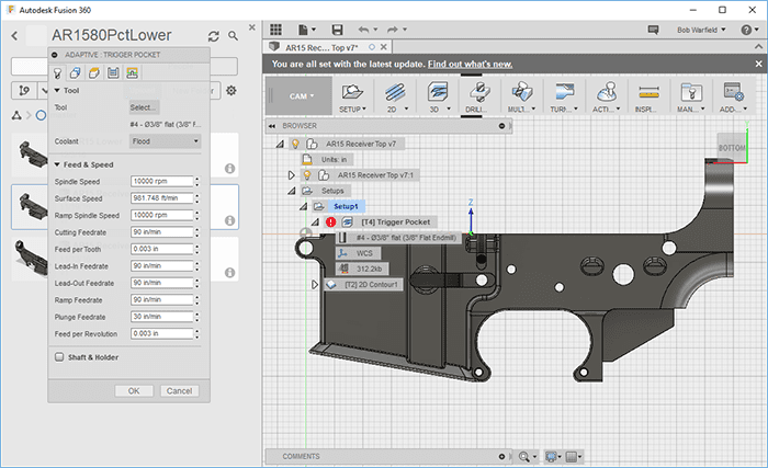

You’re going to set up a cut in Fusion 360 by selecting your Toolpath (for example, Adaptive Clearing) and then giving Fusion 360 all the parameters it needs to create that Toolpath for you.
Here’s an adaptive clearing toolpath I created for an old project when I was finishing some AR-15 lower receivers:
Adaptive Clearing Toolpath for an AR-15 Lower Receiver…
And here’s a closeup of the Feeds and Speeds parameters:
fusion 360 feeds and speeds
Fusion 360 Feeds and Speeds…
Now this box is going to come up with the defaults from the Tool Library.  Ignore them, they’re not very good as we discussed.  Bring up G-Wizard Calculator (or whatever you’re using for your Feeds & Speeds) and use it to figure out what these values should be.

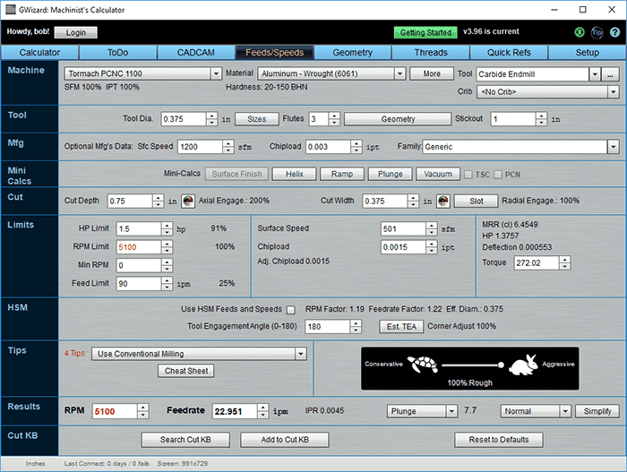

Set up the Cut Parameters in G-Wizard
Select the same Machine, Material, and Tool in G-Wizard.  Then, based on how you set up your Toolpath in Fusion 360, give G-Wizard the same Cut Width and Cut Depth.  Give it a tool stickout that will allow enough clearance in the cut but no more to minimize deflection.
Now you’ve got a result that’s ready to go, such as this:
You need to copy your Feed and Speeds from G-Wizard to Fusion 360…
Cut & Paste into Fusion 360
That gets you a whole bunch of the information Fusion 360 needs, which you can proceed to copy over into F360.  This goes very quickly, because G-Wizard helps you with the task:
See the little message when the mouse cursor hovers over RPM?  Just click that title and it copies the spindle speed onto the clipboard so you can take it and paste into Fusion 360.
Check the little menu on the right that says, “Ramp”.  That’s your Ramp Feedrate.  There’s no reason to use a different Ramp Spindle Speed, though Fusion 360 lets you specify one.  Just use the lower feedrate for the ramp.  I’d also use this feedrate for Lead-In and Lead-out.

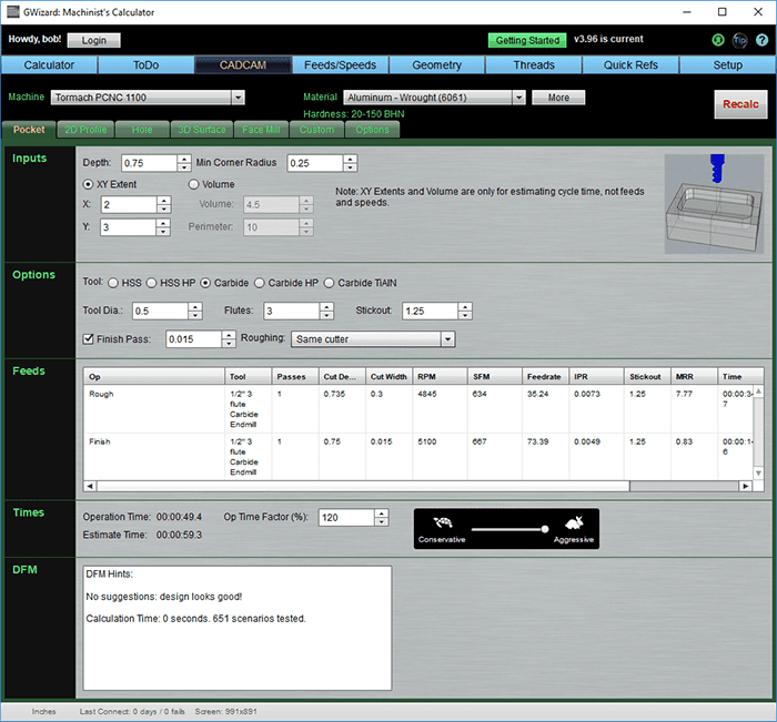

Here’s the CADCAM Wizard for making pockets:
There are actually very few questions you must answer to use CADCAM Wizards:
  1. What machine will you use?
  2. What material is being cut?
  3. What kind of Toolpath (Pocket, 2D Profile, etc.)?
Those three set up the next series of questions:
4. Total depth of the pocket.
5. Minimum Corner Radius in the pocket.
That’s it.  That’s everything G-Wizard needs.  Any further information is strictly optional, should you desire to exercise greater control over the decision-making.  It’s so fast and easy a beginner can understand it and a pro can save time with it.
In exchange for that information, CADCAM Wizards will use some very fancy AI algorithms plus the tried and true G-Wizard Feeds & Speeds engine to find a complete recipe for your cut.  You get both Roughing and Finish passes.  You get tool selection.  You get it to figure out Cut Width and Cut Depth.  Of course you get Feeds and Speeds.
You get time estimates for the whole thing, which are very useful in job quoting.  That’s why CADCAM Wizards are at the heart of our G-Wizard Estimator software for Machine Shop Job Quotation.
You even get something fancy called “DFM”.  That’s an acronym meaning “Design for Manufacturing.”  It’s a slick feature where G-Wizard gives you advice on what you might change to make the part more cheaply.
There’s a lot more here, but you get the idea.  Suddenly, feeds and speeds are much easier.  But it gets better.
In the screen shot, it says, “651 scenarios tested” in the little DFM window to the lower left.  Now when was the last time you considered 651 combinations of feeds and speeds and other variables to make a job run faster?  If you’re like me, probably never.  That’s where the fancy AI algorithms come into play.
Last thing is put your mouse over either the Rough or Finish row and double click.  It copies all that info over to Feeds/Speeds so you can fine tune it, use the click on label trick to get it over to your CAM software, or do whatever you like with it.
