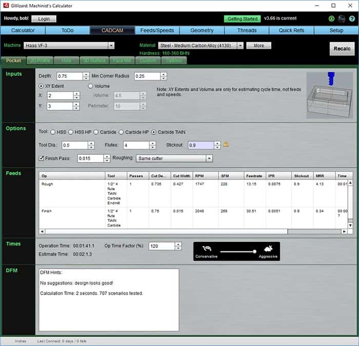

G-Wizard Calculator has a very powerful feature called CADCAM Wizards that make it easy to find optimal combinations of cut parameters. Here is an initial solution to our pocket problem in CADCAM Wizards:
CADCAM Wizards did a little better with 4.13 MRR…

Here’s how I set up our problem:
1. Tell it your machine profile and material. In this case, it just used the same thing that was already set in the Feeds/Speeds tab, so no need to retype.
2. Pick your feature using the tabs. CADCAM Wizards “think” more like your CAM software than a conventional Feeds/Speeds Calculator. We’re doing a pocket, so that’s the feature tab I picked.
3. The inputs change based on the feature. I gave it a pocket depth of 3/4″ and minimum corner radius of 1/4″ (since we knew our 1/2″ endmill works).
The XY Extent, Volume, and Grayed out inputs are for estimating job times. More on that later, but it is handy for quoting jobs quickly.
I told it to use a Carbide TiAlN tool, and since we already knew we were rigidity challenged, I gave it our 0.9″ stickout.
All that was left was to press the “Recalc” button. Just a few seconds later, it had crunched through 707 scenarios and found a slightly more optimal combination of Cut Width and Cut Depth.
Note that it offers a complete cut recipe with both a roughing and finishing pass and all their parameters. That’s a lot of useful information for what little data it required us to enter. CADCAM Wizards make doing your CAM programming a snap!

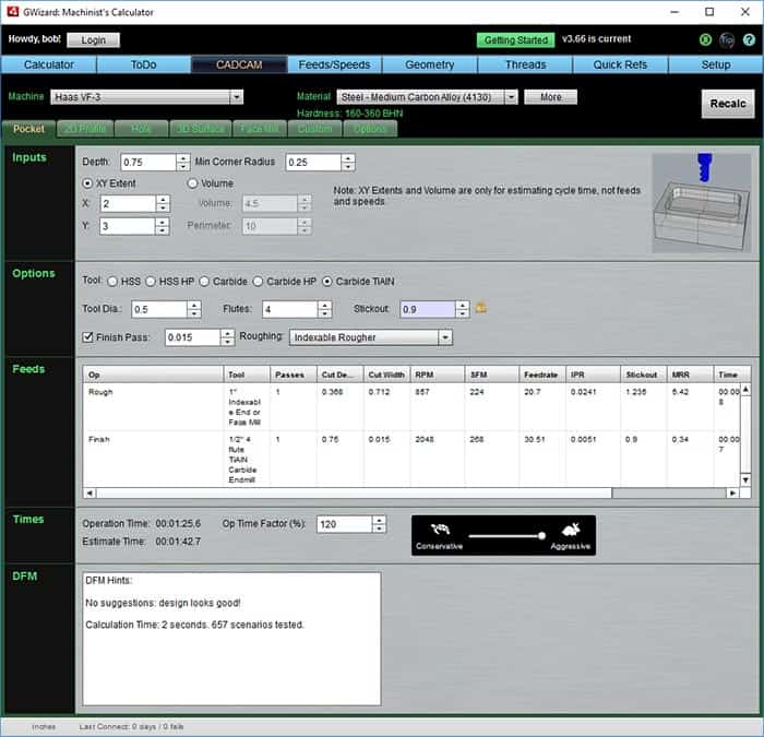

But let’s go to the next step. I talked about using two different sized cutters and rest machining. The “Roughing” dropdown makes trying ideas like that easy. Here is how things look if I choose to use an indexable tool as my rougher:
Using an Indexable Rougher and Rest Machining bumps MRR’s to 5.42…
Using an Indexable Rougher and Rest Machining bumps MRR’s to 5.42.

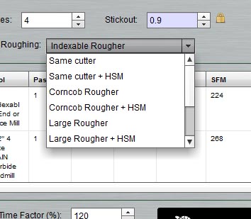

Don’t have Rest Machining in your CAM Package, or don’t want to do a tool change?
Well, you can always fake the package out by feeding it the right geometry. But, failing that, CADCAM Wizards have a lot of roughing strategies to choose from:
CADCAM Wizards have lots of roughing strategies…

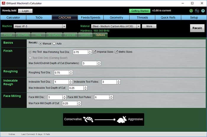

By the way, we tell CADCAM Wizards what our indexable rougher looks like and what endmill sizes are available on the Options Tab for CADCAM Wizards:
Endmill sizes, finish pass, roughing tools, indexable roughers, and face mills are all under the Options Tab…
