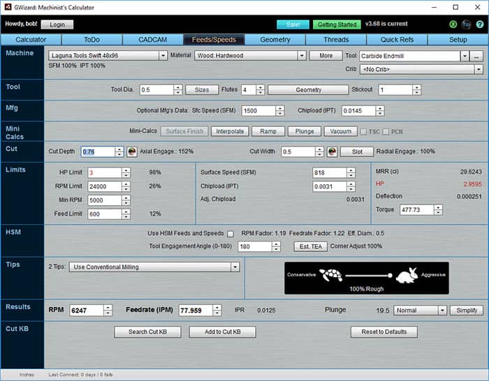

Choose the walnut and the next choice is the tool. You generally want to go left to right, top to bottom when filling out fields in G-Wizard. In this case, let’s choose a generic carbide endmill. Let’s make it a 1/2″ diameter 4 flute endmill with 1″ of stickout (the distance from tool tip to where the cutter goes into the toolholder on your spindle).
Lastly, let’s enter 0.76″ for Cut Depth since we want to cut the plaques out of 3/4″ thick stock. That extra 0.1″ means we’ll cut that far into the spoil board and ensures we cut all the way through the plaques. Here’s what we get:
Here’s our Feeds and Speeds…
Without too much trouble, G-Wizard has come back with our Feeds and Speeds. It wants to run the spindle relatively slowly (6247 rpm) at a feedrate of about 78 inches per minute.
But, there’s one thing amiss–HP is in red and shows a value of 2.9595. Also, we can see the HP Limit (on the left) is red and is showing 3 HP. What’s that all about?
In this case, G-Wizard ran up against the power limit on the spindle of this machine. It has a 3 HP spindle specified. G-Wizard will keep the feeds and speeds within the capabilities and limitations of your CNC Machine to the best of its ability.
You can see what would happen if you had a more powerful spindle. Just type a “5” over the “3” in the HP Limit box. Turns out things were right at the ragged edge and it doesn’t really change the cut much.
See the little padlock that appeared when you typed the “5”? That shows you’ve overridden a value that G-Wizard normally controls during a calculation. Just click the padlock to turn off the override and G-Wizard will go back to being in control.
In general, override as few things as possible to give G-Wizard the best freedom to find good feeds and speeds for you.
