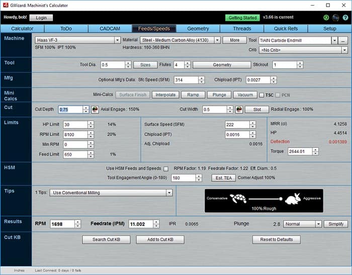

And now here is a first stab at setting up for our pocket without turning on HP TSC coolant:
G-Wizard Machinist's Calculator software tool screenshot.
The basic pocketing cut all set up...
Nothing too special here. I specified taking the cut full depth and with a full diameter of stepover, which is probably not the best though. We'll worry about finding more optimal Cut Width and Cut Depth in the next example. For now, let's keep going with this.
Notice that there is a value in red-"Deflection". When G-Wizard shows red, it wants you to check into what's going on before proceeding. It may be okay to take the cut just as is, but it wants you to think about it first. In this case, the cutting forces are too high and we've got too much tool deflection.
G-Wizard chooses tool deflection limits fairly conservatively. Too much deflection leads to chatter and to premature tool wear. In fact, you can think of deflection as being additive to your runout-it has the same effect on tool life.
There are lots of ways to minimize Tool Deflection. Choking up on the cutter in the toolholder by reducing stickout is one. We've only got 1" of stickout on a 3/4" deep pocket, so I don't want to try that. The other alternatives are to cut the pocket in multiple passes by reducing Cut Depth, or to be less aggressive with Cut Width.
What's the maximum Cut Width (stepover) we can run and keep Tool Deflection under control?
G-Wizard will figure that out easily. Just click the label to the left of the Cut Width value to see the result:
Machining software tools and settings on screen.
Just click the label to the left of the Cut Width value to see the result.
That's a finished cut we can make with a stepover of 0.3579" to keep deflection under control.
