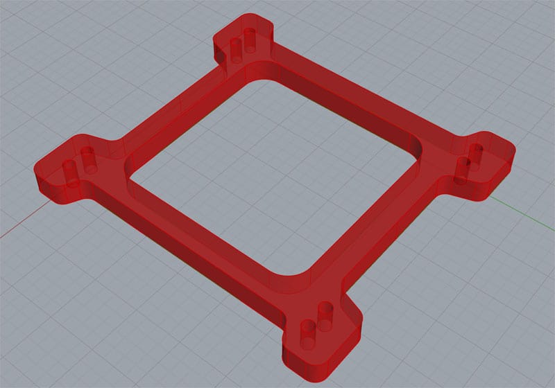

Let’s stick with our example of cutting through 1/2″ plywood on a Shapeoko. And, let’s keep that same part shape:
Cutting outlines like that is what many CAM programs call “2D Profiling.” Another name for the same thing is “2D Contouring”, which is what Fusion 360 calls this operation.

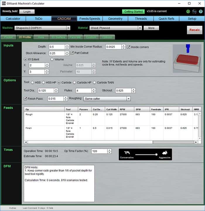

Here is the basic setup for our problem of cutting that shape out of 1/2″ Plywood on a Shapeoko:
Here’s our plywood cutting problem in CADCAM Wizards…
Whoa! That looks a lot different, doesn’t it?
Here’s how I set up the problem.
1. Go left to right, top to bottom, just like with Feeds and Speeds.
2. Select a Machine.
3. Select a Material.
4. Choose an operation from the tabs. In this case, I selected “2D Profile”.
5. Tell it the depth of the profile. We’re cutting 1/2″ Plywood, so the depth is 1/2″.
6. Tell it about inside corners. As in the first example, I am assuming the corners are tight enough to require a 1/8″ endmill, so the radius is half that.
7. Stock allowance is how far from the edge the stock ends. I’m leaving 1/4″.
8. Click “Part Cutout,” because we’re cutting out the parts.
9. Click the “Recalc” at top right.
That’s all we need. The rest of it is for fine tuning and for estimating how long it will take.
That’s pretty simple, right? Other than needing to know the operation type, it’s also very basic information anyone can come up with. The operation types are simple too, and there’s a picture to help you understand what’s meant by each operation.
The “Recalc” button turns red whenever you change anything. Just click it to recalculate everything. What you get is a complete “Cut Recipe”:
– The tool you need is called out.
– Feeds and speeds for both a roughing and finishing pass are listed.
– Cut Depth and Cut Width are automatically optimized.
Note how all of the little problems we had to manually deal with under regular Feeds and Speeds were automatically handled by CADCAM Wizards.
Pretty slick, eh?
See how under the DFM Hints it says it tested 819 scenarios? That means it tried over 800 combinations of variables in the Feeds and Speeds tab and chose the best ones for you.
Who has time to try 800 scenarios? Let the computer do that, it’s what it’s good for!
